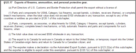

The short answer is that your product is not ITAR controlled, it is actually exempt due to the type of part AND the price.
The long answer is that ITAR has a small parts exemption found in 22 CFR 123.17(A) that essentially states the following:
Canada has $500 single purchase order max, rest of non sanctioned countries have $100 single purchase order max.

Hi,
