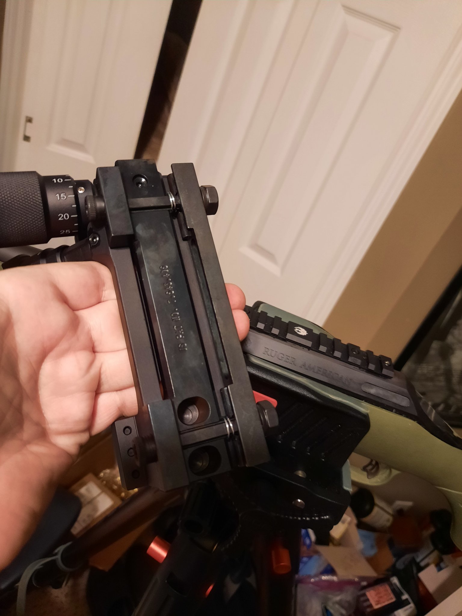

Just ordered an Ivey base, something I've been drooling over for years. Any thoughts opinions/experiences on the Ivey - please share. roast or toast IDC.

I called Ivey this morning and they said they ran about 300 units last year. Perhaps I'm missing something here, but it seems this thing might open a lot of ELR doors for those that have half way decent scope already but just need more elevation.
One last thought - I currently have a 20MOA base on the RAP, should I just leave it on for a total of 220MOA? I think I'll take it of and put the flat base on so the numbers will be easier.

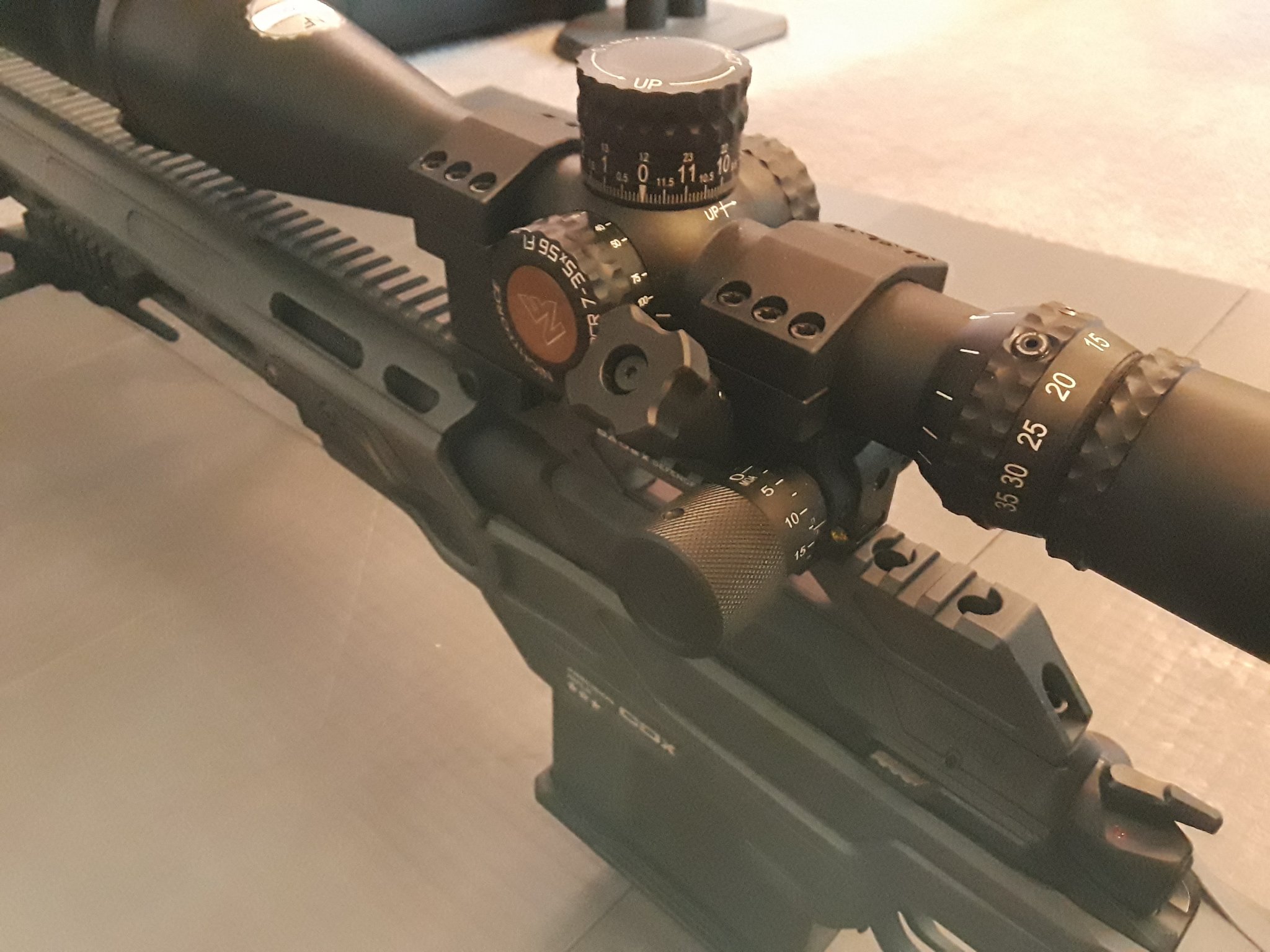

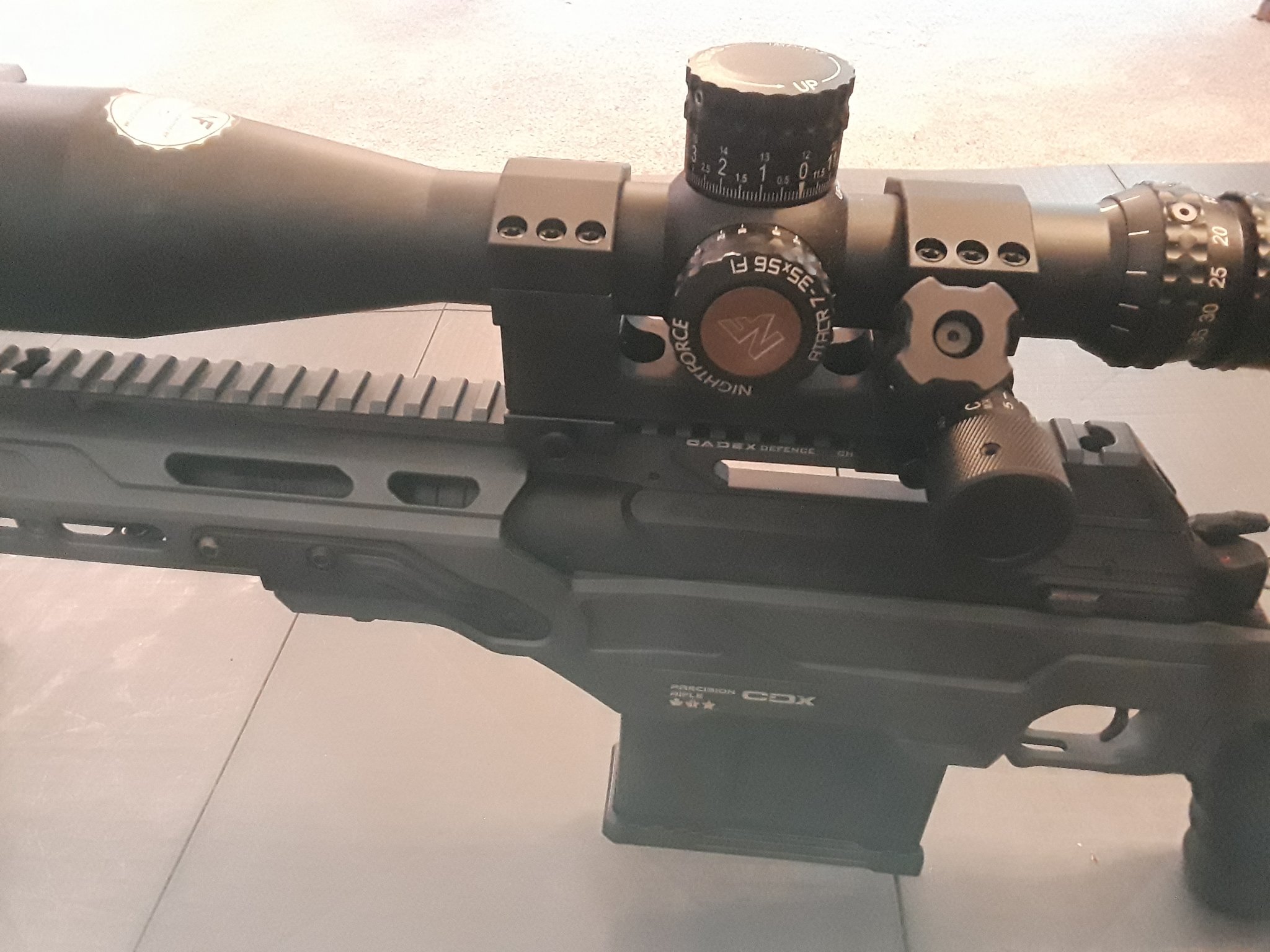

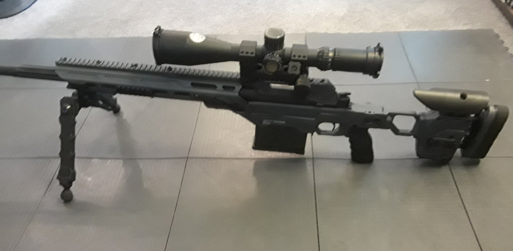

I have an ivey mount on a cadex defense shadow .375 with a NF atacr. I haven't been able to fully stretch it out to it's capability but the mount is great.
Only complaint was that it took 8 weeks to get it when I already had everything else.
You'll be happy with it.

Do you find that the adjustment knob for the Ivey gets in the way of the parallax adjustment on the scope? I was looking at the Ivey for my upcoming 37XC build (waiting on barrel and action), but ultimately decided to go with a March Genesis instead (waiting on that too).
Yes, I get that most people like FFP scopes and I know why, I just like weird shit and different style of thinking. I also like to be told something can't or shouldn't be done and then trying it anyway to see how/why.
For instance - I also have a penchant for fixed power scopes where most people just have to have variable. I shoot an AR-15 from 100 to 1000 yards with no dialing of the fixed scope, just hashes/holds - I know it's not a typical setup, but it works for me.
The knobs are close but once you get used to it, it's not an issue.

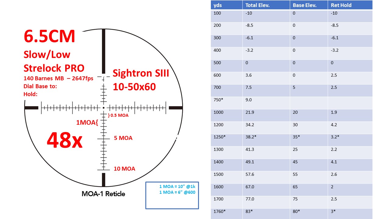

for the scope, at 24x, the hashes are 1MOA and at 48x it is .5MOA here is an example dope/ref card

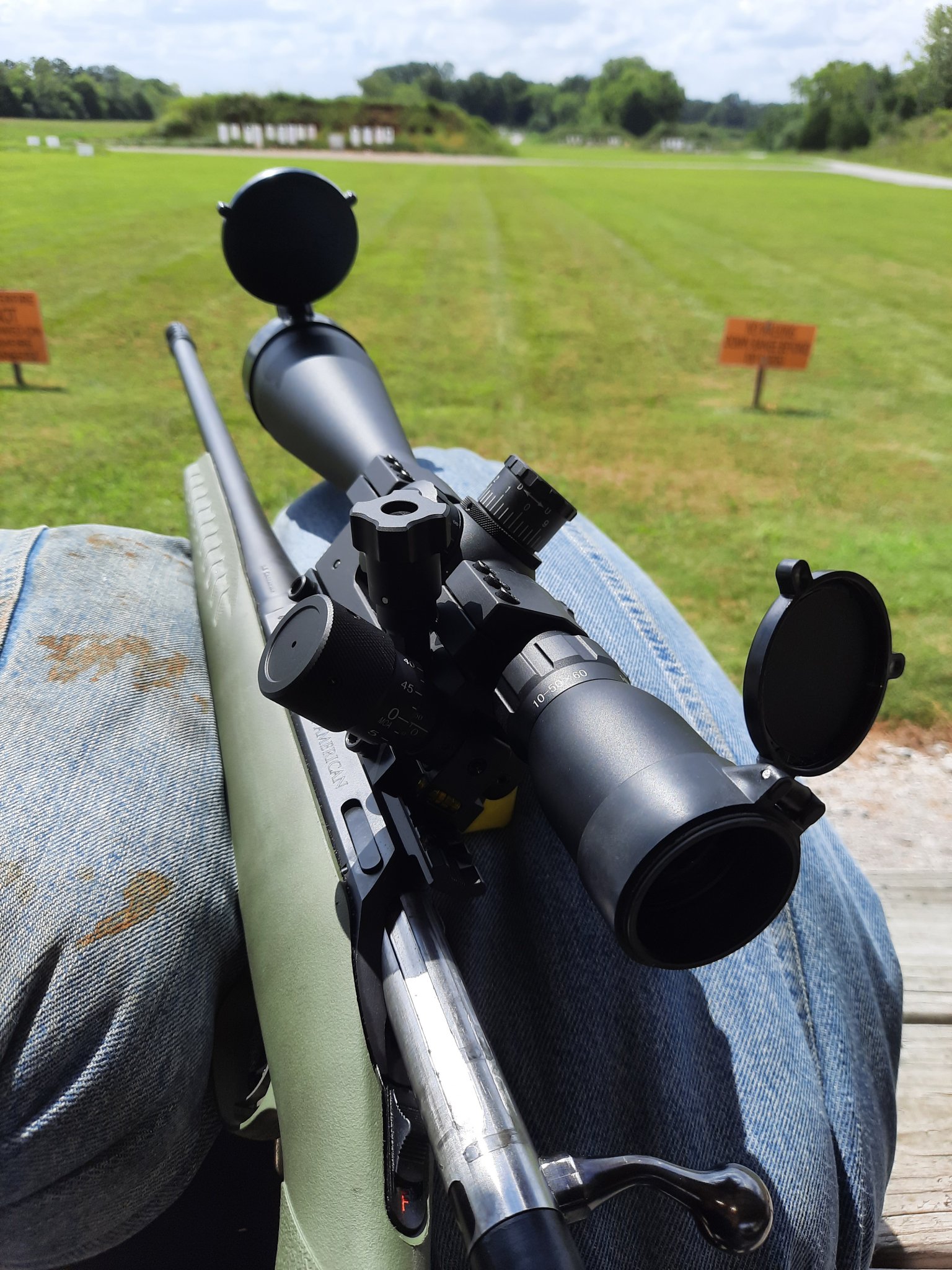

little surprise showed up Friday afternoon. Got it mounted and to the range today! I shot a 600 match with 6ARC, and then tested this bebe out to 1250!
started at zero 100/200, then held reticle elevation out to 300, then used the base elevation adjustments to 45MOA to get to 1250 with my bullet. It actually worked pretty good, save for the height. It is so tall now that I just shoot right handed and sight with my left eye (which is dominant).
After the match everyone left, the wind died and I had the LR pavillion to myself. Scored 4/5 hits on my last 5 bullets (I actually had more ammo, but was limited and no dope past 600 for those). So I was able to see my hits at 1k alright through my scope on 24x, but at 1250 the mirage was so bad that I couldn't see hits, so I listened, nothing... I tried the last few with some elevation adjustments and looking and listening and still nothing. Dejected and alone, I started packing my stuff. the I happened to glance up at the monitor for the 1250 plate and saw the string of hits. HA, what a feeling!
I was able to spot some bullet traces at the match which is another thing I've been trying to get better at. Its been years since I saw one of those. I may have a line on a place to try a mile but my groups will need some tuning. Still I'm pretty impressed with the lack of horiz dispersion on those rounds. At least some of the vertical is due to me making elevation adjustments, so not bad considering things.
