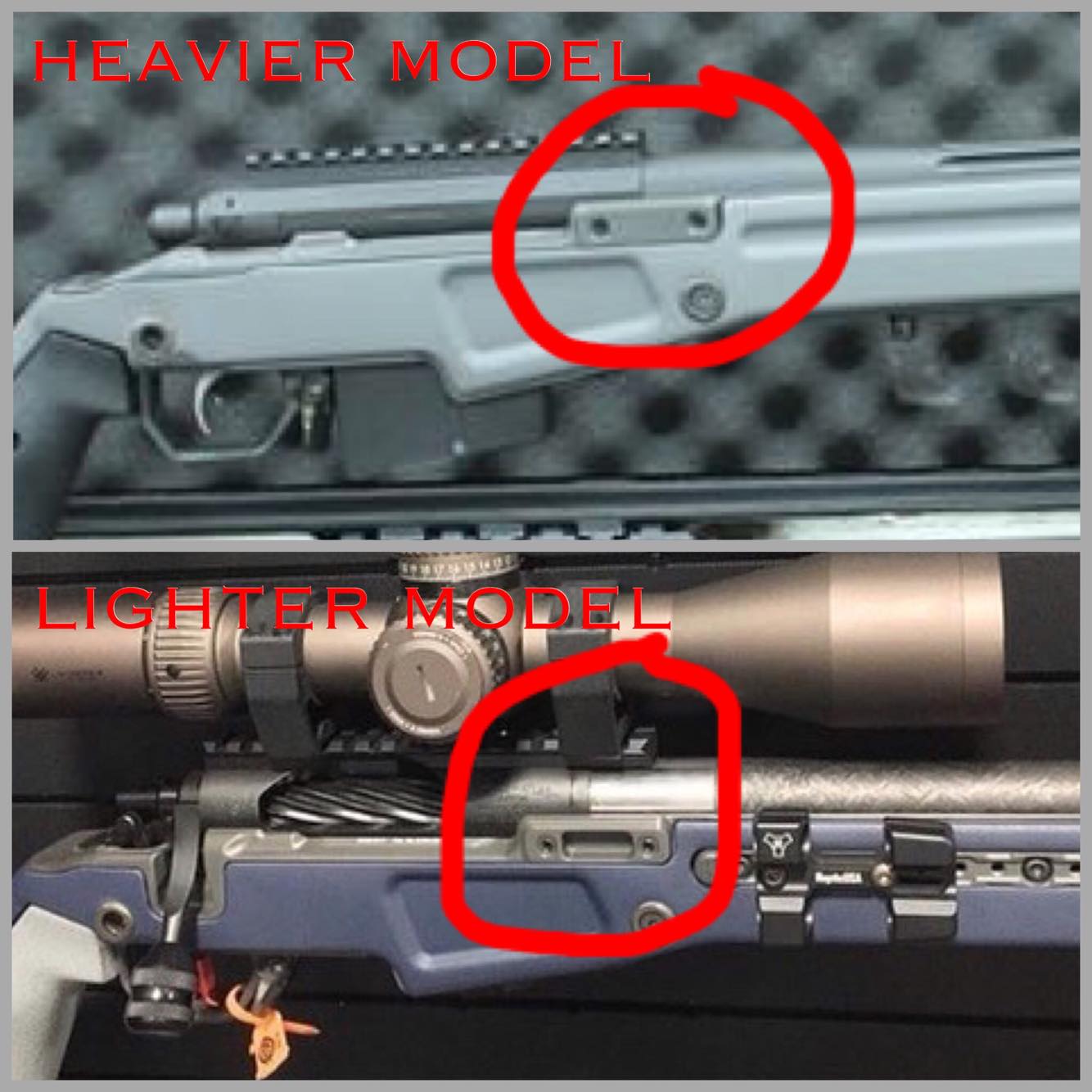

Im looking to buy a JAE 700 SA Chassis. Upon browsing the used market I see that some chassis are listed as the lighter new version. Is the weight the only difference? Is there a way to tell a Gen1 from a Gen2 just by looking at pictures? Thanks for the help guys.

Hey guys. Here's the info I received from Lisa.
It has been a couple years since we took weight out of our chassis (went from about 6.5 lbs to about 5.76 lbs). I will creat a photo comparison and send it to you to show how to tell which version it it.
About a year and a half ago, we changed the design on our front magazine collet. On the top rear of the chassis, it will say 700-B if it has this new collet.
We are continuously making running changes/improvements and in January 2017, we added a rear pad in the back of the new cages for more action support. On the cage, there is a code. It will say something like this: K70S0117. The last 4 digits are the month and year that the cage was made.
Our new accessories that we have released, Arca Rails & Night Vision Mount, and soon Bag Rider, will fit all of the JAE-700 chassis that we have ever made (over last 6 years).
Let me work on the photo of the lighter vs heavier and get it over to you.
Thanks, Lisa

Yep.. that's a good summary from Lisa. They can replace cages if needed. I have the "old" chassis (heavier) but latest rev cage.. replaced last summer. Doesn't affect overall weight.
