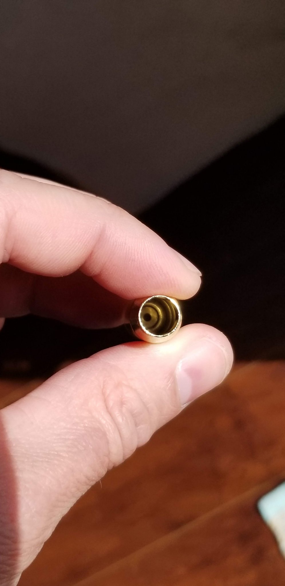

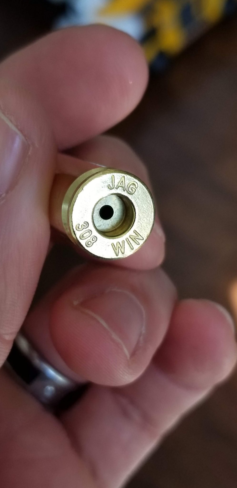

I'm not sure how well this will show up, but here are a couple random cases I pulled from my bag when I first got these a few months back.
