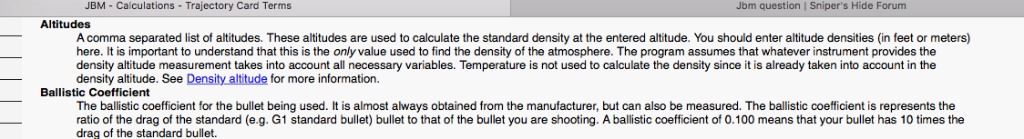

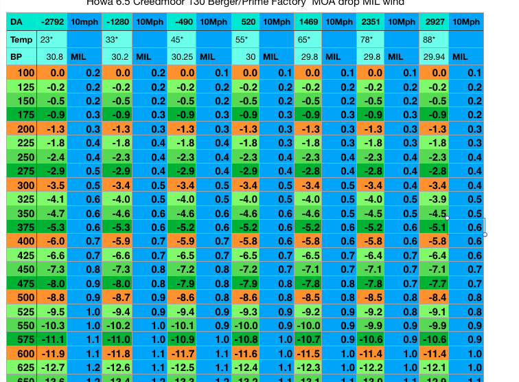

This is the definition that sparked the question. I was just trying to figure out what the best way to build the chart I have been working on. @Jack Master thread on all his various data book pages sparked me getting off my tail and getting a simple single chart built and while I was playing with inputs in and found the difference. I have since went back and checked a bunch of my data and compiled what I feel like is a decent dope chart. Now I just need to get them printed and laminated.
