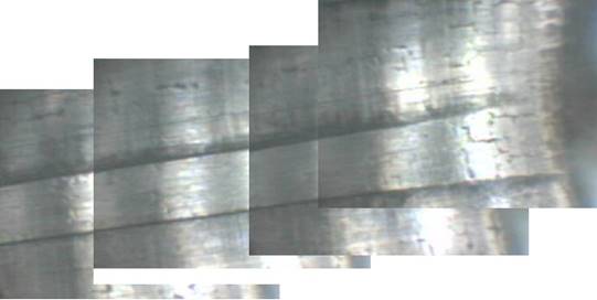

    So I spoke to JP rifles about their test barrels and demo barrels used by their reps to see if they had one that was shot out using the 224 Valkyrie. Initially I asked them if they had a barrel with an excess of 6000 rounds, and the answer was YES. So then I asked if they could cut it in 1/2 so we can see the wear, and they said, NO, it's still shooting sub-MOA (Which was translated to 1/2 MOA with factory Ammo.)
    Understand this is a .224V JP Cryogenic SuperMatch barrel in 416R barrel
    It's important to note that JP does several things to improve the life of the barrel. From Cryogenic stress relieving to using the Heat Sink in order to move damaging heat around. These barrels are designed to last as long as possible.
    For more information on their barrels, check out here.
    Because this cartridge is relatively new, and because of the longer barrel life, valid information is not easy to come by, so taking any guessing on this subject with a grain of salt. We are well past 2000 rounds downrange playing with this cartridge and feel we are just getting started.

    They cherry picked that photo out of several 6,000+ round count .224V sub-moa barrels. Doesn't prove anything. :LOL:
    It wasn't cherry picked you obviously have never owned a JP or talked to the company there barrels shoot I personally have a JP 223 barrel from the ban era that still shots sub moa after shooting competive 3gun for years and have 10xxx other more down it
    Comparing your image to what I have seen with my current Bartlein 6.5 creedmoor... wouldn't it be something if this cartridge went 15,000 plus. My 223 rock creek (long throat) barrel has somewhere around 5k and it has an easily 4-5 times the fire checking, but it has been run hard and heavy.

    It was a jab at the naysayers that claim it won't last 2,000 rounds by pointing out that JP has several barrels with 6,000+ rounds that are ALL still shooting sub-moa. The jab was not that it was cherry picked, the jab was the it has over 3X the barrel life than claimed by the critics.

    Awesome photos! I've got 1500 through mine and will try to keep a log of similar photos. That's a great way to clock barrel life over time. Huge thanks for the post; speaks volumes for both JP and Valkyrie when barrels are done right!

    Did they say how far the lands eroded from new over 6000rds? How far they are jumping now vs new?

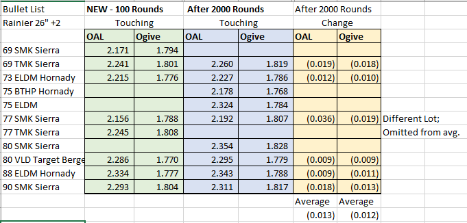

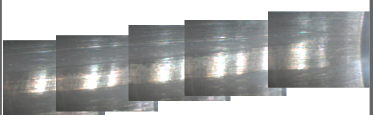

    I decided to try the same thing as JP on my Rainier UM barrel. I have a lesser quality bore scope (Lyman) but also have basic OAL and Ogive measurements from new barrel through 2,000 rounds that have been fired.
    Here is data on throat wear; basically averaging .012" from new but it varies by bullet shape. VLD/secant profile bullets changed the least and tangent ogives changed the most. Berger's have smallest change; 69 SMK and 90 SMK have the largest change. The 77SMKs are from a different lot so I can't say whether its large due to lot to lot variation or actual shape/wear.
    Throat:

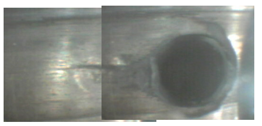

    Gas port after 2k rounds (1,000ish suppressed):
    It is 200+ rounds dirty in this photo and has some copper and carbon from last session, but the photos make it look more severe than it is on the screen. It's traces but the color/quality of the images doesn't do it much help. Virtually Zero heat checking or cracking anywhere in the throat.
