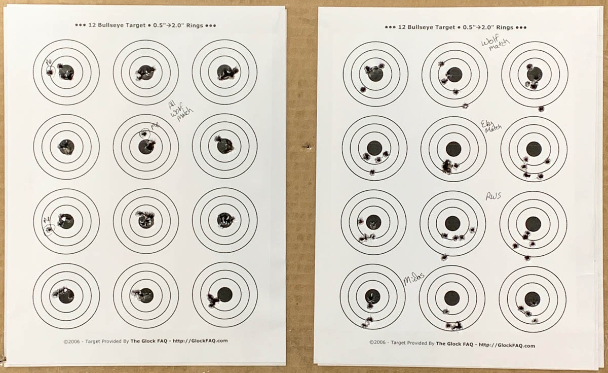

I just realized I never put any group pics in. Still need to get ahold of JP next week.
To be fair to both rifle's groups this day had some 10-12 mph tunneling breeze, and the range i shoot at uses a conveyor belt like material for target mounting so they swing a bit in the breeze, I'd say this day to about the first outer ring or about 1" so timing shots with the wind gods was critical. Volquartsen on the left (wasn't even tossing the first round into the dirt) and JP on the right. All 5 round groups. Ones circled on the left target were my fault where the gun had more movement than normal under recoil/follow through.
The one good group with the JP is odd, but I've seen it 3-4 times now where all the stars will align and it would stack 5 in a row across different ammo. However I can have a shot with the JP feel great, normal reticle movement in follow through, shots feel identical, one will be in the center and the other will be 1.5-2" out. I also noticed shooting at 100 with the JP, it looked like a couple of them might have been starting to tumble, they didn't look like clean holes. Groups at 100 were in the 4-5" range, but I only tried Eley Match at that range as I had a few left over.
