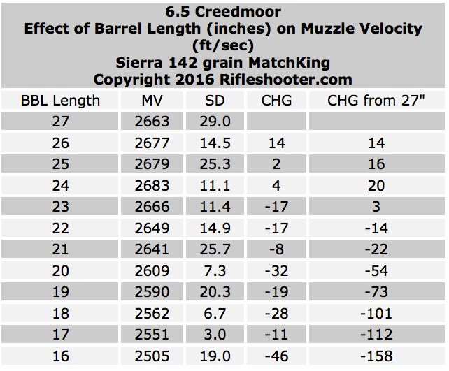

    Because the difference in MV between 24"-22" so minimal it is irrelevant.
    wow very interesting including the table. i thought the rule of thumb was a gain of 25-50fps per add'l inch. and the table shows fps decreasing (not just a slower gain) above 24". would appreciate hearing the theory behind this, not that i'd understand it.
    Davsco...here you go, there is some good data in this article.
    http://www.chuckhawks.com/rifle_barrel.htm
