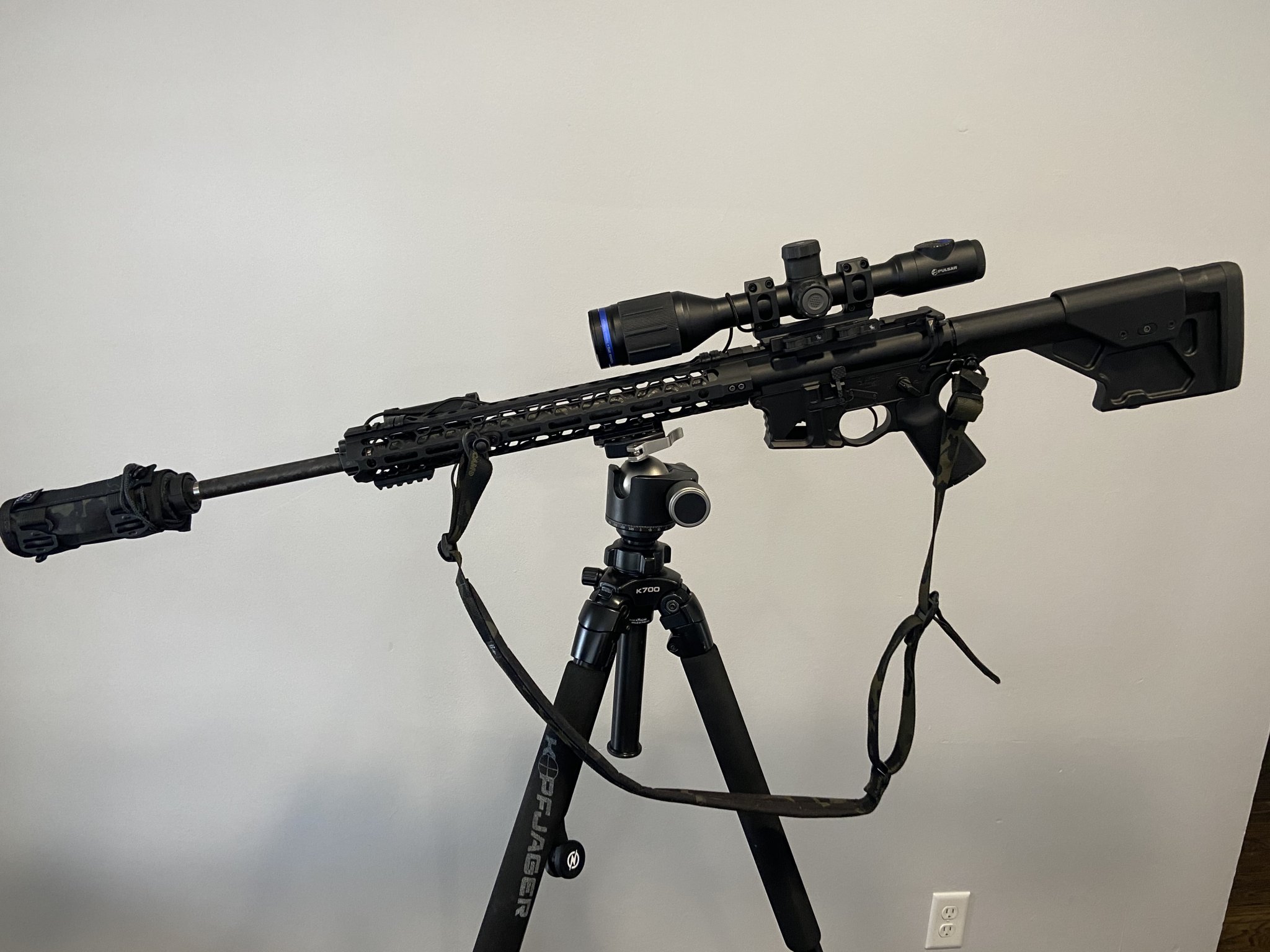

All,
I could use your input. Close shooting buddy of mine runs the JP Enterprises captured spring buffer on a few of his gas guns (223 and 6.5 creedmoor, might have it in a 300 blk too, but not sure) with a standard BCG, not the JP BCG. I was skeptical of this system until i shot it. The spring bind and twang were gone from the traditional buffer system and the rifle seemed to shoot much smoother in the 223 setup of his that i shot. Follow up shots and/or reengaging targets also seemed to be smoother and faster (admittedly, i did not have a timer, just going by gut feeling on this aspect).
I only have a limited amount of experience with this system (few hundred rounds), so im looking for more real world data and im curious if any of you guys have run it, or do run it. Do you like it? Hate it? Give me the good bad and the ugly. Im thinking about putting this on one of my 223's and possibly my 6.5 creedmoors, but really would like more feedback before making the plunge, units certainly arent cheap for a buffer system.
Thanks for your time!

Do any of his guns match your set up? was his a carbine, mid length or rifle?
what is your gas port size?
what muzzle device are you running?
What buffer setup is currently installed?
They do reduce that twang sound, but it might not change your rifle like you are hopping.

S197,
Good questions. I'll tell you what i know for sure.
Im going to run a JP SCS in my AR pistol (Its a weird configuration to meet laws in CT - feel free to ask about specifics if that would help in some way) first to learn the system a bit more (I know this isnt ideal, however, if something bad happens, id rather learn about it on a cheap AR pistol than one of my Creedmoors), and then in a "test rifle" i have that is similar to his, and experiment a bit.
I bought the "H2 heavy builder kit" to start with and an additional steel and tungsten weight so i have some adjustibility, if needed. Regarding felt changes - his rifle was significantly smoother. The spring twang was gone, but its not the end of the world for me if its still somewhat present. However, with the JP SCS the mechanics of the rifle under cycling of a round both shooting and by running the BCG with the charging handle was very linear and smooth; follow up shots for me were noticeably faster, reacquiring targets was also faster. The sensation of "coil bind" (buffer spring compressing in the tube was also gone, obviously (liked this a lot). There are four rifles that i want to put this in - 12.5" 223 pistol. 16" and 20" 6.5 creedmoors, and 10.5" 300 Blk out SBR - im going to go slow with this process, this is a very new system to me, and i dont want to screw anything up, or damage my rifles in some way.
To answer your questions...
1. Somewhat (I know this isnt ideal for trying to match a feel). He has a JP SCS in his 308 w/ 16" barrel. I can get specifics this weekend about gas system etc.

I have one in my precision Valkyrie AR, running it with a Superlative gas block behind a TBAC Ultra 7. Pleasure to shoot.
