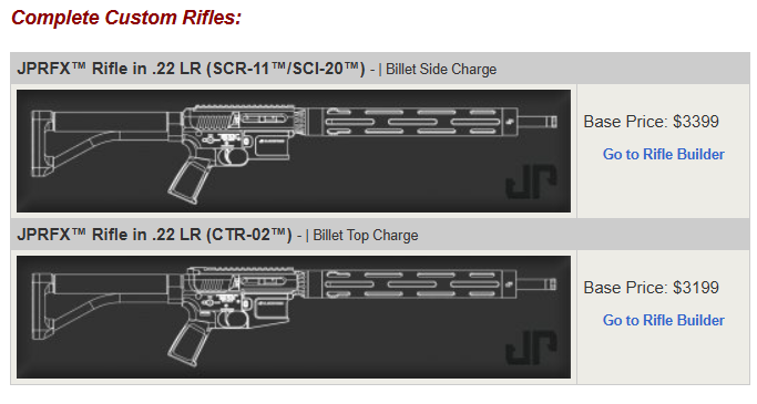

JPRFX™ Rifle in .22 LR (SCR-11™/SCI-20™) - | Billet Side Charge
Base Price: $2899
Go to Rifle Builder
JPRFX™ Rifle in .22 LR (CTR-02™) - | Billet Top Charge
Base Price: $2699
Go to Rifle Builder
"If you have to ask, you can't afford one." Well, out of my price range. :oops:

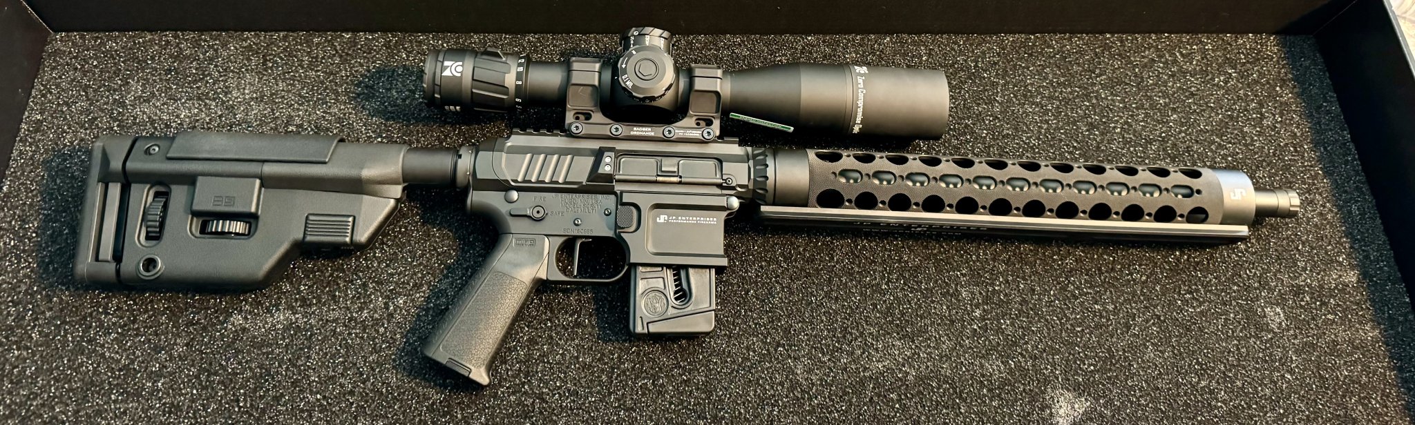

Time to revive this thread. Picked mine up yesterday. JP mentioned doing this a few years back. I called every six months or so to check on it. Every time they said nope , no plans for that. I was going to build it on the website but went with a dealer who had one in stock. PRS lite in back, side charger, 15.5 in forearm with ARCA rail, compensator on the barrel. Some sort of trigger upgrade. Advertised at 3.5 to 4lbs. I haven't checked it yet. I tried a Calvin Elite in it but it didn't want to engage the safety. Trigger is fine, I'm just not used to that heavy. Put a Ziess S3 4-25 on it. It weights in at 12 lbs. Shipped with the M&P mag. LOP with the PRS lite is 13.75. I need some kind of AR style mount to get the scope up and away from by face, and add some MOA. Balance isn't great- got a weighted rail coming.

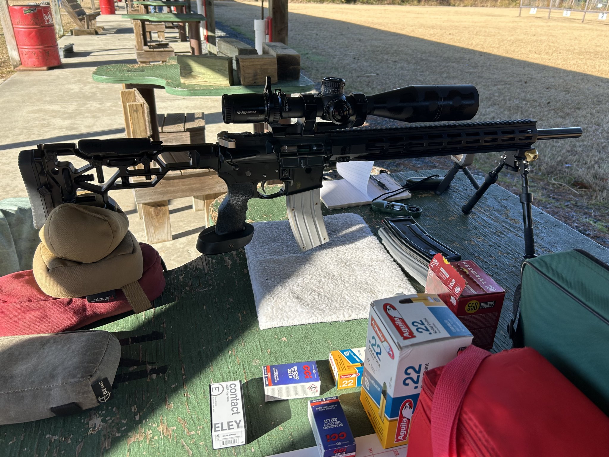

Range report. Got it out to the range today regardless of the 11gust 23 winds, average 17. MY Garmin Chrono kept generating a shot with an MV between 200-400FPS- I guess due to the wind.
Started of with SK plus - SD 25 mv 988 ( shoots 1080 out of my bolt guns). SK Rifle match SD 28.6 MV 981, Eley target- SD 13.1 MV 1048
( shoots SD 6 MV 1080 out of my Duece).
Moved to the recommended Eley benchrest Outlaw and benchrest. Outlaw SD 17, MV 1067 over 40 rounds. Tried 6 lots of Benchrest- best was SD 6.5 MV 1070 over 40 rounds. (the other lots shot SD's of 9.9, 7.6,10.4,12.3,9.6. and the groups were not as good)
Shot 5 , 5 shot groups into that wind at 50 yds . . Results for the best lot were .326", .360",.377",.638", 1.14". Went home and ordered a bunch of that. So magazine wise- The M&P is horrible to insert but always locks back. The Kriss inserts really quickly and seem to lock back intermittently ( need to check more). I bought some 10 and 15 rounders of those. Big mistake. It's the same form factor one holds 15 one holds ten.
Zero malfunctions through several hundred rounds.

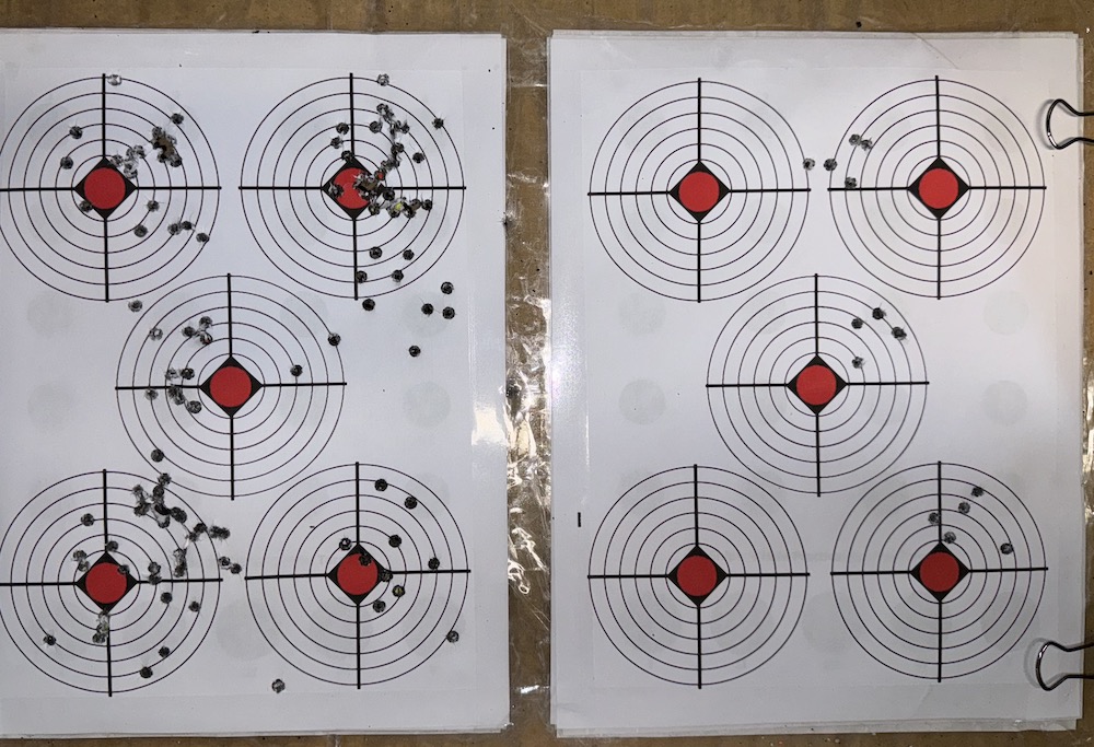

The old version was massively sensitive to ammo for accuracy (reliability was 100%). I've probably tested a couple hundred lots across various brands in my old one, and found maybe 2 that shot really well, the others on average are 3-4" at 100. It's far and away the most ammo picky gun I've ever owned, it's not even close. One lot of Tac 22, and one Lot of SK LR I've found shot really well out of it to 100, somewhere in the 1-1.5 MOA range, but everything else dozens of tests over the last few years, 3-4" is common at 100 or worse, it just throws huge flyers, even at 50yds. JP built this barreled upper as well. To be fair even JP admitted in email it was never designed for accuracy it was designed as an AR trainer. That said, I think anyone buying a $550-$750 rimfire barrel called "Supermatch" likely expects accuracy to exist. :unsure:
This is a good example target from yesterday at the range. 100yds, 5-10 mph winds L-R, the groups on the left target are CCI STD, SK Pistol, SK Rifle, Wolf, and Eley Match. I often use the JP to shoot up partial boxes, or straggler lot boxes. The three 5rd groups on the right, are one of the "unicorn" lots that it likes, a lot of SK LR, the largest of which is 1.25". I find if frustrating when a gun performs this poorly, so if I take the JP 22 I know to bring a couple boxes of the "unicorn" ammo to at least get some good groups in at the end of the day. I must have been asking for punishment yesterday cause I also took my MCX out, which I doubt could hit a dinner plate at 200yds with any ammo, yet SIG says meets their 3rd 4MOA std......that they evidently test at 25yds. :rolleyes:
I've tested probably at least. a dozen lots of SK LR, and the others end up looking like the target on the left. No idea what drives it, my only wild guess is that the gun is ridiculously picky on pressure/velocity to feed without damaging the bullets or bolt bouncing perhaps. If it was bolt bounce though you'd think softer loads would do better. I can't think of any other reason to see that much accuracy variation from lot to lot of the same ammo and it being this hard to find a lot/brand it likes. I see lot to lot variations in my CZ 457 or Volquartsen/10/22s, but it's much much smaller, once and awhile you get a horrible lot, but most lots of the better ammo shoot pretty similar. Also the lot based flyers are usually velocity related so you still get pretty good L/R groups just vertical flyers, but the JP tosses flyers everywhere. It's also not that this "unicorn" lot is just amazing in general cause it's just middle of the pack in my 457 for SK LR lots I've tested. In the past I've thought about trying different recoil spring rates to see if it impacted things, but honestly I just find the gun frustrating to shoot.
The new JP might be amazing, but they'd really have to prove it to me first that it's not crazy ammo picky, and it lives up to the marketing, esp. since it appears to use the same action/bolt setup. That said I do think their fully built rifles seem to delivery better accuracy on average than just buying their barrels and doing an assembly. I've had several supermatch JP barrels built up and while they were all good, none of them were outstanding when compared to offerings like Bartlien/Krieger etc. but they are not far off in price.

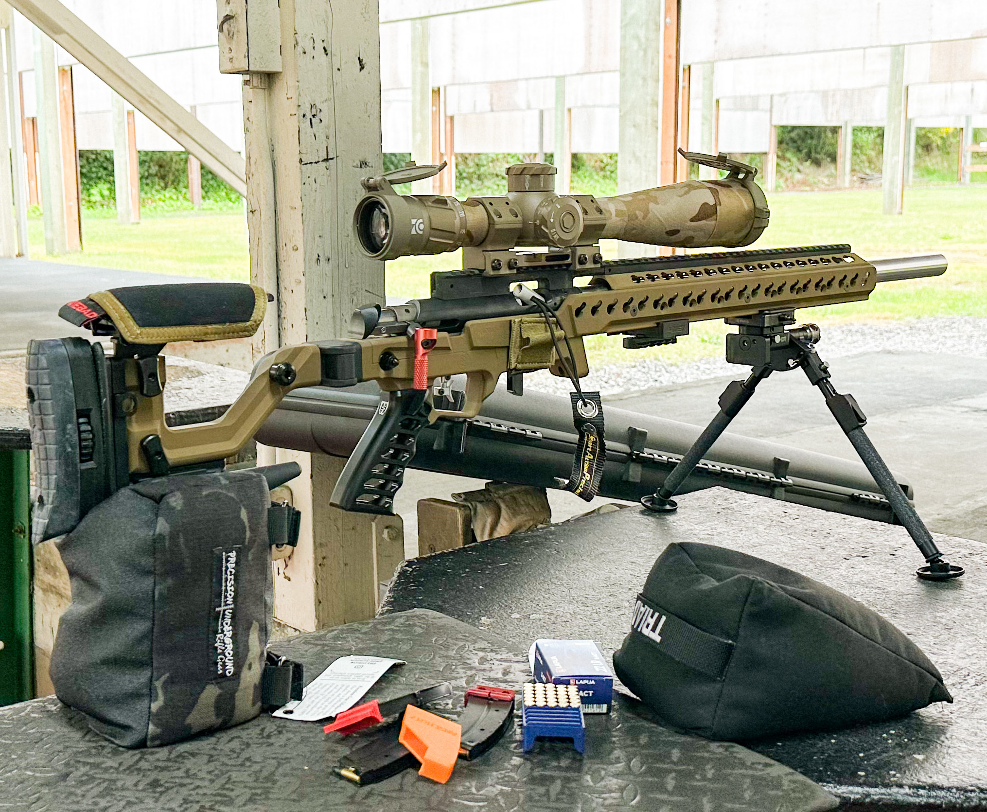

Shot mine at it's first match yesterday. Got the weighted ARCA rail- not perfectly balanced but close enough. 14 lbs even. Couple things I learning beforehand. After about 130 rounds or so it randomly stops going in battery. The cartridge is sticking out of the chamber about a 16th of an inch. The good news is it would not fire out of battery. But, i would drop the mag, run the bolt , put the mag in and fire. First I thought it might be a mag issue. It wasn't So I do a quick clean- after 100 rounds. That fixed it. The bolt face is really dirty after 100 rounds. Brush the bolt face and chamber, blast of air in the trigger group, and I'm good. Also the side charger is prone to slowing down if not clean. Haven't decided if I will run it wet or dry. It's pretty dusty where I shoot. The only malfunctions in the match were me not knowing how to run a semi auto. Spent what seemed like an eternity figuring out I hadn't charged the rifle one time. Spent time looking for the safety since my finger couldn't seem to find it. Accuracy was good. Missed that small kyl on the NRL stage 2 out of 3- but it was a bit breezy. I didn't miss anything because the gun wasn't accurate enough. I was definitely faster which was my main goal, I'm the guy that always times out. With practice I'll do better overall than with my bolt guns.image.jpg

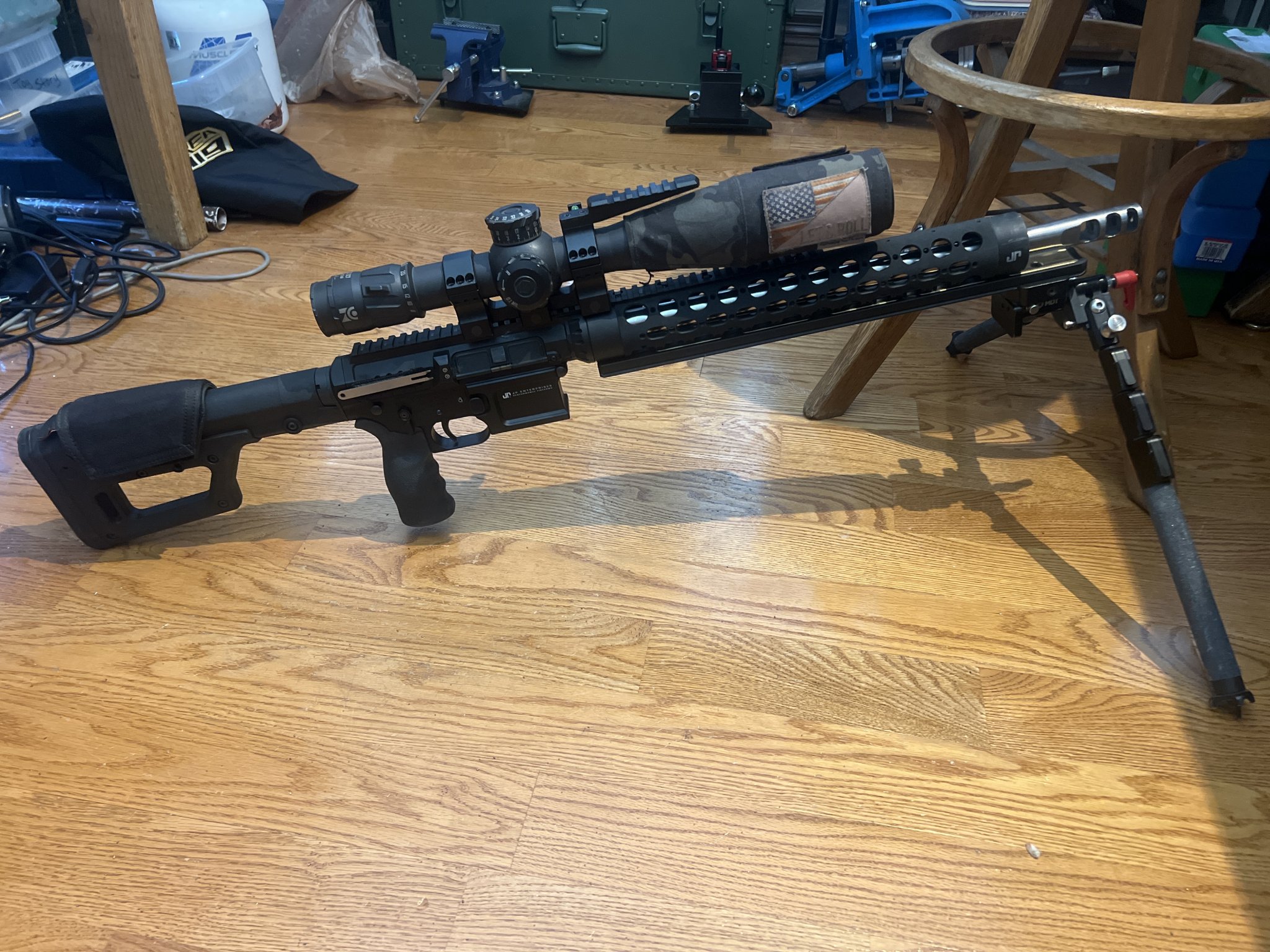

I have the 18" barrel + BCG kit they sell in an Aero M4 Enhanced upper. The best ammo I have found is Eley Contact 42gr. It beats all of the higher cost Eley and Lapua ammo in my rifle. It's consistently 1-1.5 MOA at 100 yards. Eley Force 42gr. is also consistent, but slightly larger groups. Some lots of Team/Match perform well, but not as consistently as Contact. Both Contact and Force were more consistent than Semi-Auto Benchrest Outlaw as well.
Still not great compared to even budget bolt guns though. The performance of these this was disappointing.
