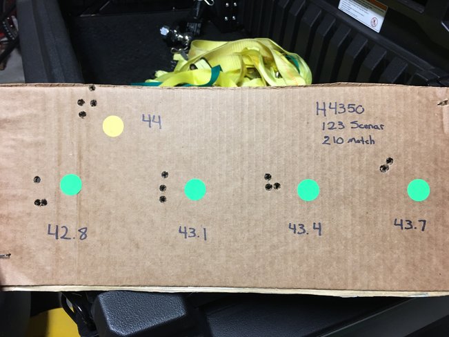

I finally thought I had settled on a load and had this LRP-07 in 6.5 Creedmoor figured out. Get to the range and for the life of me, I can't figure this darn thing out? Obviously it's the Indian and not the arrow. I wouldn't consider myself a great shot, but I have fired numerous tiny little groups with various bolt actions. Has anyone struggled like this and finally had a light go off they would like to share? My load is 43.2 H4350 and the 123 Scenar. I love the rifle, but I am very close to moving on from this thing. Attached, is an example of what I was seeing today.

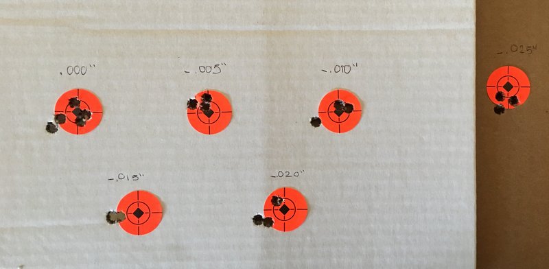

Thanks for the replies. I have tried various seating depths, but mostly mag length. I did get a LaRue mag that would allow me to seat them as long as needed. Most of my ejections have been coming in the 2-3 o'clock range. At that charge I am averaging 2820 at 1025ft elevation. I have shot 130 Prime ammo with decent results. I went ahead and ordered a couple of boxes of Hornady 140ELD to see how those would fare.

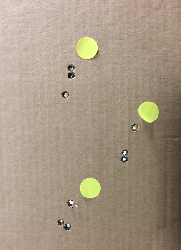

The picture below is 43.4 H4350 with 123 Scenar. I just thought it was odd the POI was shifting around as it was, so I went down in charge. I might need to re-visit this load or go down even more to a lower node. I am also including my OCW that I had in a previous thread.
