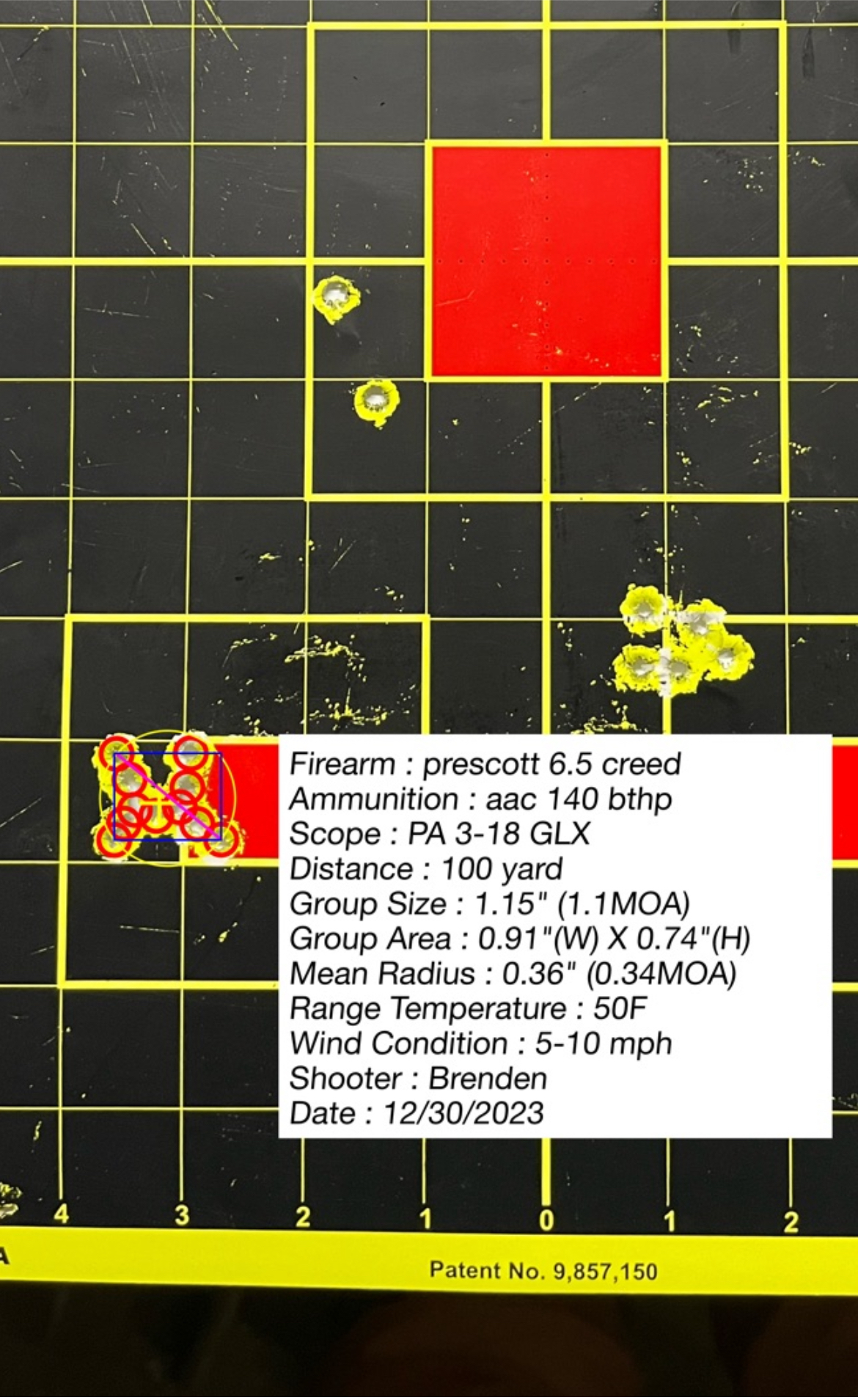

Dang, that’s very unfortunate, I’ve had great luck and accuracy with mine. I’m just waiting for the snow to melt a bit so I can complete my review, still need to accuracy test a few more loads.
I’d seriously ask them to look at the barrel as well. Mine is consistently a sub moa shooter with 130-140 match grade ammo and the AAC 140 bthp and smks. Here’s an example of what I have gotten with AAC 140’s 11 shot group at 100

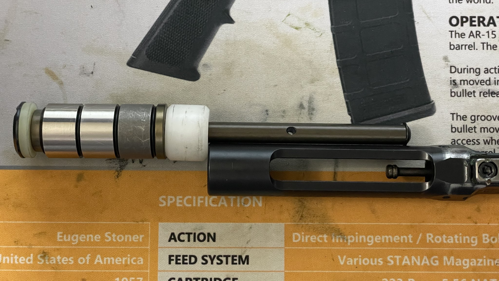

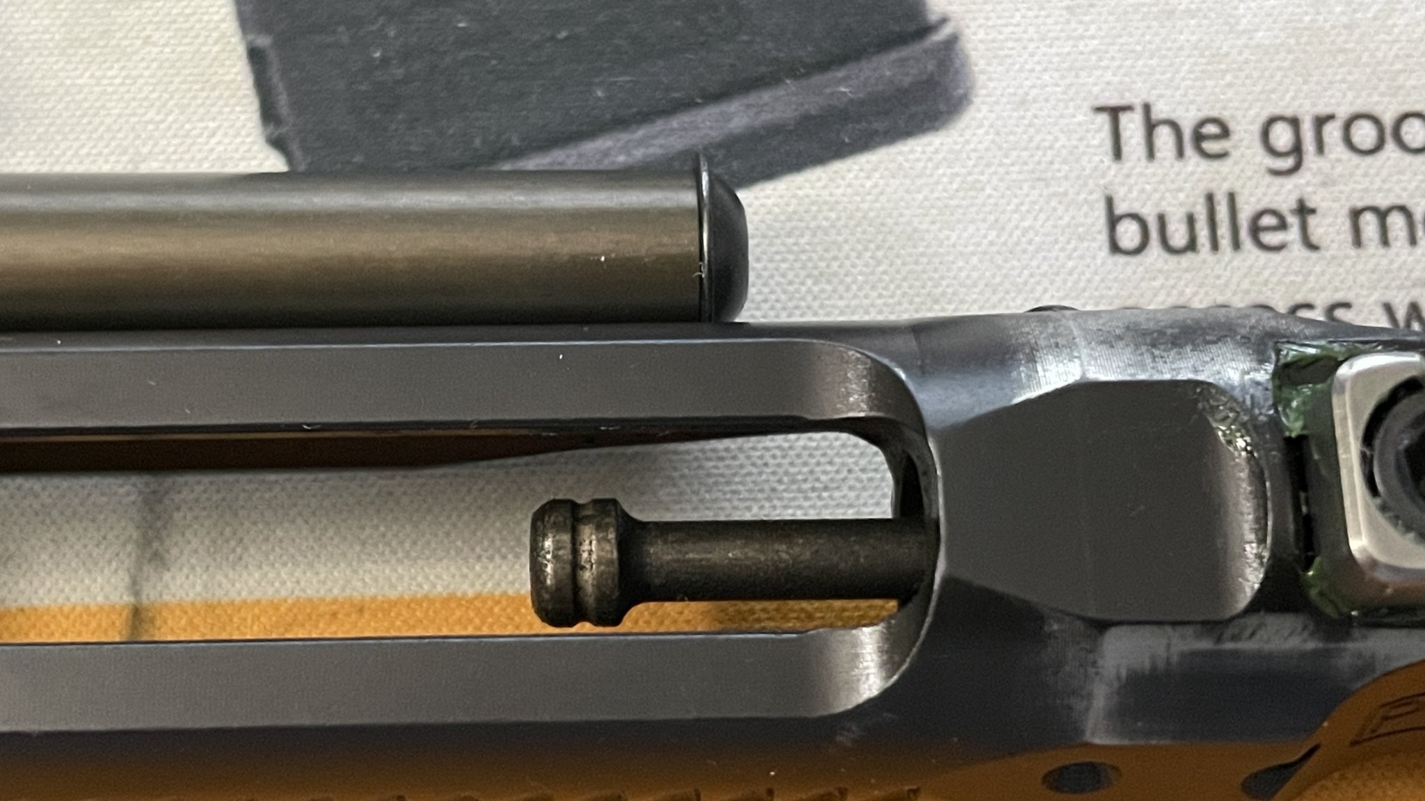

Here's two photos of the JP SCS, spring removed with the weight at the bottom of the system like it's fully compressed, showing the overlap between the JP rod and firing pin. This is with the bolt rotated back so that's the furthest the back of the firing pin can extend theoretically.
We're looking at an overlap of slightly less than half an inch with the bolt rotated back and less with it moved forward, (.360"). By cutting down the spacer to remove any preload, the amount of overlap grows. Even if you went with a VLTOR A5 buffer tube which is .5" longer, you'd be cutting it pretty close assuming the JP mass bottoms out and the bolt moves all the way to the back.
Maybe the bolt doesn't move all the way back, I can't say. I'd think if you had a hot load and too much gas, it could happen pretty easily. The nylon spacer doesn't give me a lot of comfort as I'm sure it'll compress over time and could get chewed up as well.
Seems to me, for reliability, the entire system would need to be redesigned and the metal portion that would normally sit against the back of the carrier would need to be lengthened the appropriate amount, the rod slightly shortened and the weights adjusted to compensate for the increased mass of the extended metal face. At the very least, with the A5 carrier, you could use a 1.25" spacer at the front and it would work. I know aluminum will compress, maybe a titanium spacer? I have an extra tungsten and steel weight so I might be able to compensate.
