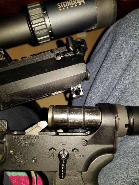

Here it is. Apologies, still needs a cleaning.
