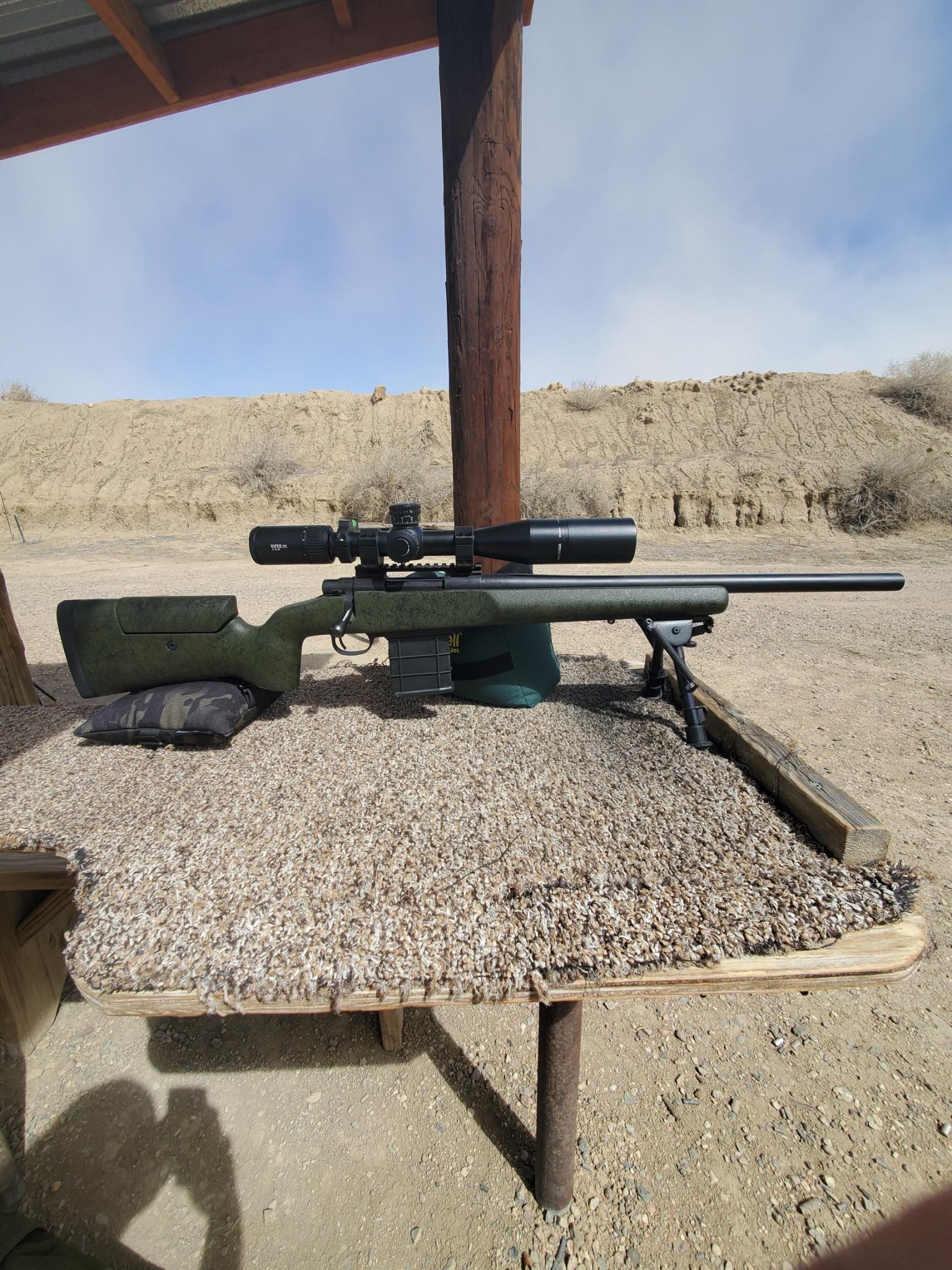

    Hello guys,
    As you know I joined this forum a few months ago. With zero long-range experience. My first time out with my Howa I couldn't get better than a 4 MOA group at 100 yards. You guys were super helpful in sending me videos, and advice on how to become a better shooter. My money hasn't been where it needs to be to take a professional class yet but one day. So first and foremost I want to thank you all. From the compassion, you have for what you do, to the shit-talking when I posted on accident on a wrong subject in the bear pit. I contribute my getting better at shooting to this point largely to all of you.
    Now onto the fun stuff. I purchased quite a few boxes of .308/7.62 to see what performed best in my rifle. At the advice given here. Keep in mind I've only got about 300ish rounds down this weapon actually any bolt gun ever thats including what I post here. So this weapon could perform I'm guessing way better with someone more experienced in the field. The only issue I had after about 20 rounds was I had to force the bolt open it slid back smoothly, chambered the next round, and extracted lives perfectly. Fired brass once the firearm got hot I had to slap the shit out of the charging handle to get it to open. No matter which ammo I was using it will be posted. I will give it a good cleaning later and see if that helps.
    Build

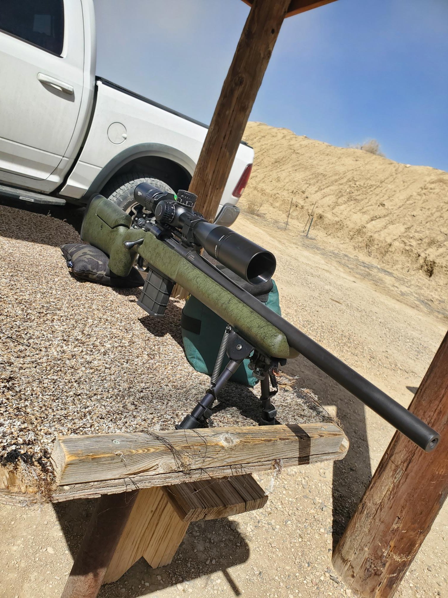

    Howa 1500 .308 20 bull barrel (all factory) purchased on consignment for 400 bucks
    Bell and Carlson stock
    Nightforce 0 moa rail
    Vortex PST Gen 2 3-15x44 in vortex rings
    Harris Bipod

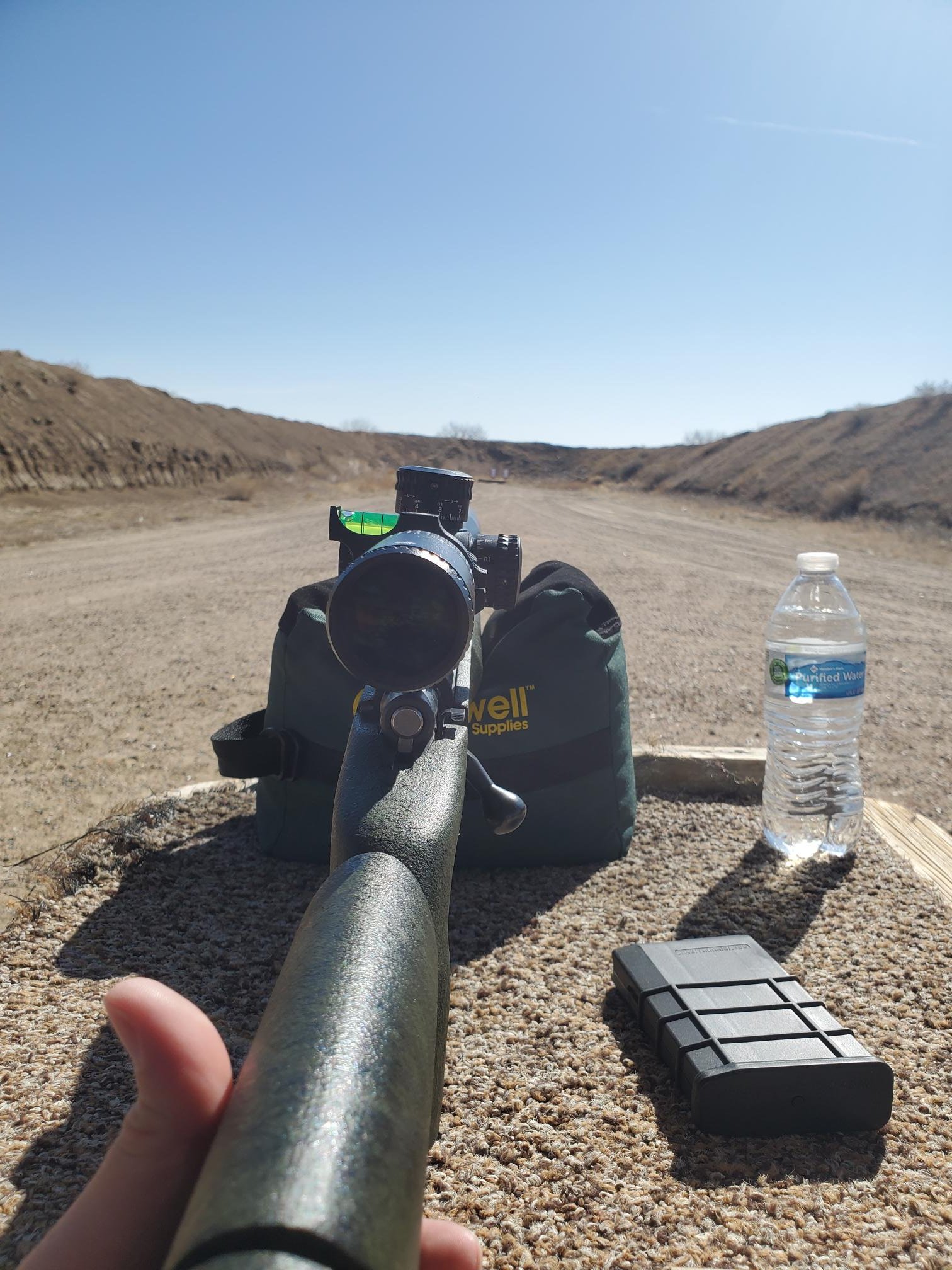

    Was fired off of the Caldwell front bag, and a precision underground rear bag. Bipod looked cooler for the pictures though.

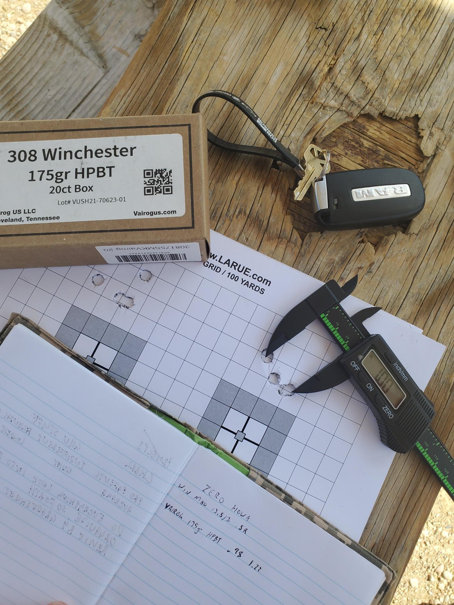

    The Ammo Tested from bottom to top cheapest to most expensive

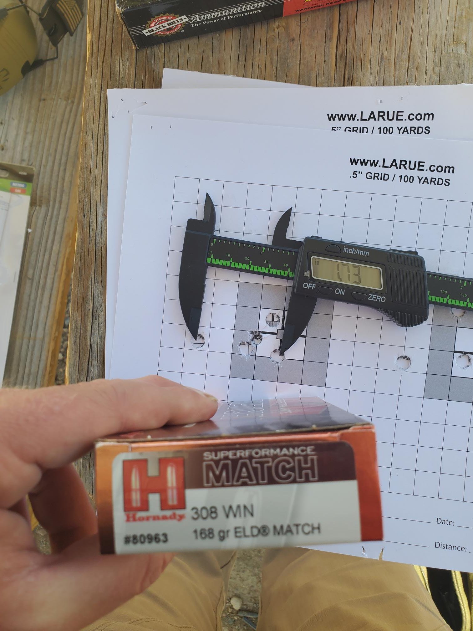

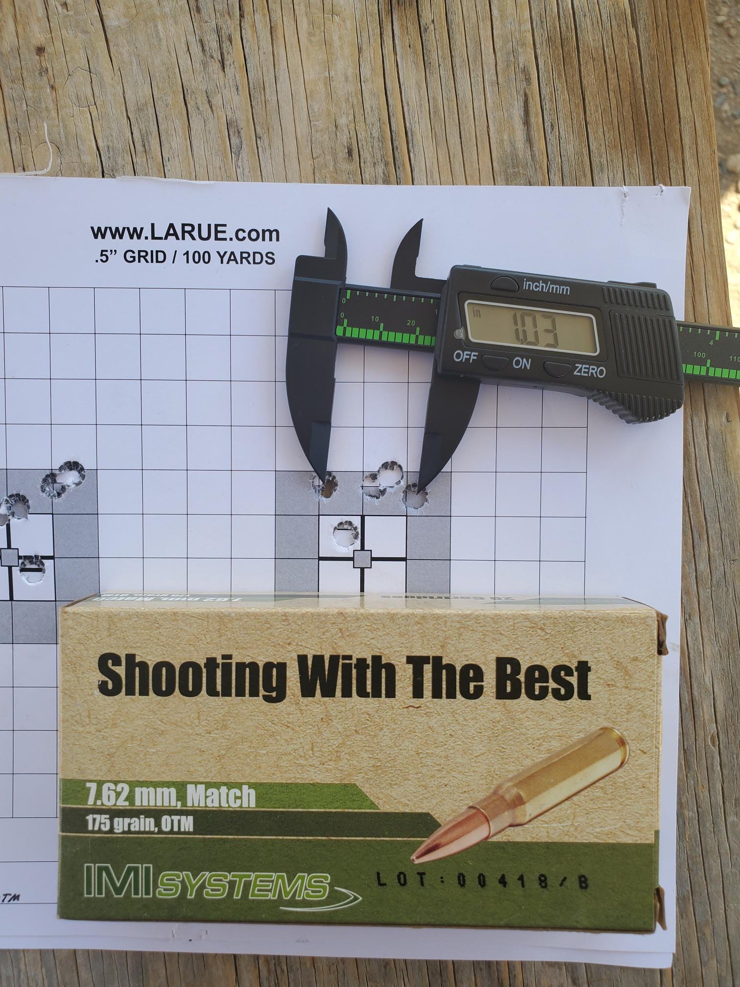

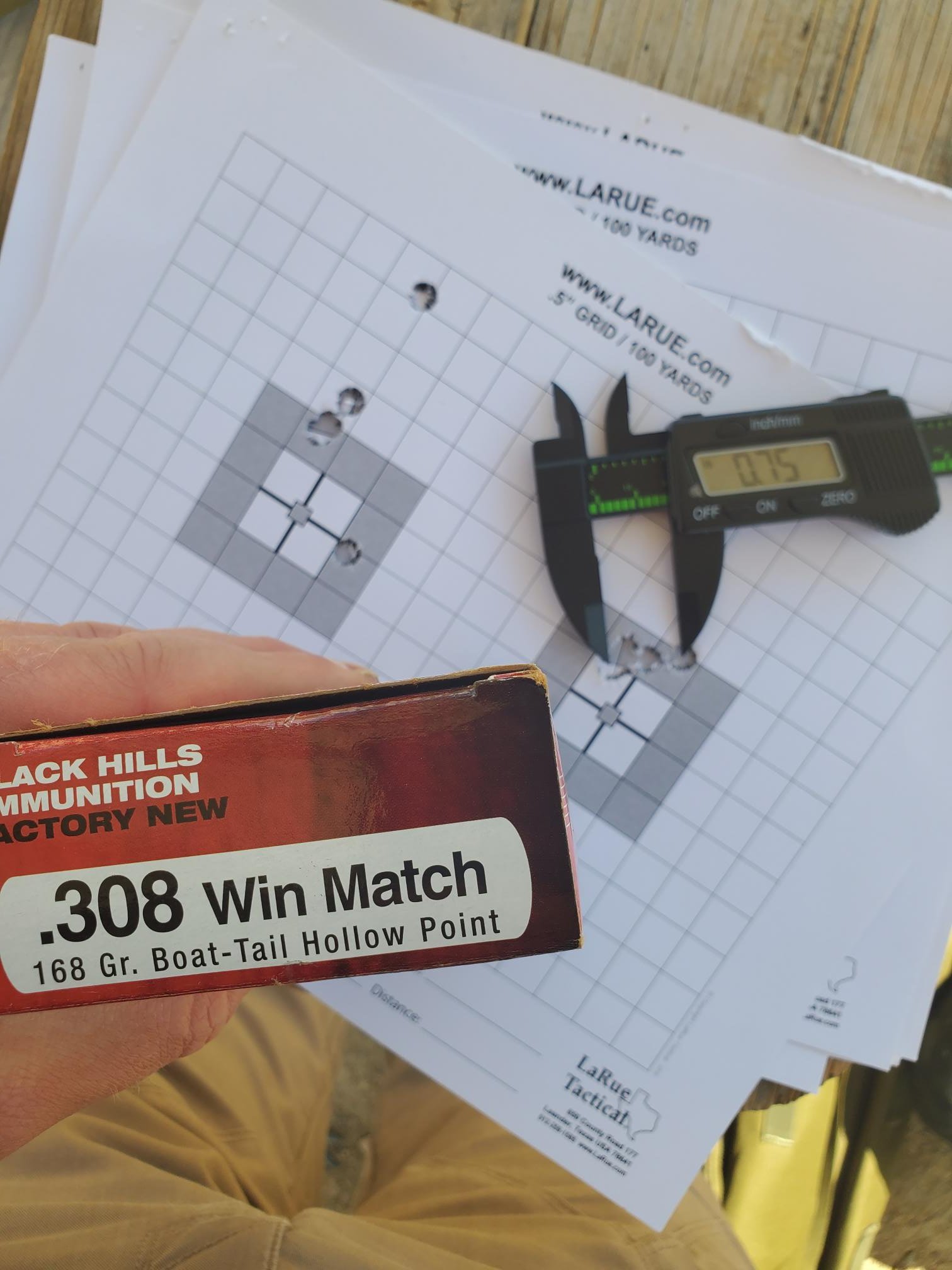

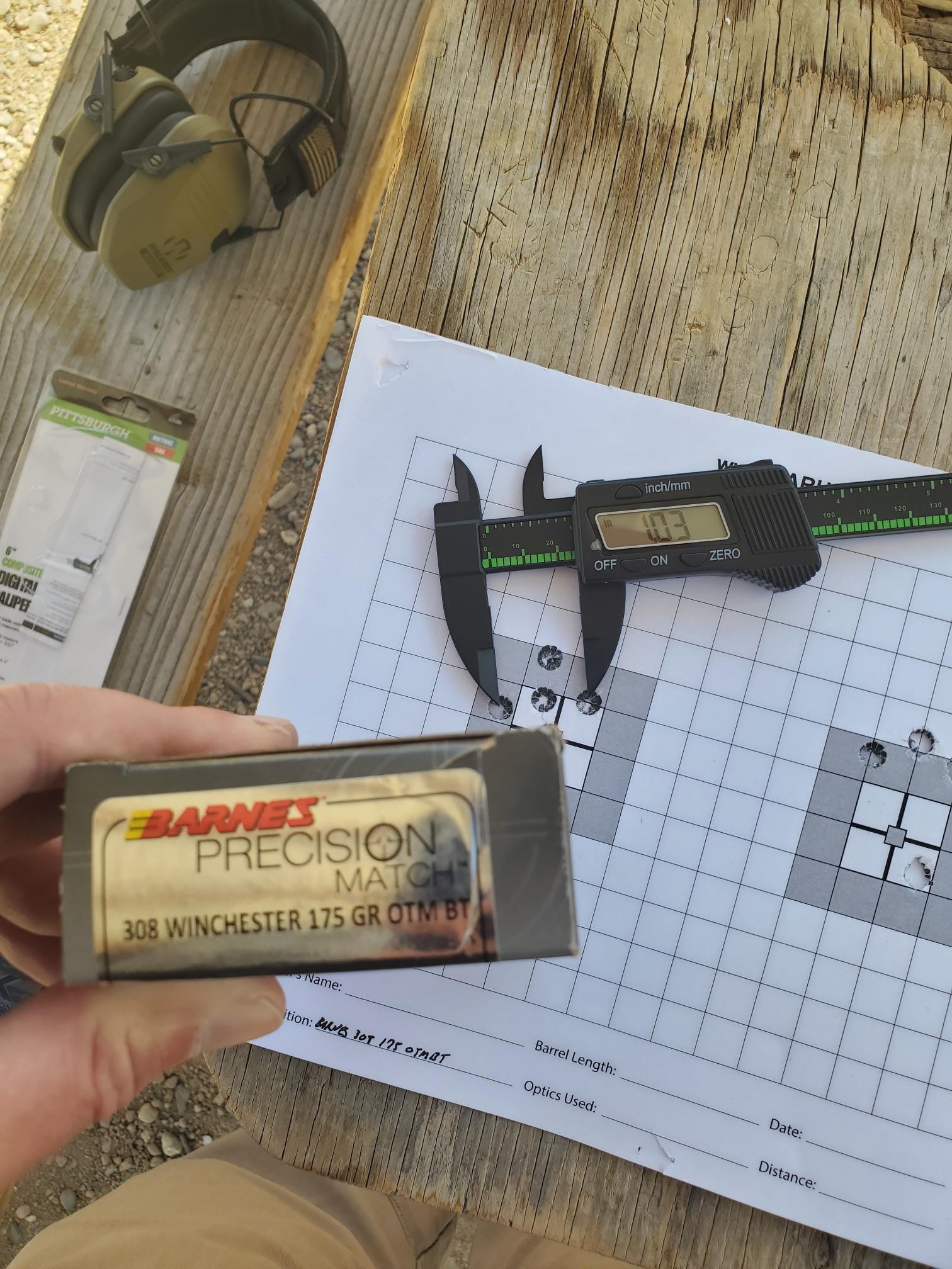

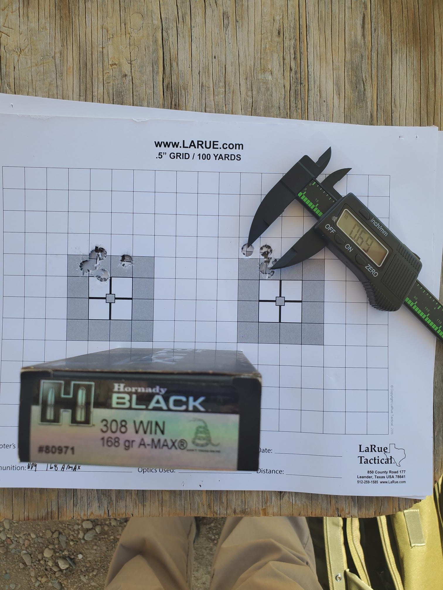

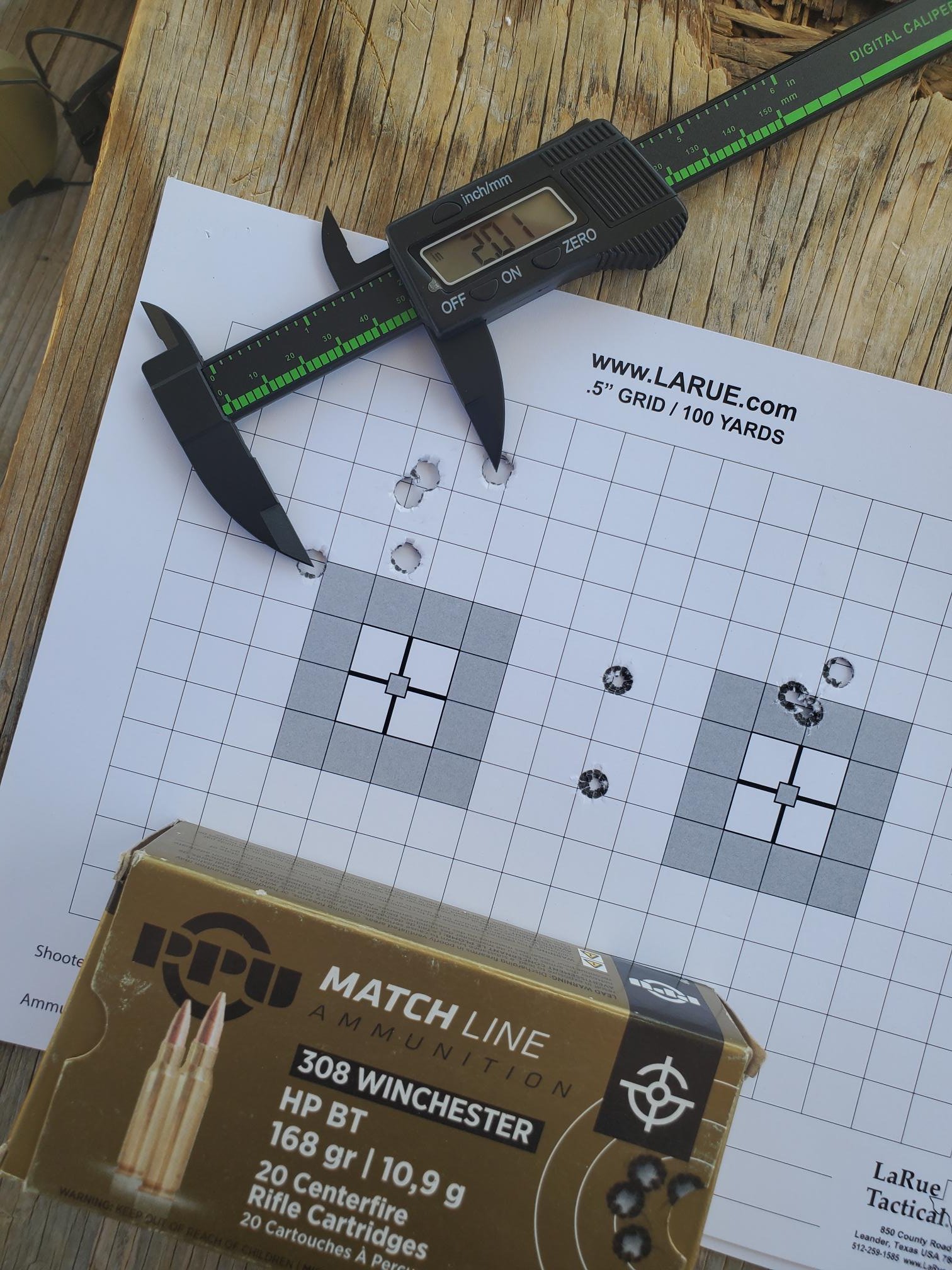

    My results I fired 4 five-shot groups I recorded the best ones I could achieve with each type of ammo. I was watching a guy next to me measure his and he let me borrow his digital measure thingy. If I did this wrong please let me know. I'm really new to this. I tried going from furthest bullet holes in the center of the hole for measuring.

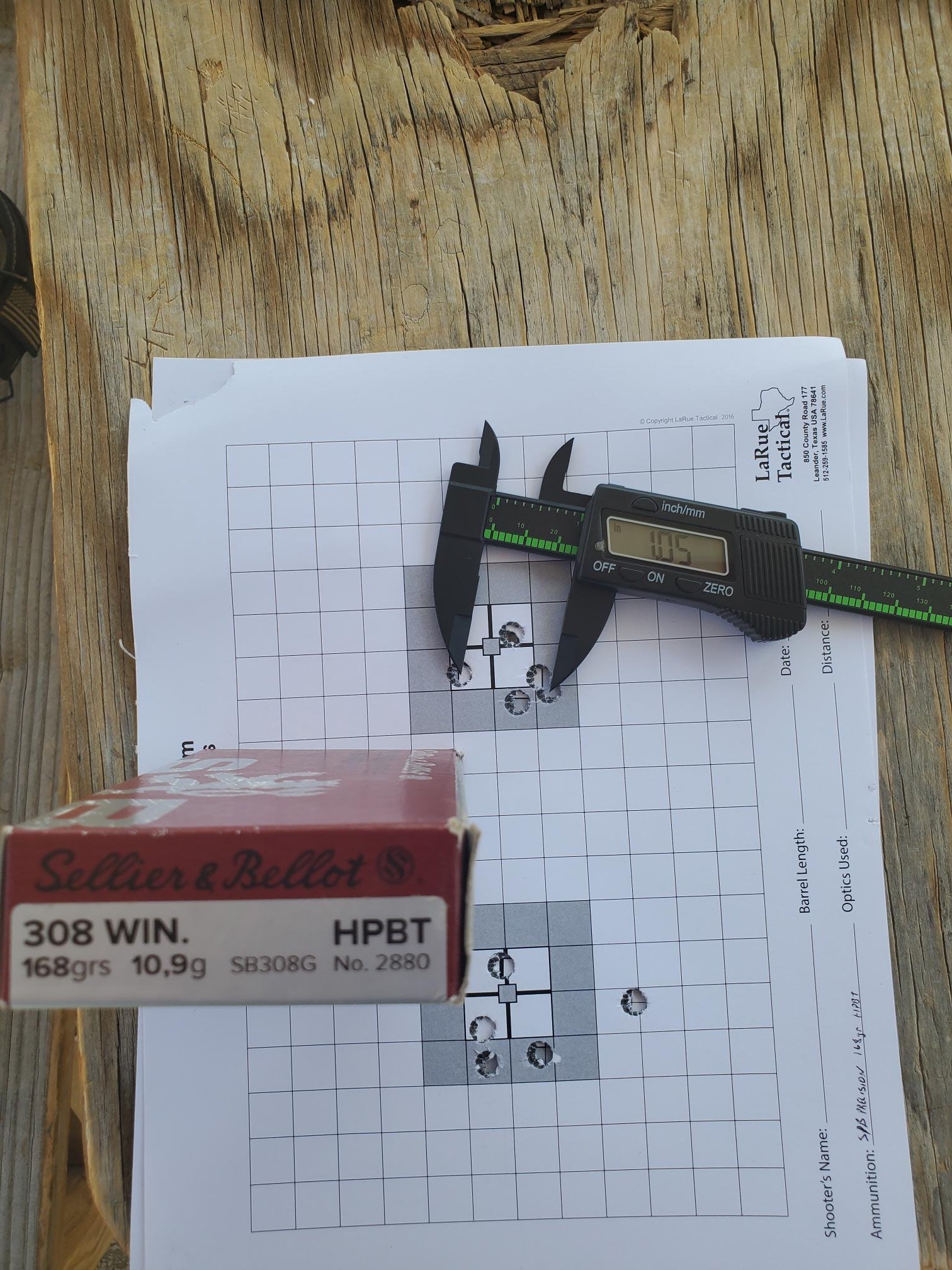

    The S&B and IMI seemed to my little skill as to being the most consistent point of aim point of impactish

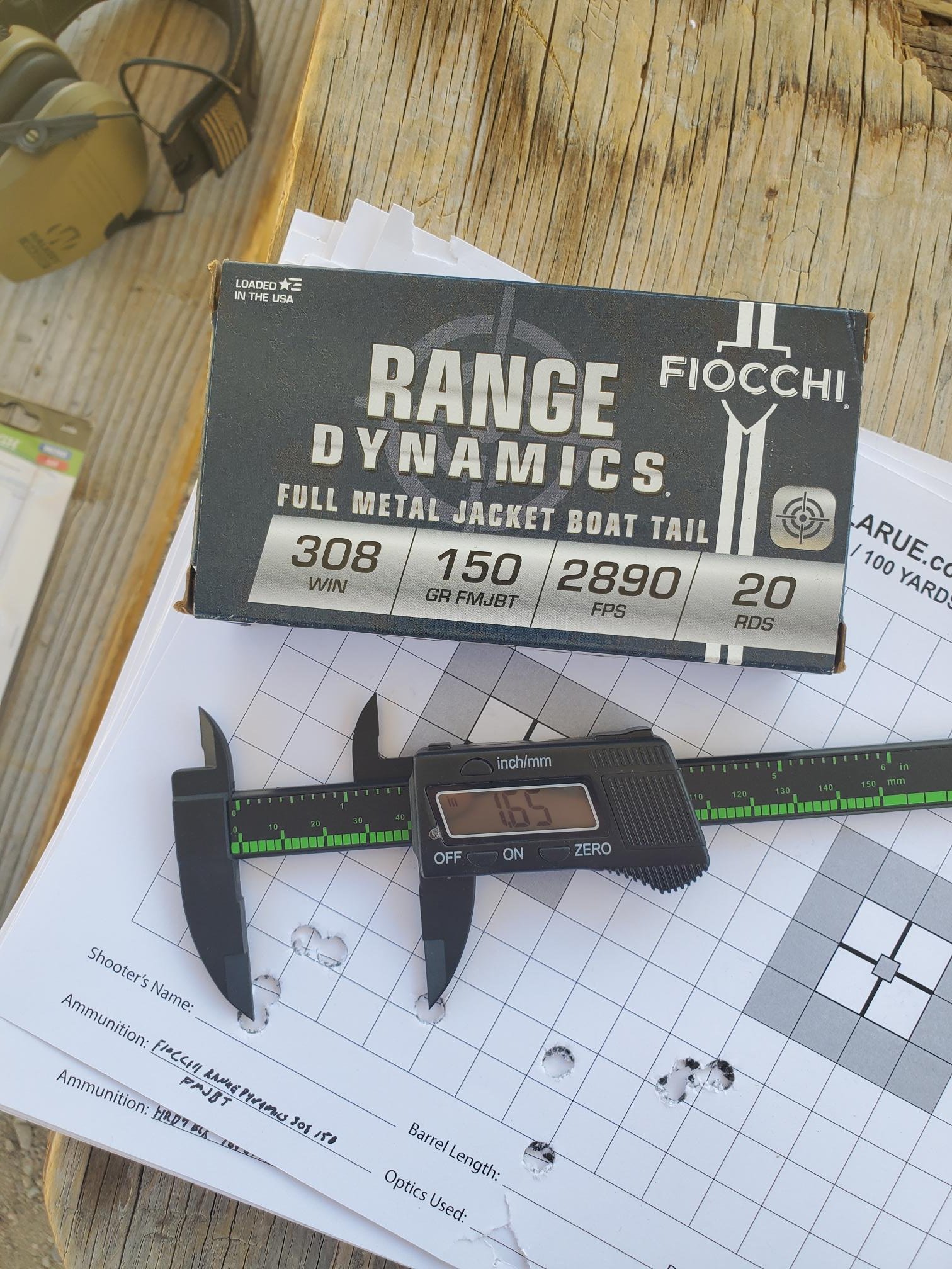

    The Fiochi was the most inconsistent for me in my eyes, and rather expensive more so then the ammo above

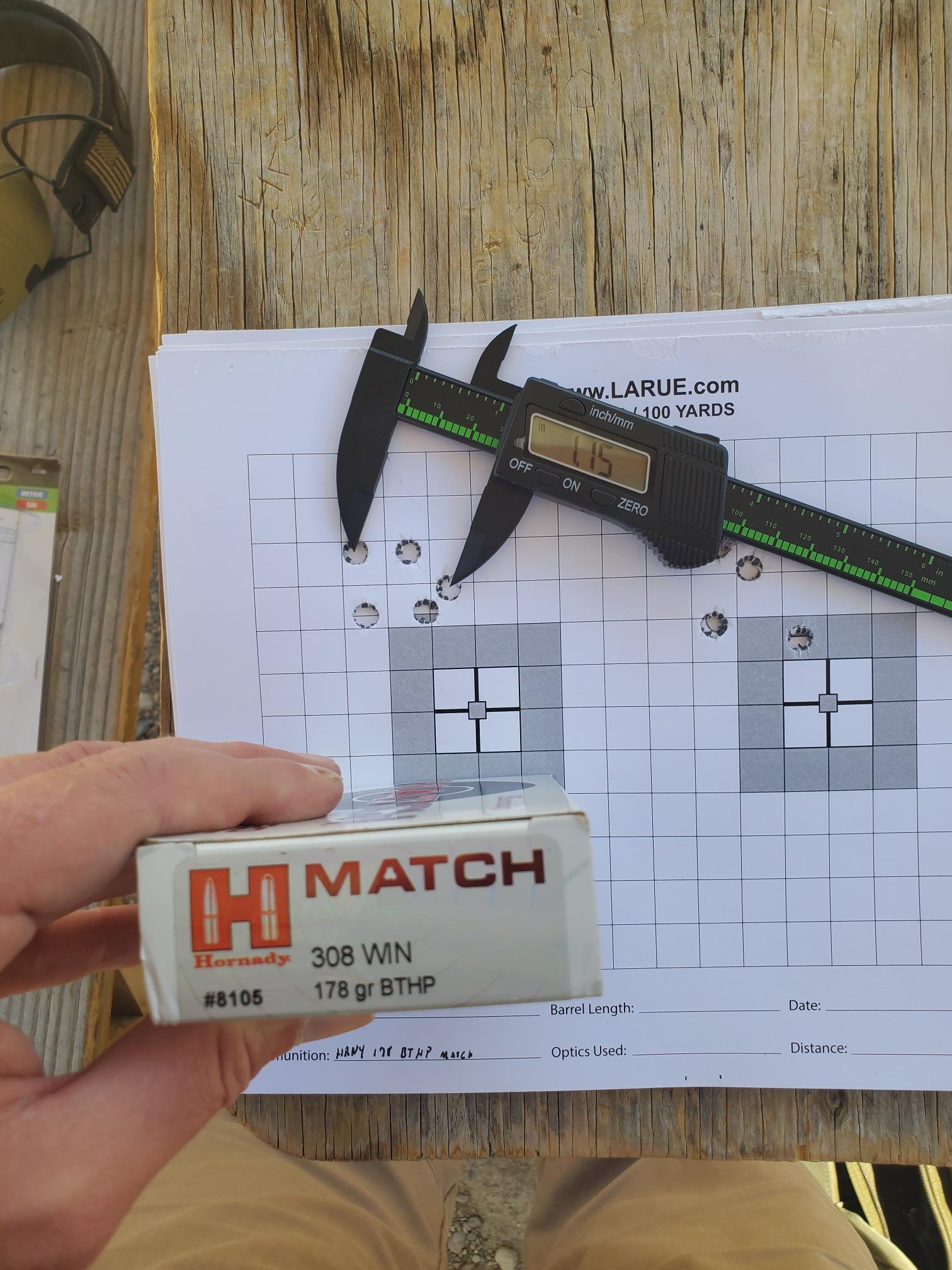

    This Amax was my best preforming Horndy and the cheapest off the other horndy on Lucky gunner
    The left super high one was the cold bore shot these were the first 10 bullets on day 2.
    This stuff for as expensive as it is superpreformance did not like me the other 10 rnd target had much more spread second most expensive ammo per round

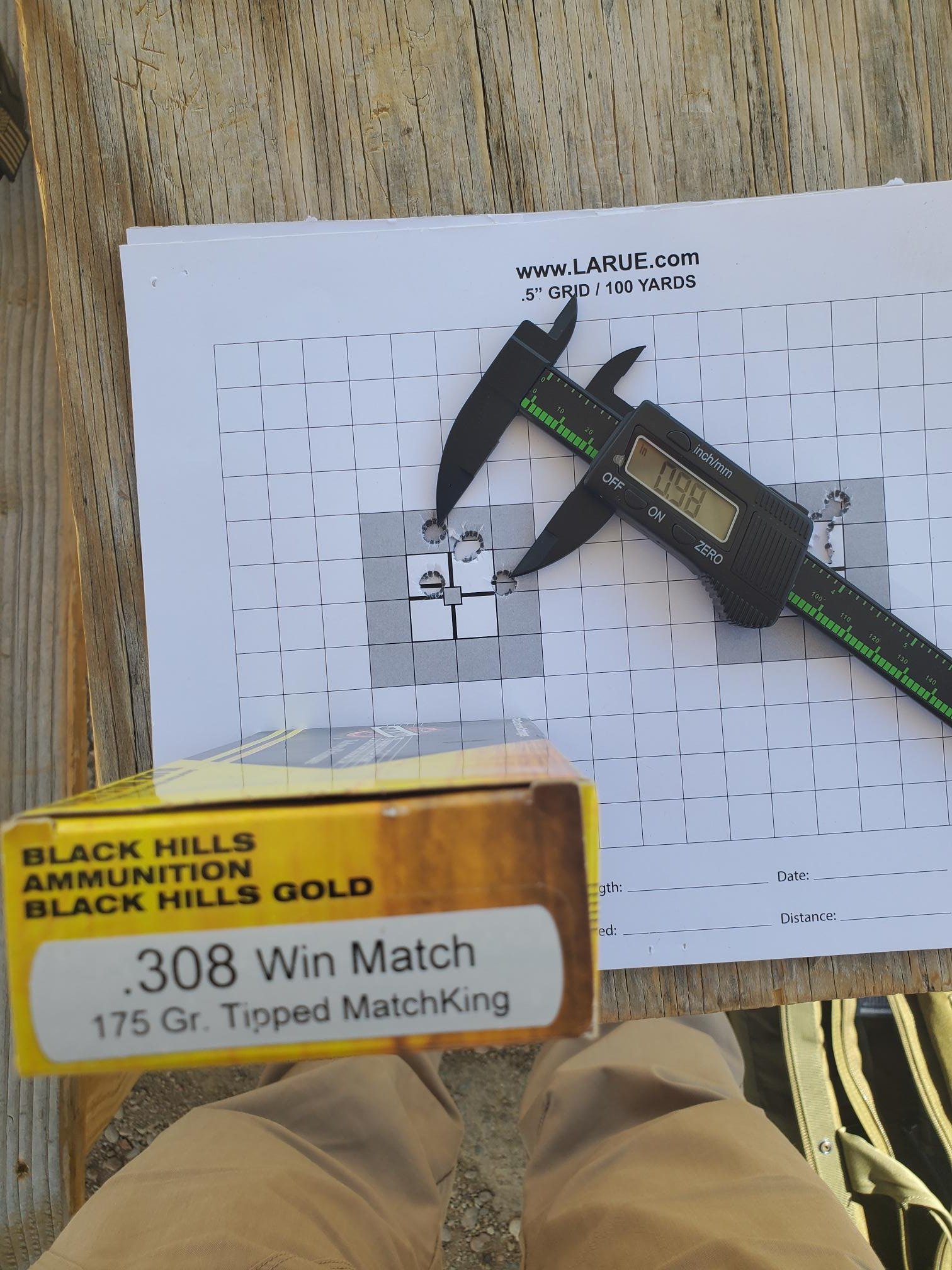

    And onto the most expensive thing I put down my barrel which did rather well after not cleaning or doing anything to the firearm the whole time. The right group was tight but I pulled a shot so I didn't use that as a measure.
