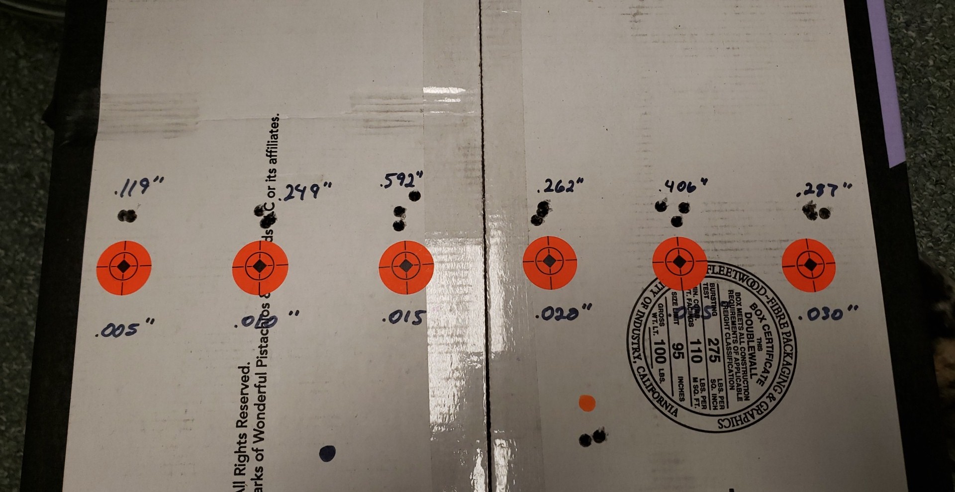

Did a jump test with 22br. This one was kinda unique with the opening and closing after .010" jump. Would you consider the difference between each caused by the actual jump difference or natural variation and shooter error? The POI is very close to the same for each group with 17 of the 18 shots probably falling inside .5" if all shot on the same target.
Take your best group. Repeat it with more shots. Do it again and take it out to distance.
Also don't jump .005 at a time, try .002 or .003. Your best seating depth might just be between .005 and .010, etc.
If it is, then set it closest to the lands and forget it.
Take your best and worst. Shoot a 10-20 shot group with each. Compare them.
That will tell you about how much noise there is in your results.
Also, no need to take it out to distance unless you’re doping or want to make sure the BC variation is low. It’s not going to shoot .2 @ 100 and then shoot .8 or 1.0 @ 1,000yds unless the velocity or BC variance is too high. You won’t obtain anymore seating depth data at distance you can’t get at 100.
If you are going to be testing your seating depth often, then you can break it down to .002 or .003 increments.
However, if you’re not planning on checking/changing often, I’d keep going past .030 and be looking for the longest range that gives you your minimal acceptable precision.
You may find that yes, .007-.010 has the smallest groups, but you have to continually test and keep your seating depth tuned.
But you find that .030-.045 still stays around .5 or less. And now you don’t need to mess with it until the throat erodes enough.
Just an FYI . . .
Referring this to a "jump test" when it's really a seating depth test will confuse a lot of people about how important the jump is for this. It's the seating depth that's way more at play here that the effects of jump. Because various chambers can have various freebores, a .020 jump used in two very different freebore chambers will have very different seating depths with very different results. So, when you state particular jumps for your test, it really says nothing about how deep you're seating your bullets.
But . . . as for your test and there being a direct relationship with jump and seating depth over the short testing period, the results can be evaluated in terms of the increments used for changes in jump. For this particular cartridge, .005 increments in seating depth (or "jump" as you're referring), is a bit much where you might just jump over a good accuracy node; better to use .003 or even .002 which should give a better read on the paper. Going with that large of increments seems to save on components, but not really if you don't happen to land on the good node.
To me, it looks like there's probably something around that .020 off. So, I'd probably run a test from .014 to .026 (.003 increments), though it looks like something going on there around .030 too (I refer to jump distance only for your benefit, though we're really talking seating depths for your particular gun/barrel/chamber).
I would be hesitant about doing anything with the .005 off as that's close enough to effect a close to the lands spike in pressure that'll go away rather quickly as the throat erodes.

I knew what I wanted to do after this test. I posted it to really see what people's opinions were on the subject. I'm kinda surprised only one person said it was probably more related to me. This is a PRS rifle and what this test showed me is that the one flyer at .015" probably had nothing to do with the jump. It also showed me that the bullet isn't jump sensitive and I could start at the .005" jump and not have to worry about the throat erosion for awhile. Don't over complicate things guys unless you are shooting competitive BR matches which is a whole different game.
I personally would look between 25 and 35 thousandths. and stay away from the .005 area. I suspect that you'd find a more consistent load there and you won't have to chase the lands, so to speak. But your conclusion is spot on. Also, with 3 shot groups it's very hard to say that a .3" group is actually Better than a .5" group with any great confidence.

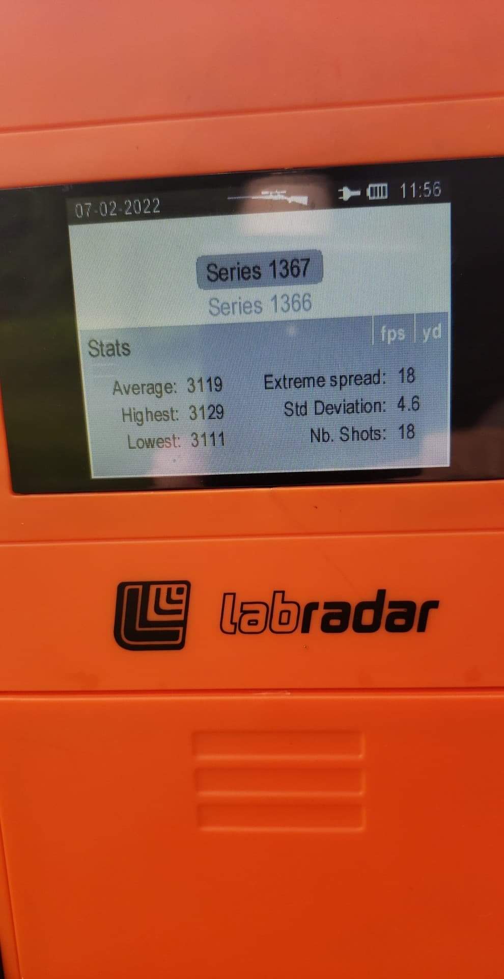

Nice lab results by the way!!

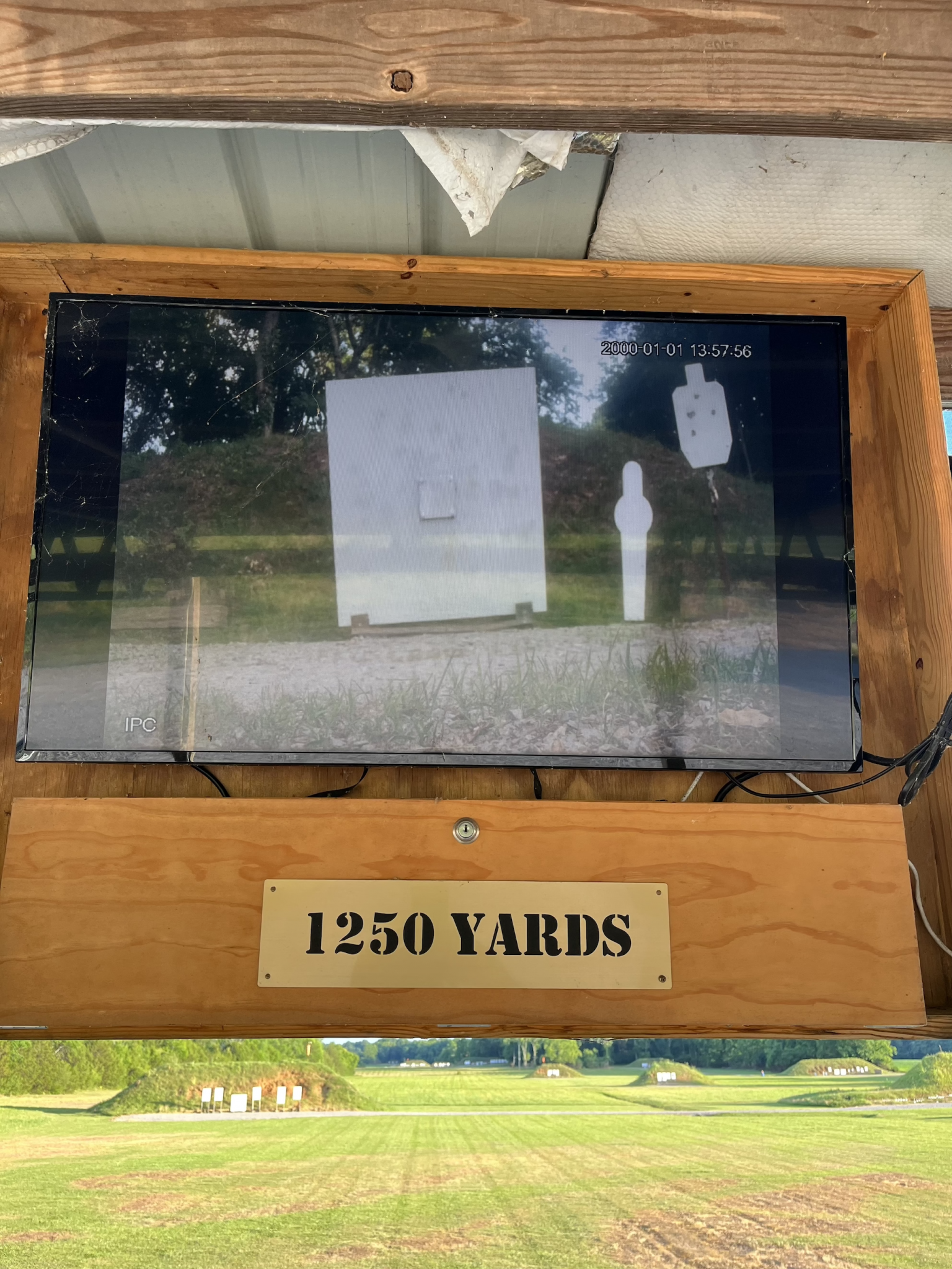

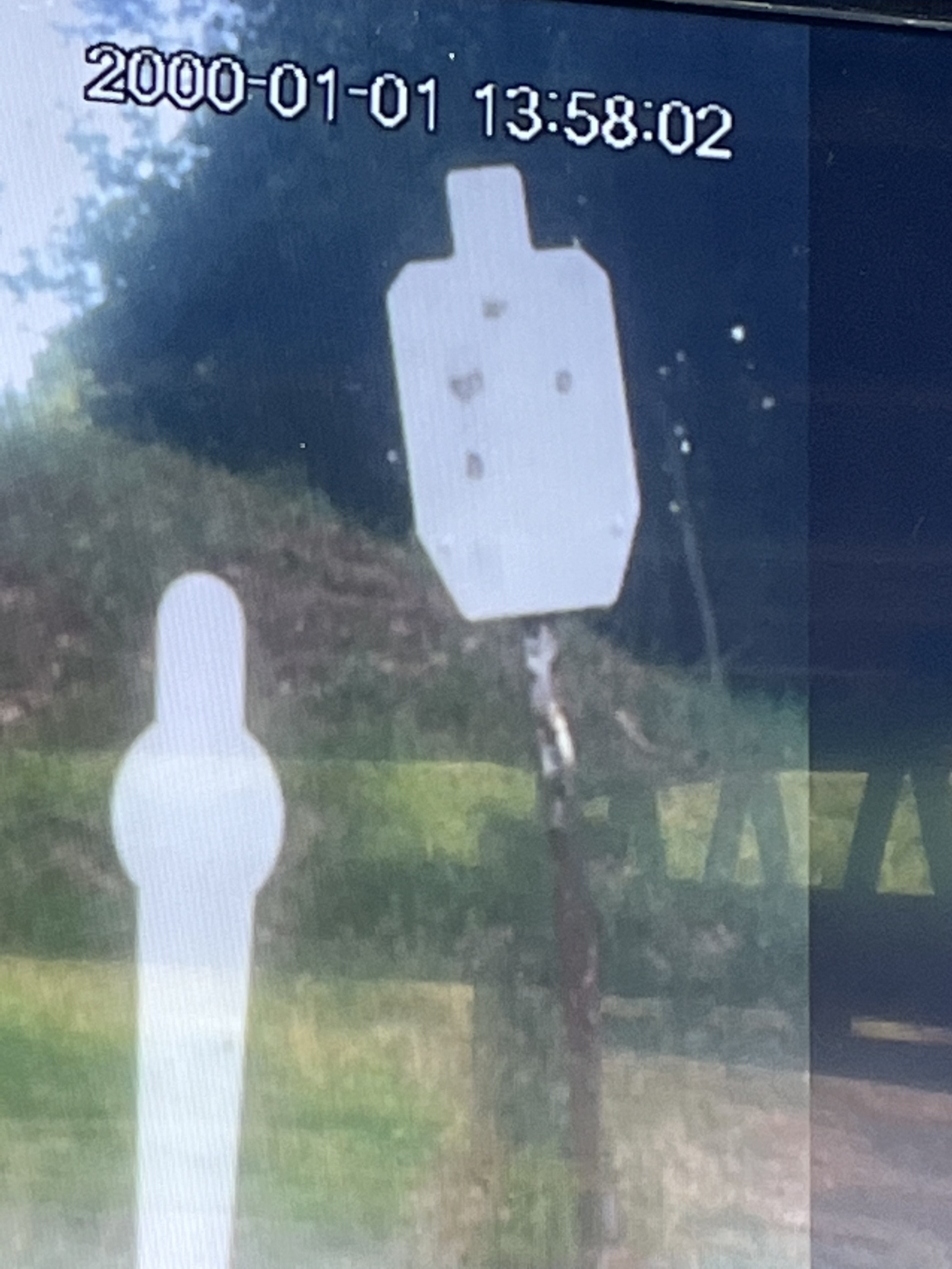

These are shots #96-#100 through my new barrel, rounds were left over from the last barrel so they are jumping ~0.100" or so (same model Proof prefit), the barrel hasn't even had enough rounds through it to have settled in yet speed-wise, zero barrel break-in (I don't believe in that nonsense, I just screw it on, single dry patch and go), no load development at all:
I don't know what groups look like at 100 yards yet, and I'm not sure I care lol!
