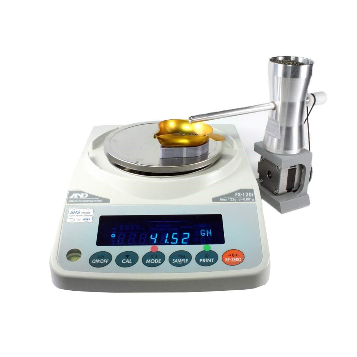

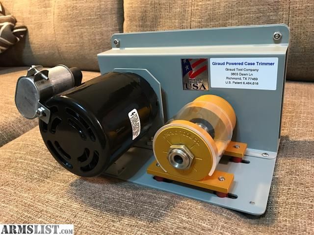

In my experience I save the most time by using a higher end trimmer and scale. The time to trim 100 pieces of brass is equal to how fast I can move my arms to stick them in the machine, plus changing the cutter head if I switch calibers, which adds 3 minutes.
NDAuanBn
Fast & accurate electronic scale is the other time saver. I started with a basic $75 beam scale. It was so slow and didn't produce results up to my expectations. Once I switched to the A&D FX120i with auto trickler v2, I saved both time and frustration. Toss in a lump with a spoon, let it trickle then dump into case. Goes about the same rate than I can insert then seat a bullet with my press.
cGc
