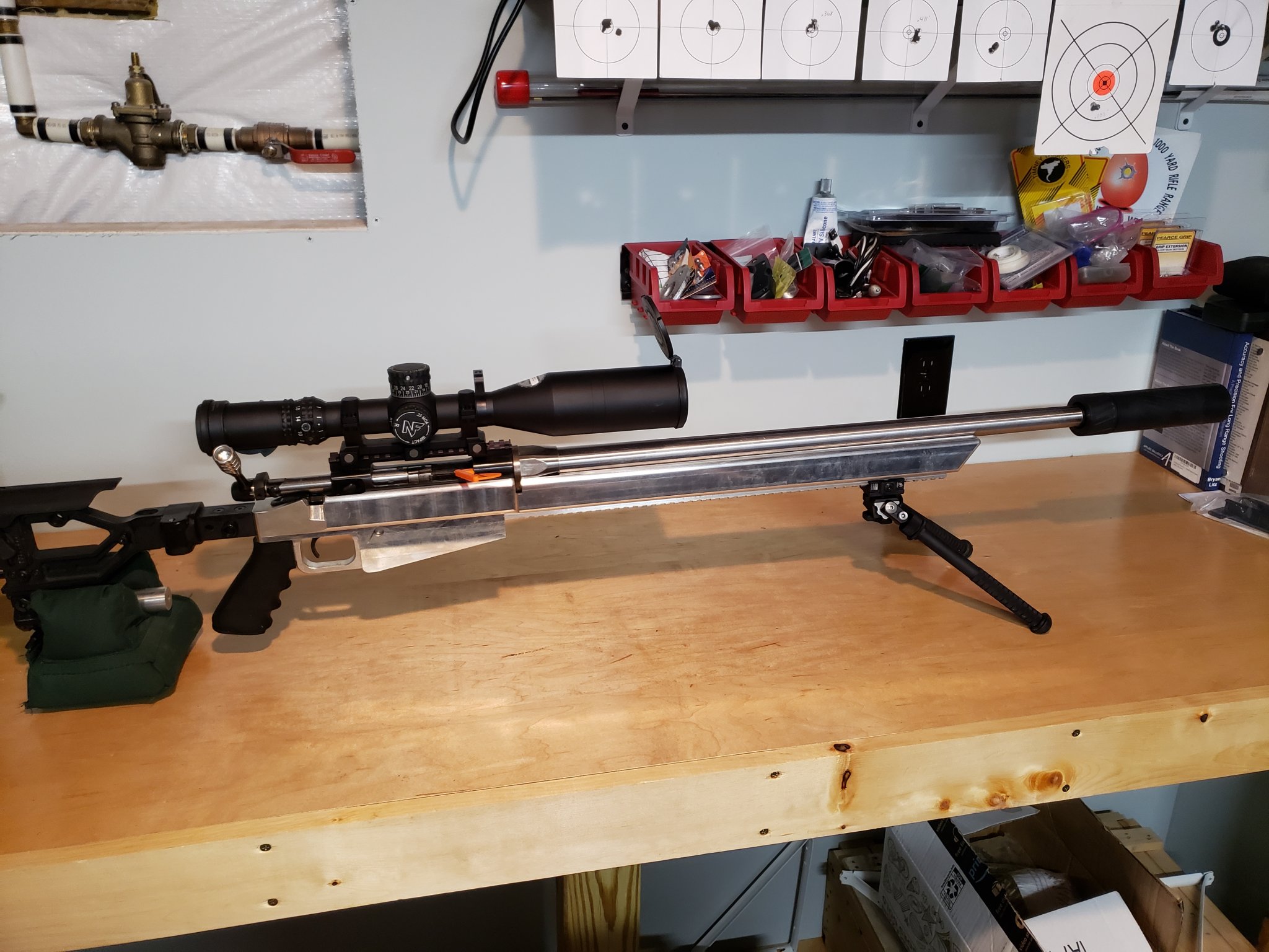

I ended up machining this chassis for my 7mm RM. I was shooting for a specific weight and the commercially available one didn't meet my goal. I fitted an AI buttstock on it and love it. I ended up about a pound heavy but that will be easy enough to correct. I just need to remove a little material under the barrel.
