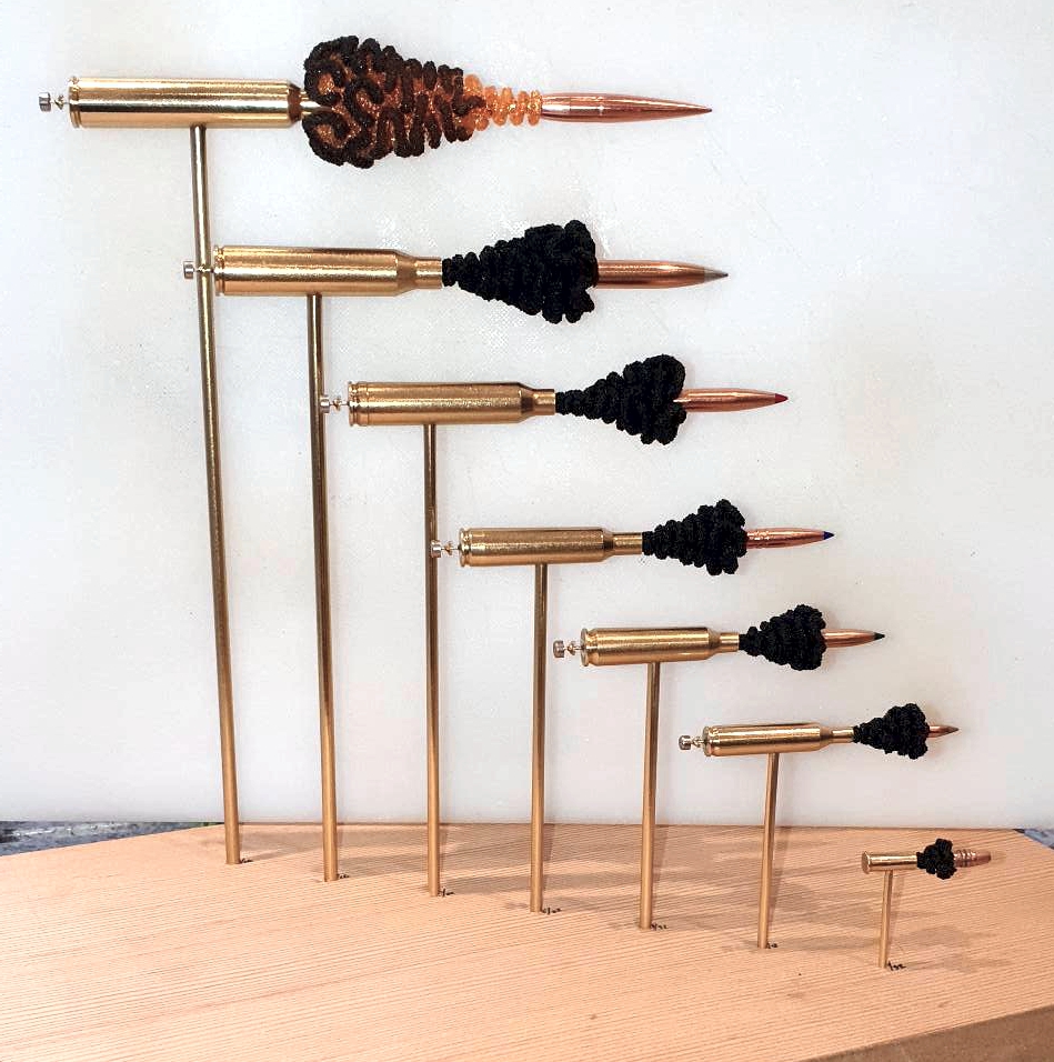

I’m not sure where to post this, but this seemed a good place to start.
Just to be clear, I’m only asking for one line opinions, actually 7 lines ;-)
The picture is of the of the 7 calibres I shoot, made for me by Tony at Ballistic Concepts (https://www.etsy.com/uk/shop/BallisticConcepts)
Tony made each one from the components I supplied him.
The board is just a mock-up at the moment to decide on how to display them.
When finished, alongside each calibre, I’ll have a laser engraved plaque with the calibre, bullet details and here comes the matter of opinion, its maximum range in yards.
I need to put a pin in “Maximum Range” and decided it is, IGNORING human factors and assuming an optimum load, the ability to hit a 2 MOA target 100% of the time at sea level, nil wind, ICAO temperature & pressures.
So, your opinions please on the following (it’s just a display, not a competition and don’t need a Thesis!)
1. 33XC with Badlands Precision 285gr ICBM-2 (G1 1.010)
2. 338 Lapua Magnum with Parker Products 300gr Aluminium Tip (G1 0.960)
3. 7mm Remington Magnum with Hornady 162gr ELD-Match (G1 0.67)
4. 6mm Remington with Barnes LRX 96gr (G1 0.436)
5. 22-250 with Sierra 77gr MatchKing (G1 0.420)
6. .17 Remington with Nosler 20gr Varmageddon (G1 0.183)
7. .22LR CCI Segmented Copper coated 40gr (G1 who cares!)

I fell bad for you...lol
I know what you want and it’s a good idea but this will be a shit show soon
maybe pm a few guys who seem to know what’s going on by their previous posts.

like the post above
maybe just run published velocities and BC with a ES of 30FPS (thats pretty good reloading)
so if the velocity is 3000 runit for 2985 and 3015...
run a bunch of scenarios through a ballistic calc and stop when it goes over 1/2 moa up and down from point of aim
figure at best 1 moa is attainable at the max supersonic range of a cartridge with a "berger" class bullet
so 1 moa + .5+/- equals your 2moa max ...thats your range
