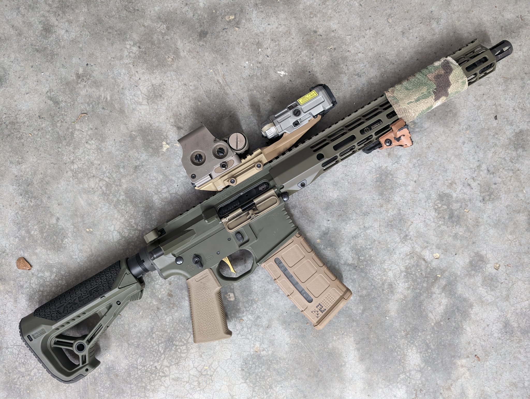

This is the best way I've found so far. Haven't attached the switch yet because still working on F/R placement. Unfortunately if you want battery access this is the only way to setup the mount/ramp, which kills magnifier access, might be ok with the shorter G43, will give that a shot. This is the .875 height which gives you 2.5" optical center with EXPS. GBRS was too high for my tastes and Unity too low.
What riser is that?
