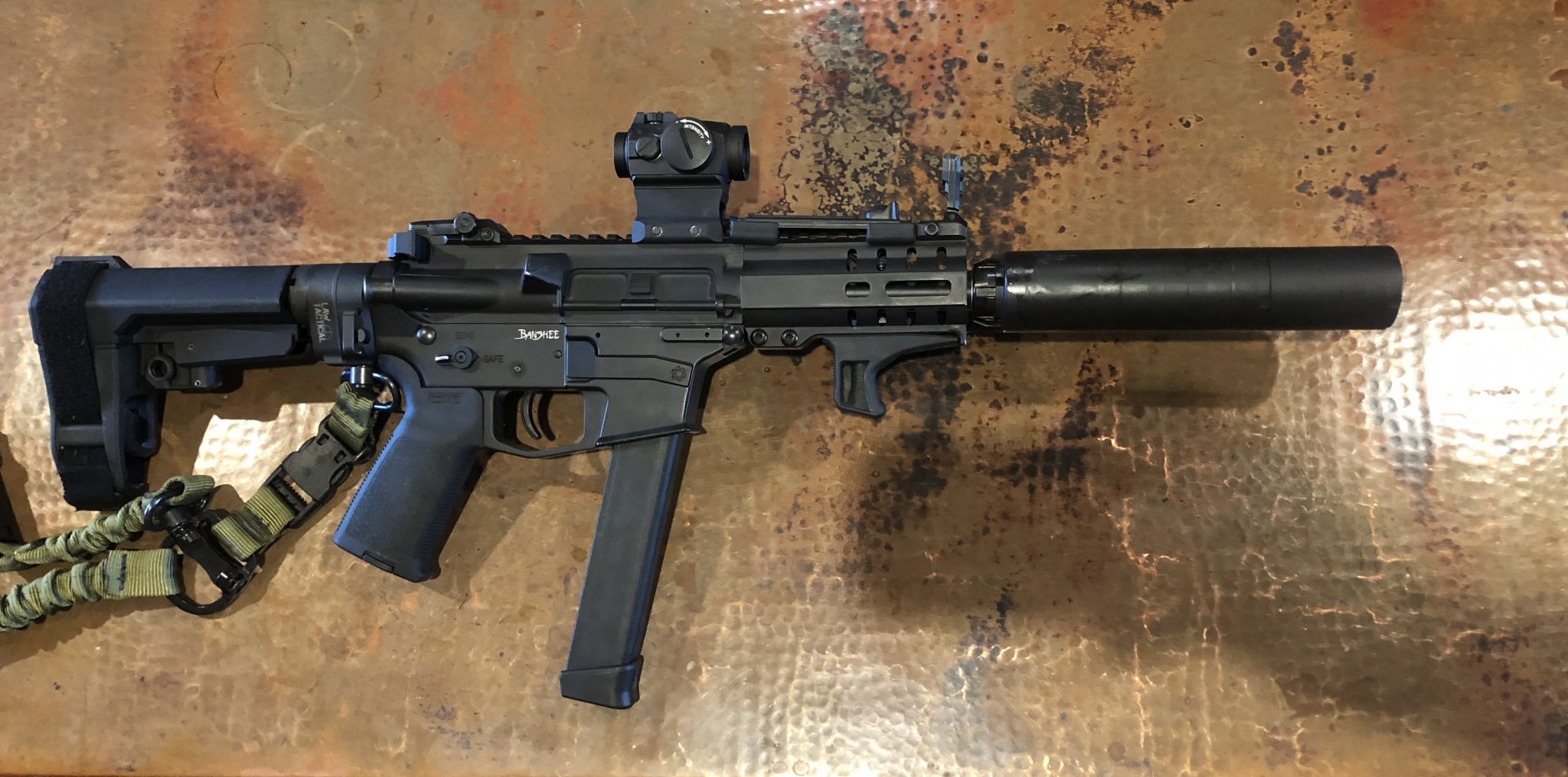

    I was going to hold off on mentioning but I went with the OSS HX-QD 7.62 Ti. Wasn't the cheapest or the lightest but I felt like I'd have to do the least amount of fiddling with my two AR's to get them to run consistently and it'd just be easier overall on their parts long-term. And I do wear hearing protection regardless and wouldn't ever consider not as my third job is as a musician.
    Zeke, I do have the SA gas block on the AR15, standard restrictive gas block on the POF. It'll be fun to experiment with the bleed settings and the OSS can. It still has a bit of back pressure but nothing compared to a conventional design.
    In the end it just ticked all the boxes and the POI shift seems to be 100% repeatable when taking the can on and off. I also like the fact I can submerse it in CLR and shoot it out. I honestly want to give the X2 Dev group a shot but there were too many unknowns at this time. And maybe I'll have enough from working three jobs to look at the TBAC Dominus-K next year or just go with the DSU upper as TB did all the hard work already.
    Usually when I buy something "big", the new version comes out the next week. So stay tuned for that announcement, LOL.
