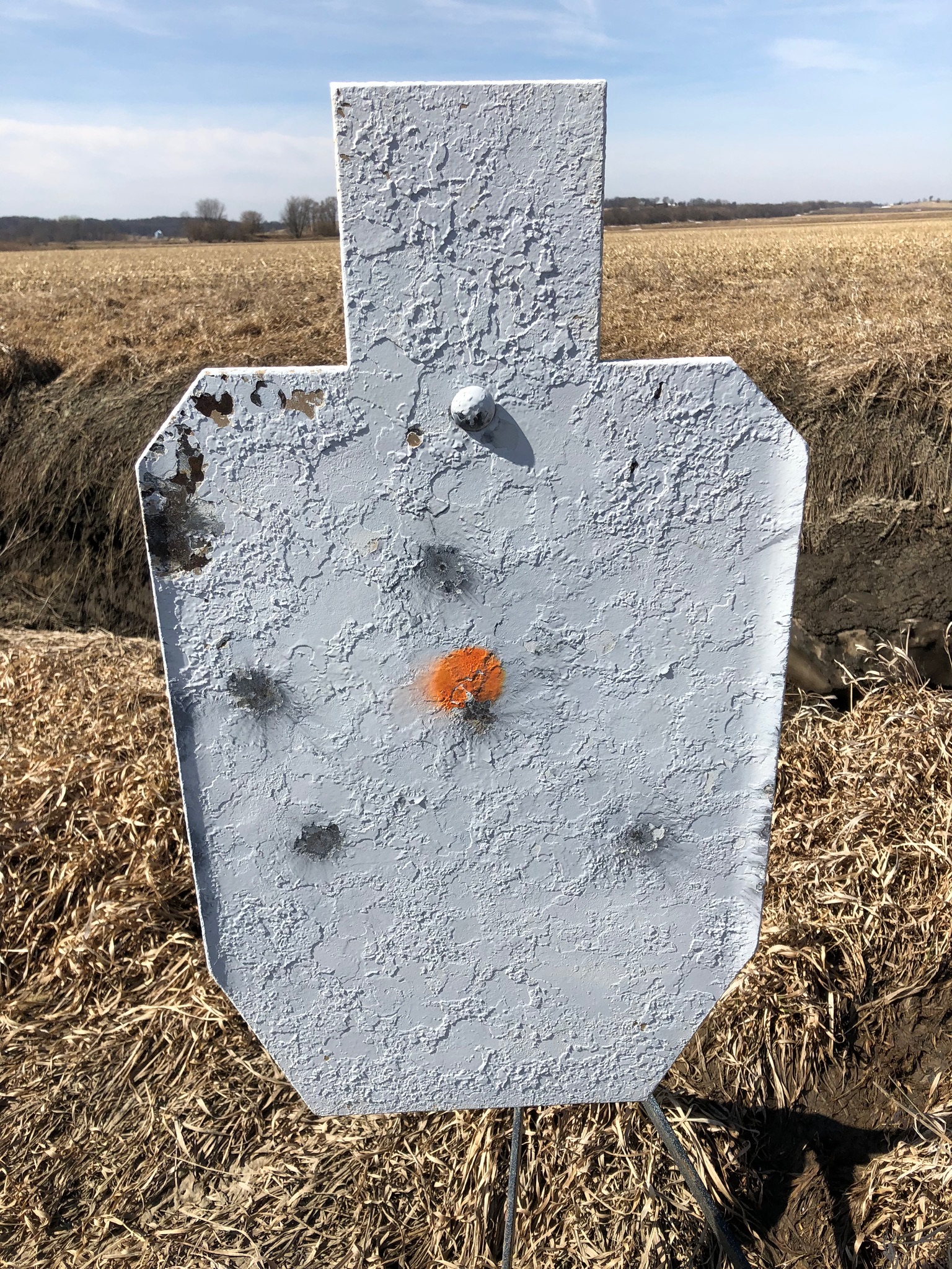

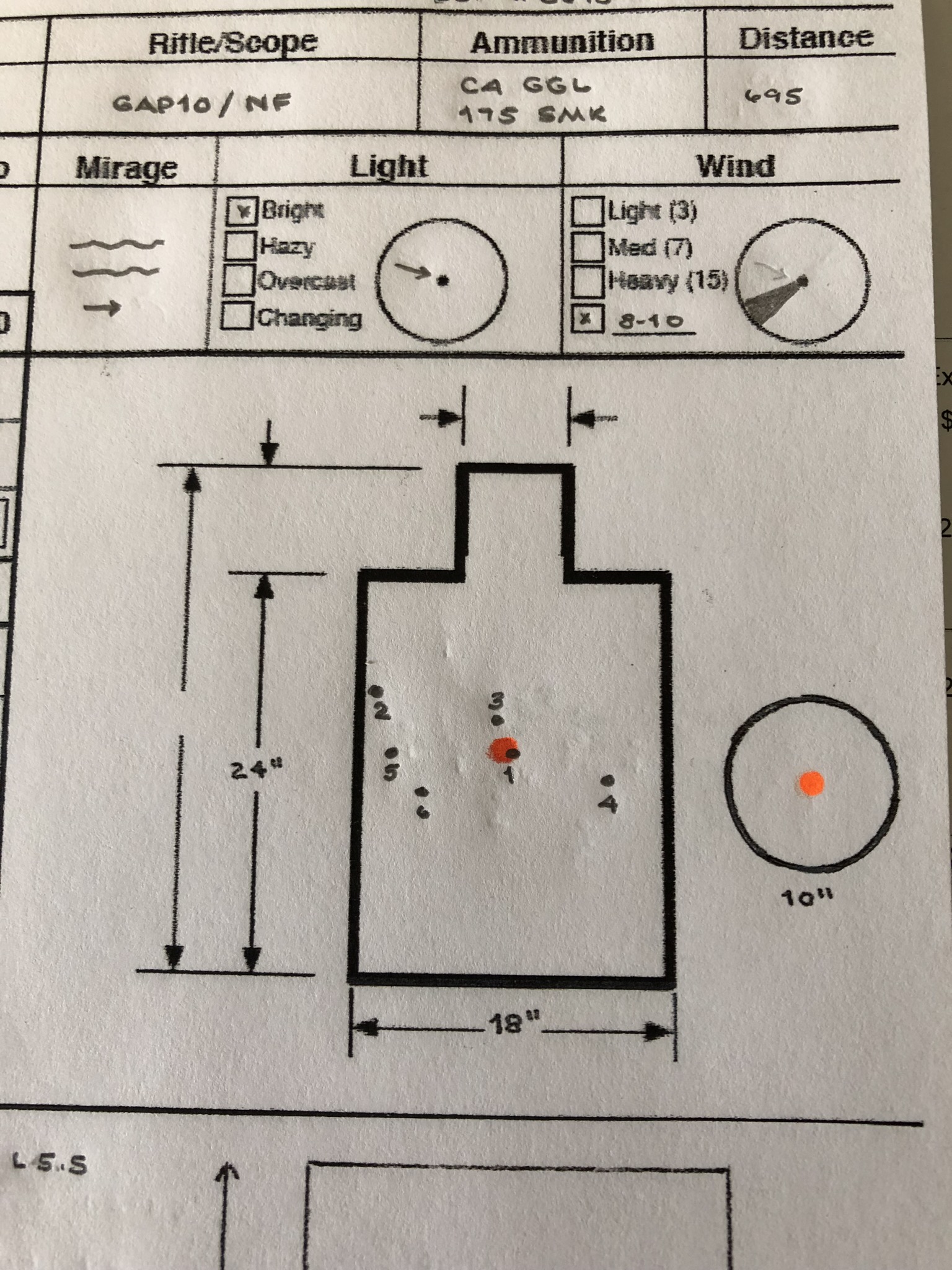

Nice spring morning here, so I grabbed my GAP10 for something different as I’ve been running my bolt rigs all winter. Made a pretty good call, so just for fun, I didn’t change my wind hold even though you could see and feel the wind pick up, then lull, etc... As you can see, I was using ALL of a full size IPSC at 695 yards. Compare the plot sequence to the impacts as it just runs back and forth across the target. The vertical is on me as I’m a little rusty on this gun and it exploits flaws in fundamentals.
20” GAP10 in 308 running Copper Creeks Gas Gun load with a 175 SMK at 2585 fps.
