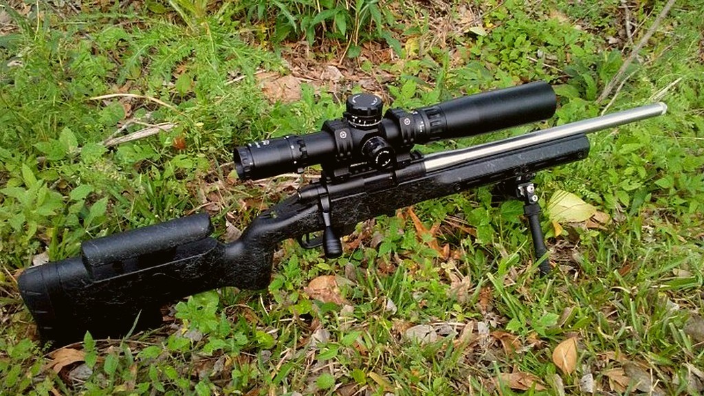

After reading threads on the Vudoo V-22 over the last month, I just had to get a barreled action. It was black tar heroin to me lol. I just couldn't stop myself. Today was the day that I finally broke down and took the plunge. The order is in. I got a Bartlein MTU contour finished at 20"; melonited action and no finish on the barrel.
Anyway, I have 3 weeks to wait for delivery, and I need to order some ammo for it. I don't think that I need the absolute best ammo out there, as I intend to shoot it mostly at 100 yards and in to practice barricades. I'll occasionally take it out to 200 prone. Can anyone recommend a mid to mid-upper grade of ammo for this purpose?
I'm going to break down my .223 and steal the trigger, scope and chassis to build the thing. Components include a Jewel trigger, USO LR-17 and an XLR Carbon chassis. It should be a really sweet rig once put together.
Thanks in advance for all replies.

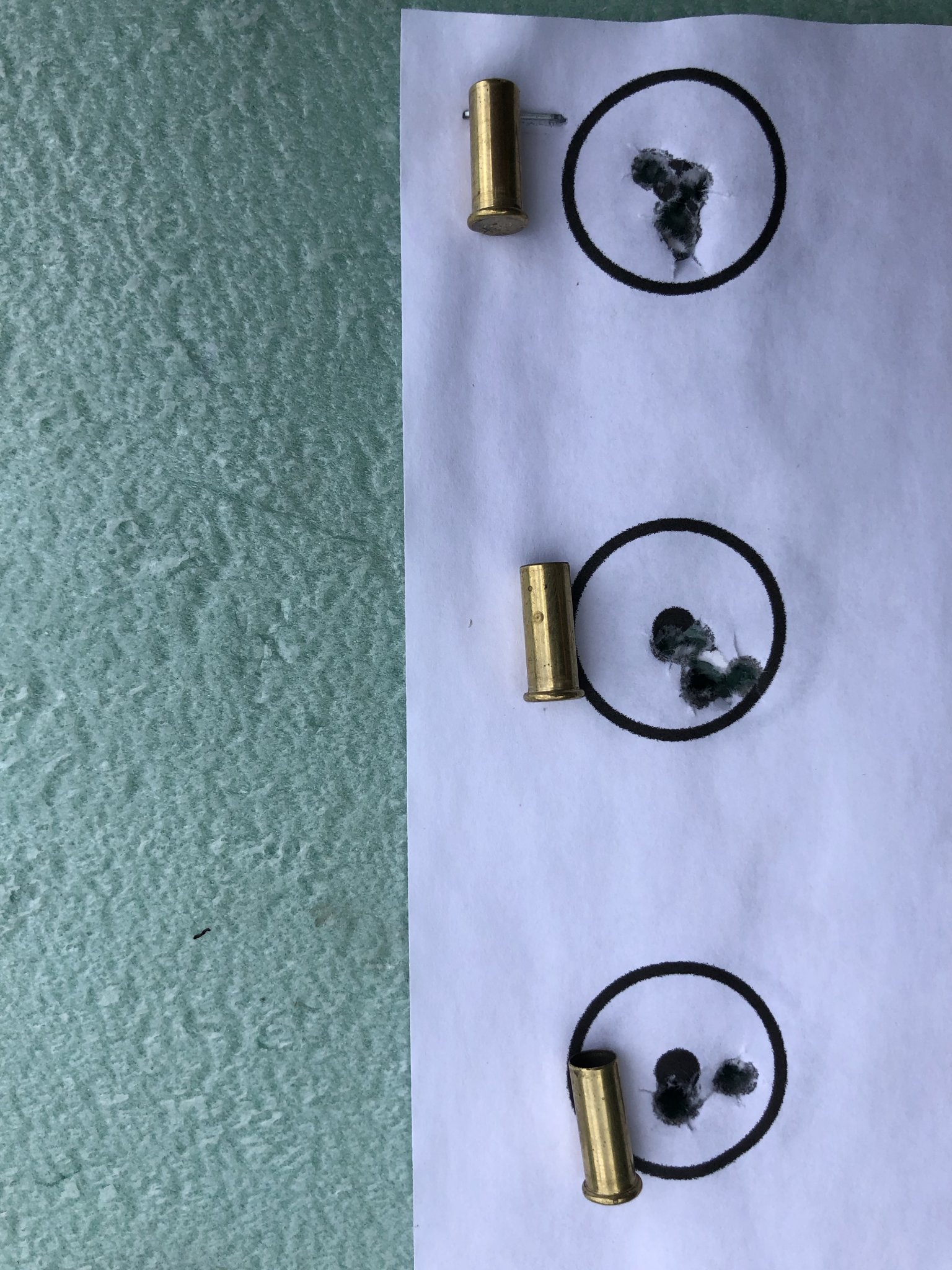

Here is a 10 shot group with one of my Vudoos with Eley Tenex ultimate EPS, and three 5 shot groups with Lapua Center X fired today, at 50 yards, outdoors.
This was with my “old” Vudoo that has over 20,000 rounds through it now.

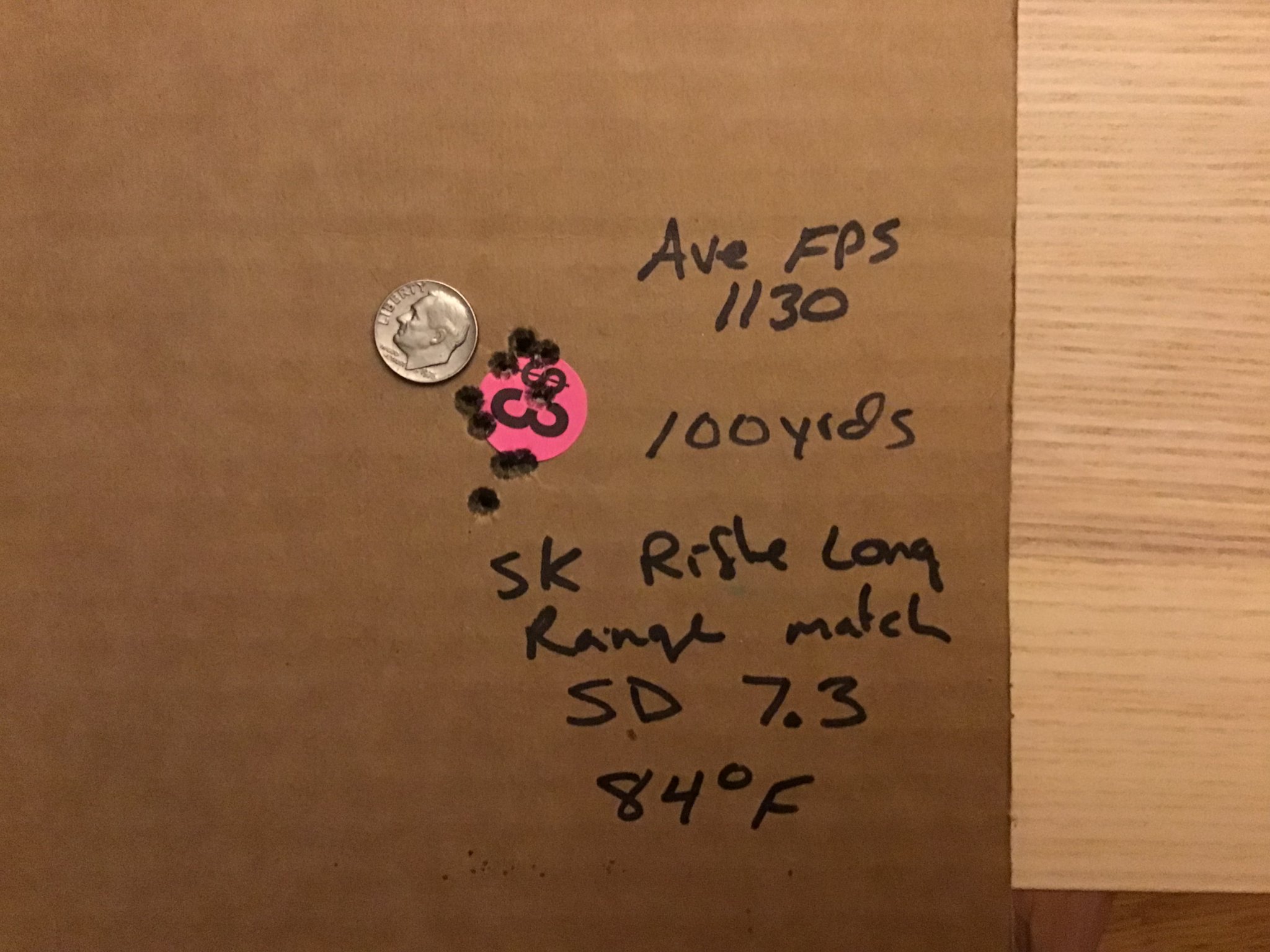

SK Long Range match ammo out did lapua center x the group size is the same but the SK Long Range match moves 50 FPS faster which means less dialing and longer range plus cheaper .

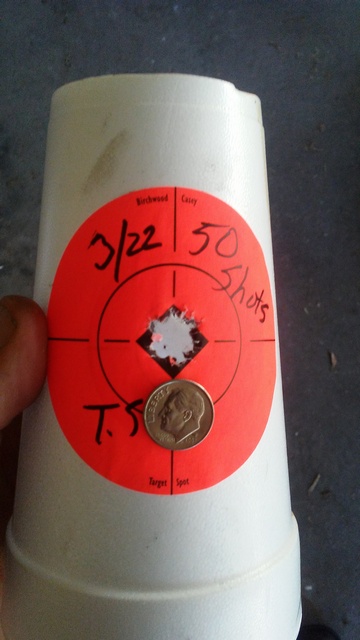

The whole box of RWS target rifle.
Vudoo v22.
Target was shot under very good conditions at night over a 12 hour or so span. 5 shots every hour or so.
Sometimes a little more than an hour.
Other ammo that will do the same or better, CenterX, Eley Match,.........SK standard plus is also very good from my gun.
I bought several cases of RWS because I was getting it CHEAP. $2.80 per box of 50 rounds.
Eley Match would be my overall choice. It does extremely well from my v22. but at 1400.00 per case,,,,,,,,RWS was close enough to justify several cases at 280.00 per case. Eley Match reserved for hunting and pesting.
50 rounds shot over 12 hours going into 1 hole!!! I call this BS and doesn’t matter what rifle was used. You spread this widely on RFC, now you’re doing this here. BS is BS. Doesn’t matter which site you put it on.
Whoever believes this target was shot the way you describe it is naive.
You are an idiot on Rimfire Feminist Central, and you are an idiot here. Migrating between sites does not make you any less of an idiot.
You call BS because you can't do what I did. Not because it didn't happen.
In fact, as I recall, you trashed the Vudoo brand because you wanted an Anschutz. Nothing wrong with Anschutz, I've owned a small truckload of them myself. But this I can tell you, the Vudoo v22 makes that Anschutz you bought look like a childs toy.
As to the other members posting to this topic, please allow me to apologize on behalf of one of Rimfire Feminist Centrals finest, up there.
Please do not blame me for being stalked by a ......Troglodyte.

As to the IOR Recon.......I like it a lot. It is very nice. Love the reticle and image rendition.
I have no problems bringing images in to tack sharpness. Additionally, when parallax is adjusted to crisp sharpness, it shows no error. Unlike some other scopes that are tack sharp,,,,,,but still have error and have to be adjusted out of sharpness to eliminate error.

What’s hard to believe about it? Here is something like 72rnds out of an 18” vudoo. Pretty rapid fire and at 50yds.
Paper dimes were 1:1 scale.
7119426
You do realize that your target is nowhere near as good as his... At the same time your target is real, and his target is fake. BTW I'm not bashing Vudoo. I don't own one, but from what I've read here all owners are happy and the CS is very good.
