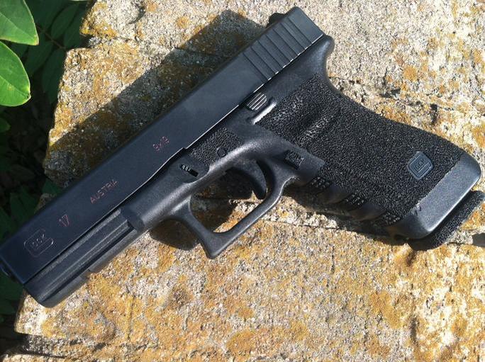

i was kinda thinking like a stippling job, and maybe an RMR if im feeling special,

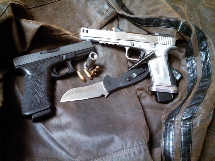

Here's my 19 that got a .25 cent trigger job, grip reduction and stippling job. I like it better, and i think it carries better.
All of my Glocks get Warren sights, Glock (-) connector and Vickers mag release ans slide stop. I'm also a fan of Trugrip grip tape.
The 17 is by far my favorite, I own two and I'm considering a third!
That stippling job looks a lttle ruff,
I just followed some pics on the web,
Look pretty close to something from Glockworx or somewhere professional.
I will post pics shortly.
