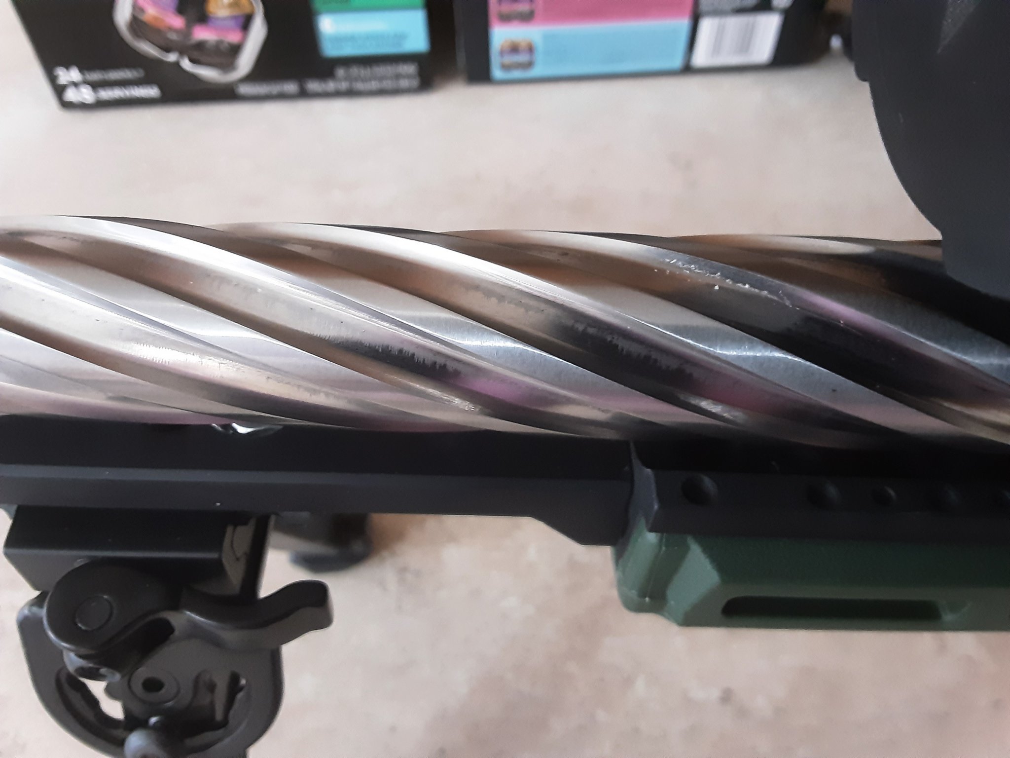

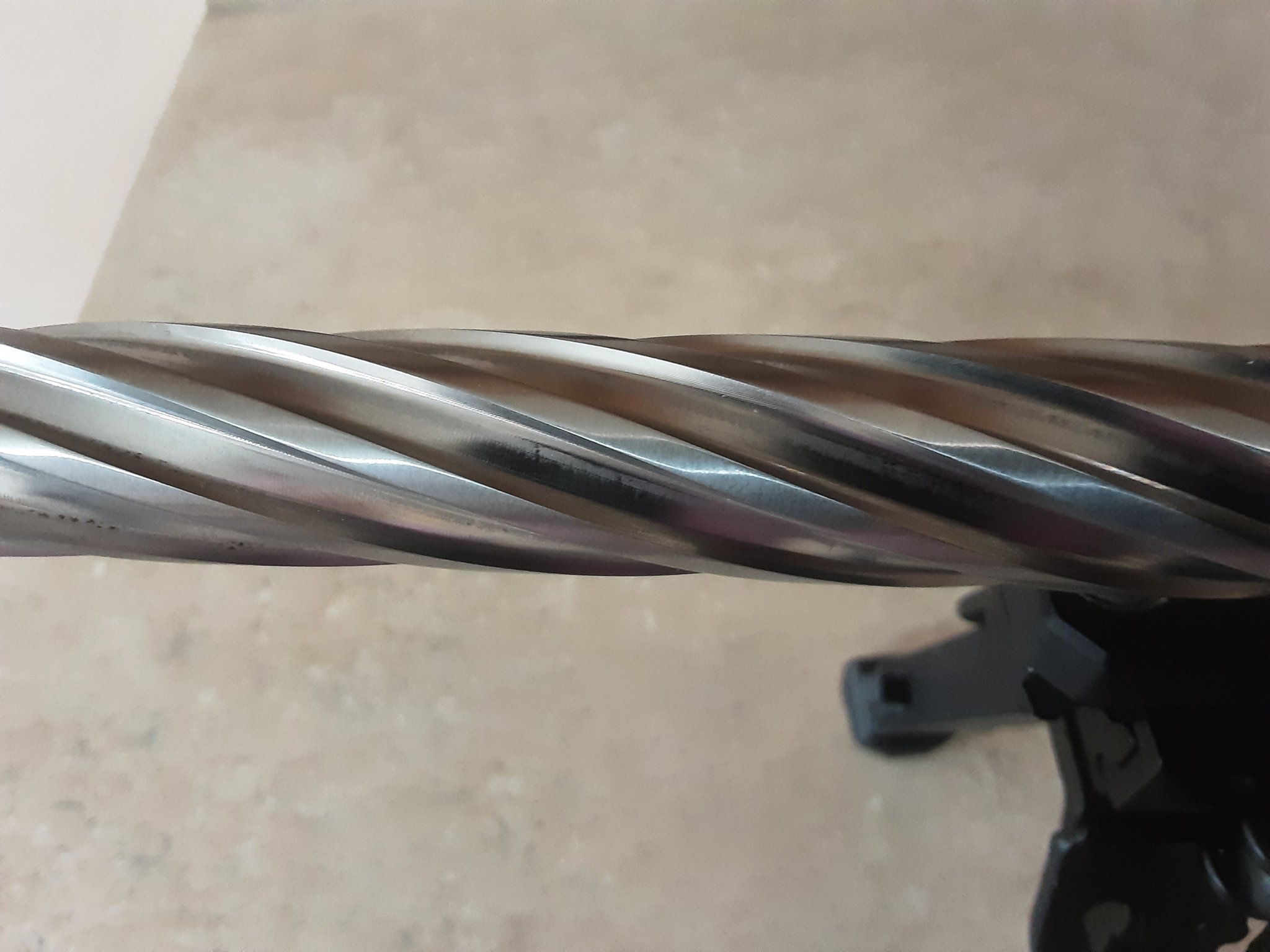

    Hey guys.
    About a week back I receive my Vudoo-V-22.Apparition. I purchased it with a couple of options a Trigger Tech diamond single stage and a fluted barrel.
    I was pretty satisfied when I got the gun. Took it out to the range It shot perfectly .
    But while I was at the range in bright sunlight I noticed that the machined troughs in the Fluting were a bit rough And almost appear to be unfinished .
    This is the 1st rifle I've ever owned with fluting So not sure if it's a common issue. I have not contacted Vudoo gun works about this yet, I am very wary about sending it off for repairs because it took me almost 6 months to receive the rifle in the 1st place and I am not really wanting to wait another 3-4 months for the repair. If this was like a inexpensive Ruger 10/22 I wouldn't be that concerned or that picky but this was Quite a bit of money for me and I expected a little more I guess.
    That's the thing I don't know if it's really a problem or if it's a common machining flaw that you get with a fluted barrel. I'm relying on your guy's knowledge base .

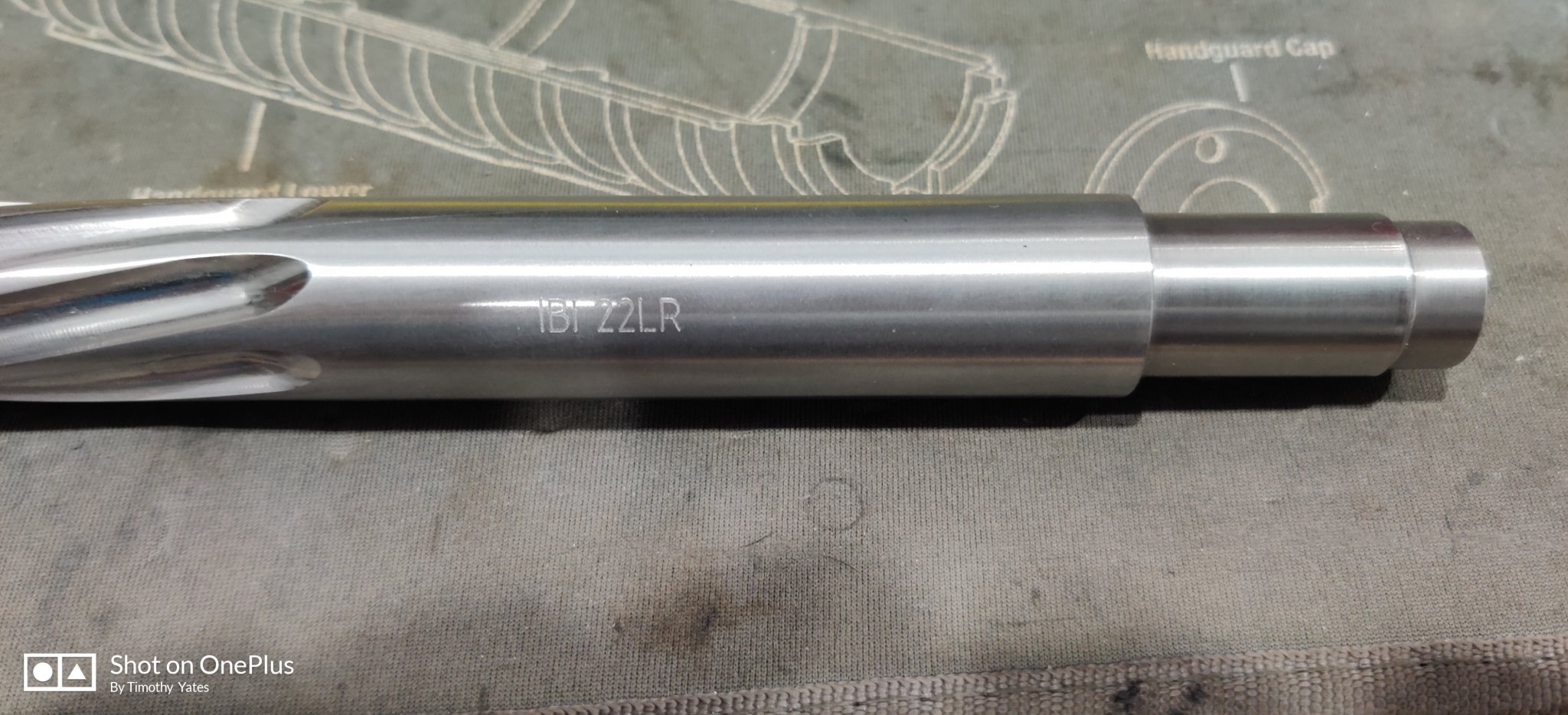

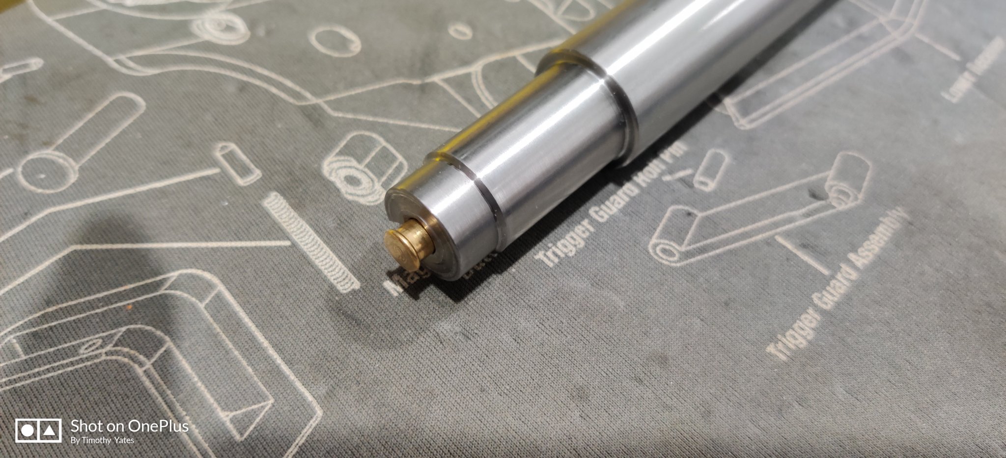

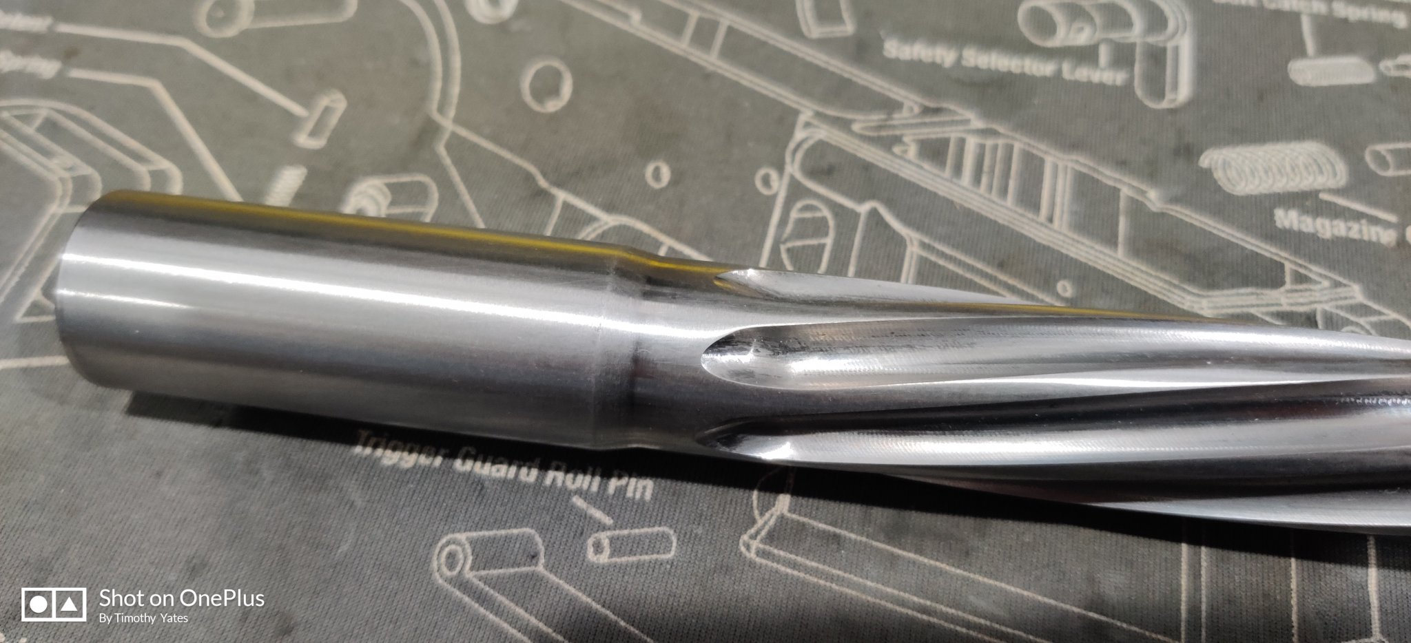

    On par with my fluted IBI barrel. You can see the same clouded areas. Also, for fun the last photo shows how much case is sticking out on my IBI with 52D chamber.

    Talk to Lisa today at vudoo Gun Works she said they would be happy to take a look at it and make it right for me good customer service. So far. I waited six months to get this done I'm hoping the repairs don't take that long.
    A lot of manufacturers have a problem with fluting leaving machining marks. When I need something fluted, I always go to Paul at pro precision rifles because I haven’t seen anyone put a better finish in fluting.
    I would shoot it first, then send it back. I like the flutes bead blasted, then the barrel polished. I had one the flutes painted black, then the barrel polished. good luck.
    Mark
    Sorry Guys, getting back in the mix after a bit of travel.
    @Michael W When one gets a stainless barrel without flutes, the barrel is polished and you won't see what you're seeing. On a fluted barrel that either doesn't get the polish treatment or bead blasted, you'll see tool "rubs" and occasional burrs from the cutter used to flute the barrel. Although not aesthetically pleasing, there's nothing wrong with the overall quality of how the barrel will perform.
    I get it....after a long wait, it's hard to send it back, so if you'd rather not, I can talk you through a few very simple things that will clean it up. If this is a good route for you, reach out via PM and we'll deal with it. If you'd like to send it back, a simple bead blast will make short work of what you're seeing if you want to stay with the stainless finish (but it won't be shiny) and following bead blast, we can Cerakote it if you'd like.
