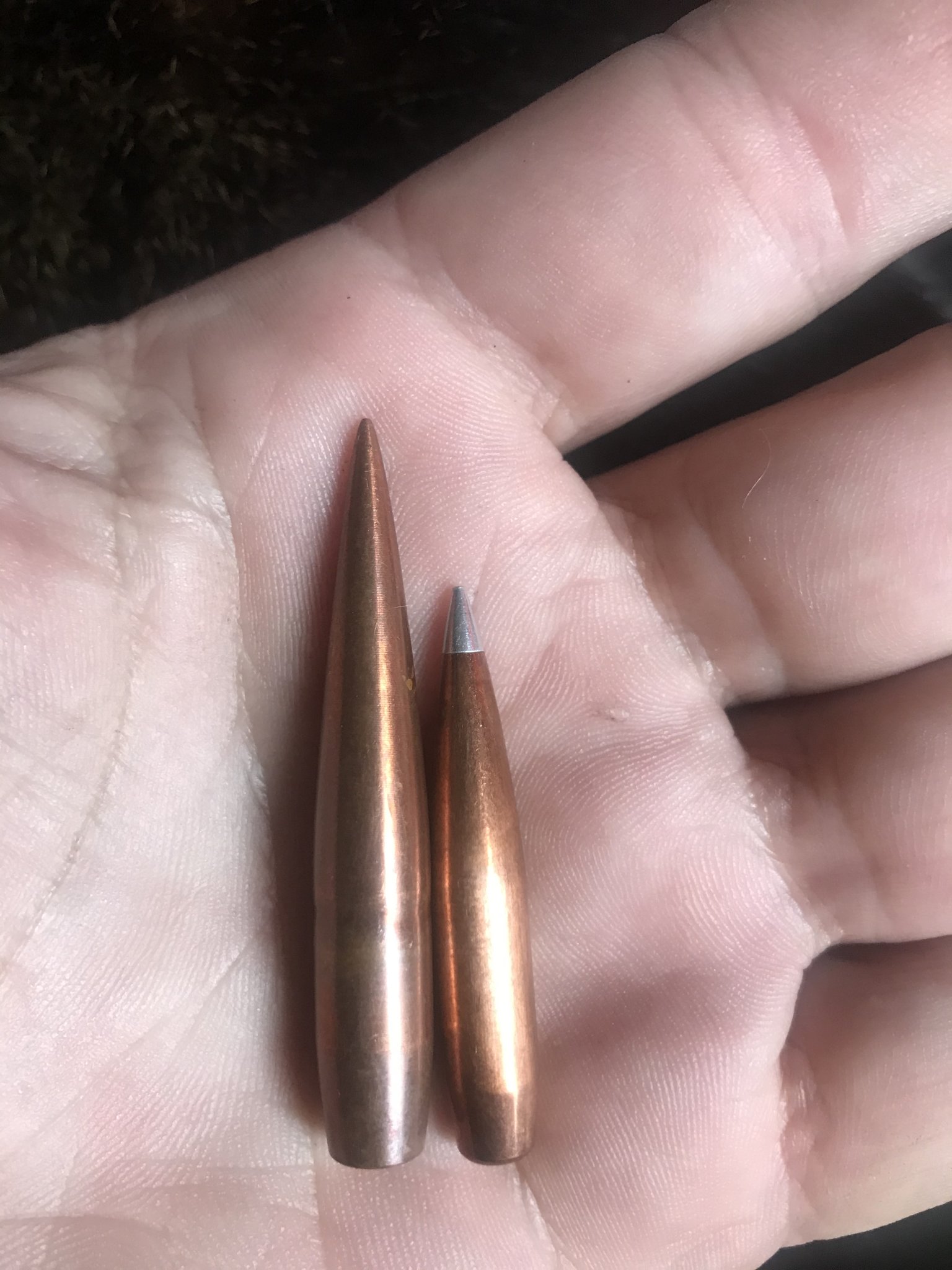

I’m sitting on a few hundred badlands solids.
That’s a 190 a tip for size comparison.
hope to be shooting to shooting them in a week or two.
Barrel for them showed up today :)

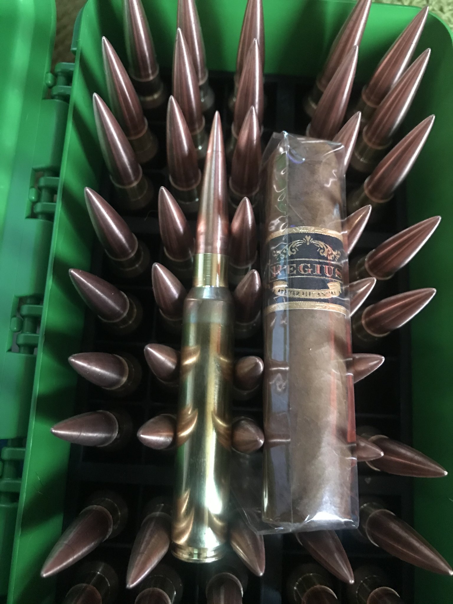

So I’ve been shooting the solids for a bit now.
Can’t say I’m disappointed
A g1 of 1.01 at 3000 fps makes for some impressive performance.
Getting them to shoot was no tougher than Berger’s or SMK’s.
Started at my standard 20 thou jump and that shot plenty well for me.
Spotting has been better than expected but you definitely notice less splash when hitting steel.
That barrel is solids only so I have no clue about mixing bullet types
I generally clean every 50-100 rounds just using wipe out and give it a few hours to work.
Ten or so patches and I’m done.
This thing spanks my friends 338 Norma and lapua.
My 338 Norma buddy quickly got a fast twist barrel for solids out of jealousy but then found he doesn’t the case capacity to really pile in N570 and catch up to me.
Lol
A friendly arms race.
