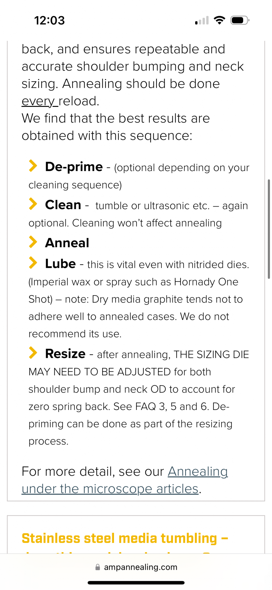

Virgin brass easy fix.
Size it with a wax or wet lube. Graphite dosnt work on the freshly annealed neck.
Dry tumble in some dirty media, ie has some carbon/old lube in it.
Problem solved.
Problem solved.

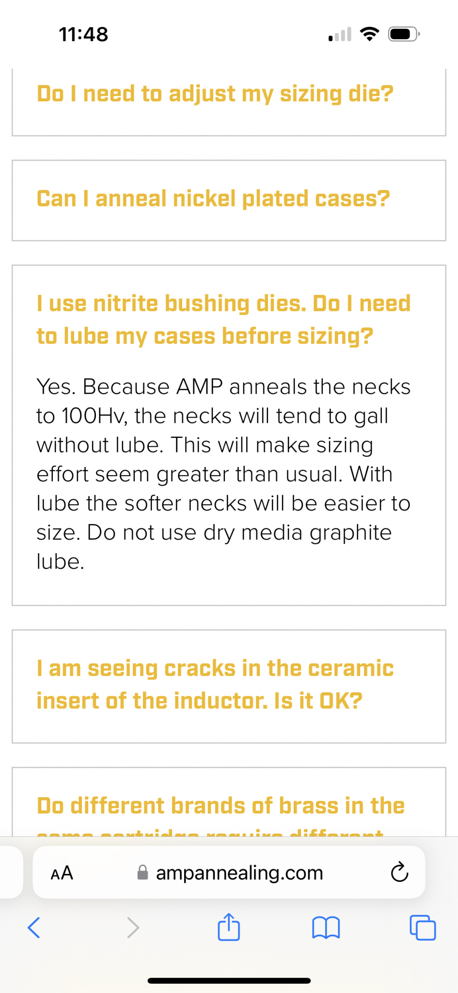

You’ll have to give a pretty good explanation how a coating of graphite between the bullet and neck is somehow negated from previous annealing.
I don’t know if anyone who has had this issue.
I went to community college, so I don’t have anything scientific for you.
I tried dry lube, even a lot, and still got seating force all over the place.
Once I swapped to what I wrote above, Iv had zero problems with stickiness of the brass. Part of it’s the lube, part of its tumbling to knock down that rough feeling you feel post anneal.
Anyways I can’t take all the credit. I noticed galling when I began annealing and went down a rabbit hole on how to make it not happen, that pretty much involved giving up on graphite lube on my necks. I got the idea directly from the AMP faq page, maybe email them and ask about specifics. Here’s a screen shot. Iv found the same goes for the inside and outside of the case.
FWIW, I have used graphite extensively, and, like @Rio Precision Gunworks, I've had no problems with graphite sticking to the case.
HOWEVER...
I read plenty about people having issues and I wanted to try to understand why. The only thing that came to mind was that I must be doing something else differently during case prep. I reviewed my process, and the most likely culprit was how I clean cases. I use Boretech Case Clean in an ultrasonic, then on removal I do a slight rinse and take a bottle brush to the necks to brush out any loose carbon. On one batch of brass, instead of doing a slight rinse, I did an extensive one. I found that graphite did not do as well on that batch of cases.
My theory - and that's all it is at this point - is that the soapy residue left behind by the wet cleaning process enables graphite to "stick" better.
