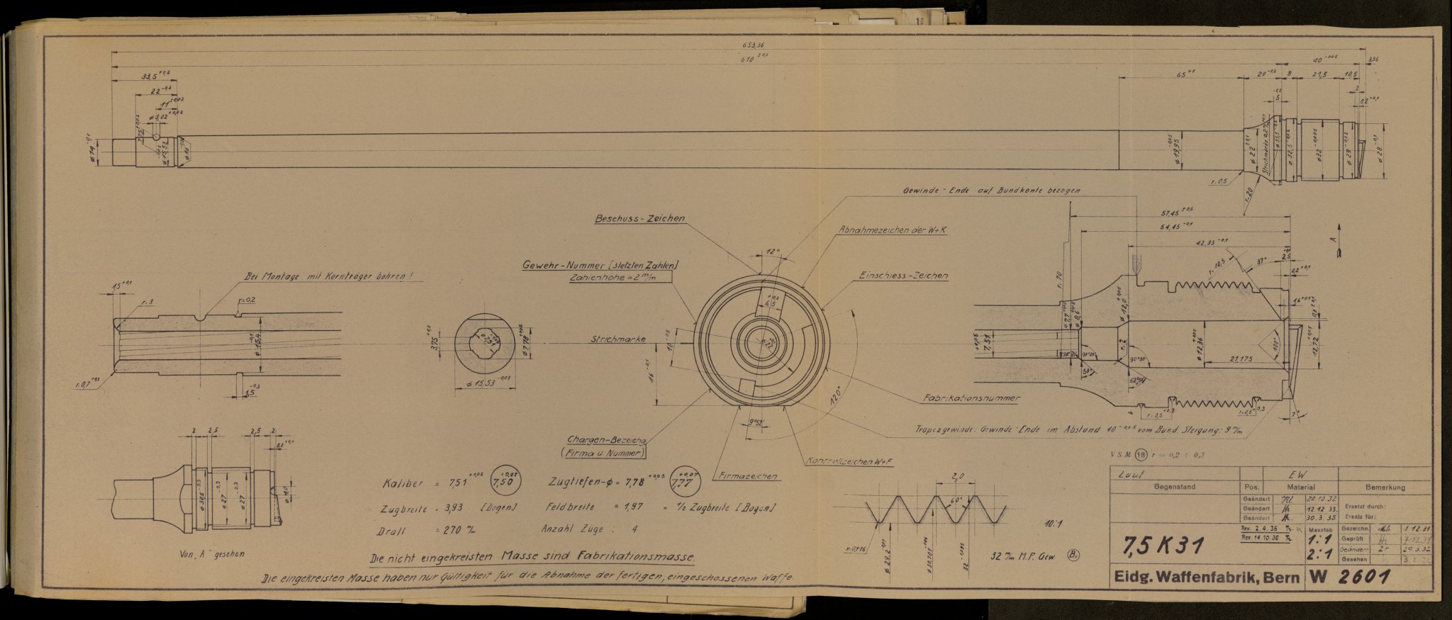

Found the drawings, for those who care. Original Waffenfabrik specs:
Enjoy.

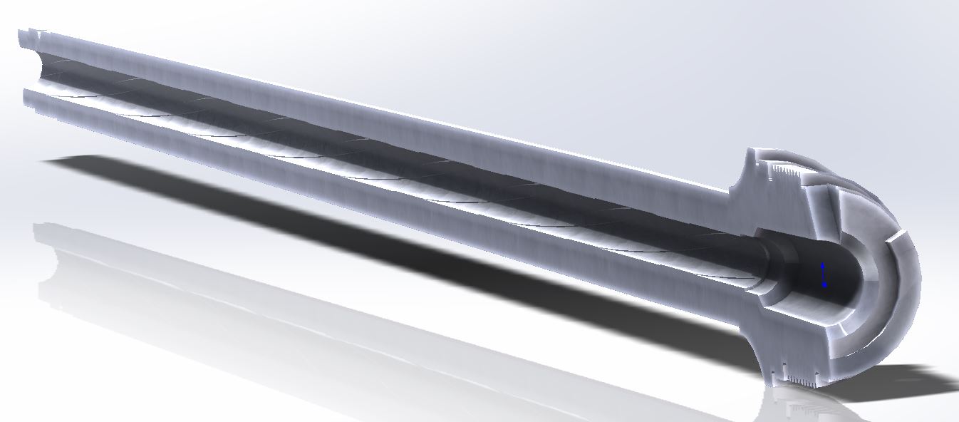

Couldn't help myself... Today's lunch project. I'll likely make and post an "updated" PDF print when I get around to it. That helical cut on the breech face is going to take a 4th axis machine and a 7 degree profile tool but should not be impossible.
Reactions: Davo308 and ptosis

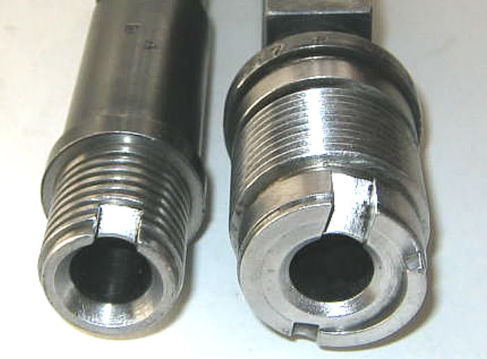

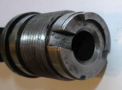

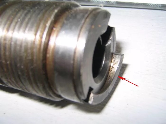

In looking at the original drawing, the area of the shoulder ahead of the tenon relief cut is odd- as in asymmetrical top and bottom (doesn't show that way on the rendering).
WTF is that? Not possible to turn that feature.
Ledzep, look like that that 7˚ helical face for the extraction cam might not have made it into production(?). Here are a few tenon pics stolen from the internet, at least one of which is Guisan's. The cam looks flat. While I can't find any photos of the bolt sleeve lugs, I can 't remember a corresponding 7˚ feature it would articulate with:
Seeing that print in imperial units churns my guts; just a reaction, not a judgement.
View attachment 7481474View attachment 7481475
Considering most here don't have access to metric machines or gages it makes sense.
I know. It just looks wrong. Like a BMW M3 with a pushrod 2V 350SB Chevy. Maybe a better analogy is seeing a Howa barrel tenon spec-ed as Ø1.027"-16.93 TPI instead of M26x1.5. Both ways will get the job done.
It's very subtle looking, even in my rendering. I think it's there in those pictures, too. The print has revisions through the early/mid 30's; well into production so I very much doubt that the feature was left off.

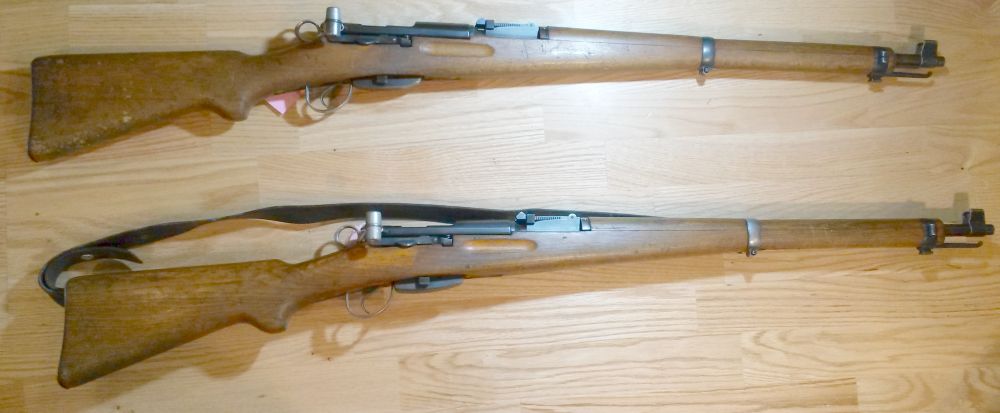

They are great rifles. I've got a pair, one scoped with a brake the other au natural.
I picked up a case of GP11 but no local ranges allow it.
Im hoping to reload for it and on paper, my scoped rifle should get to 800 yards here...

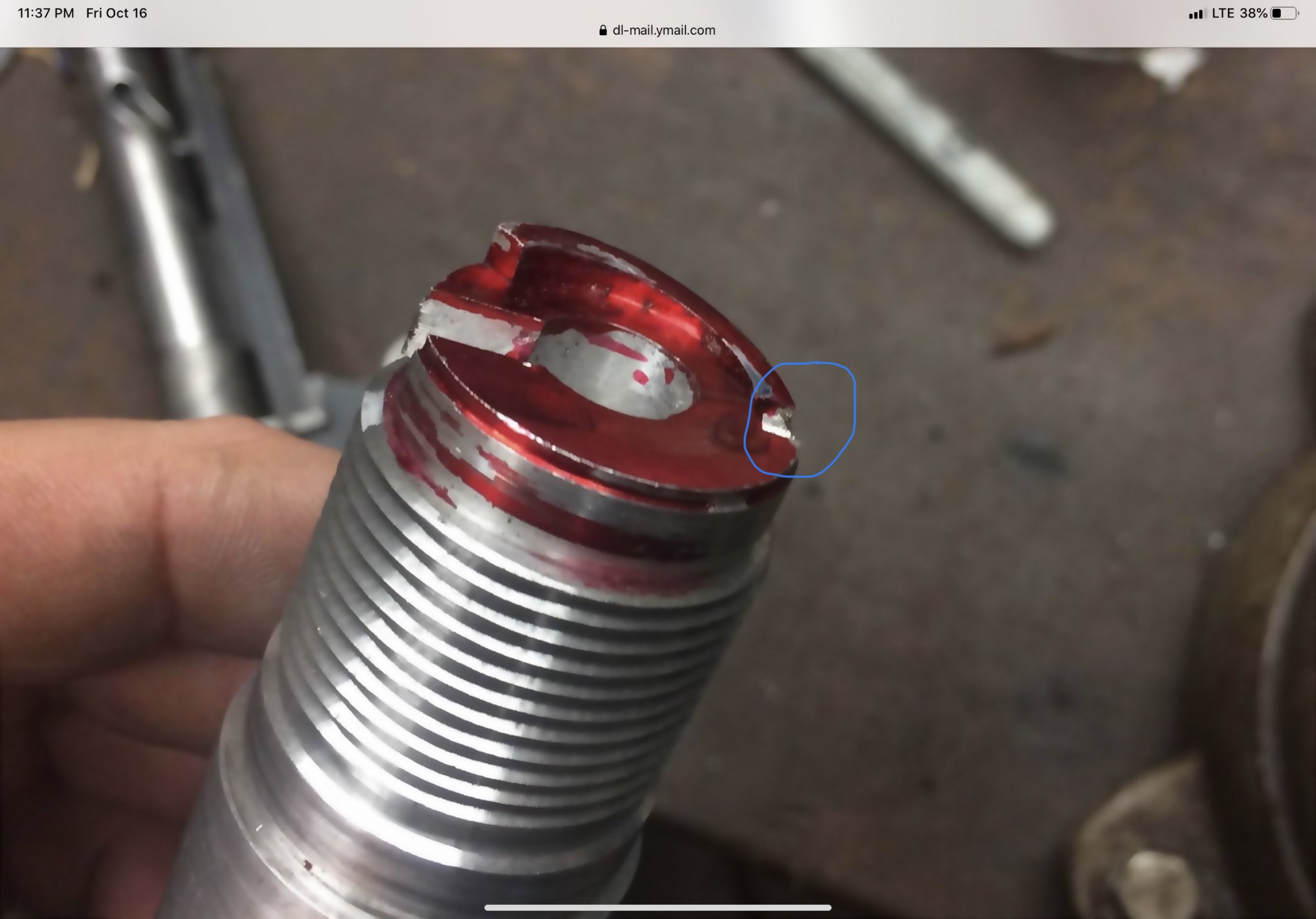

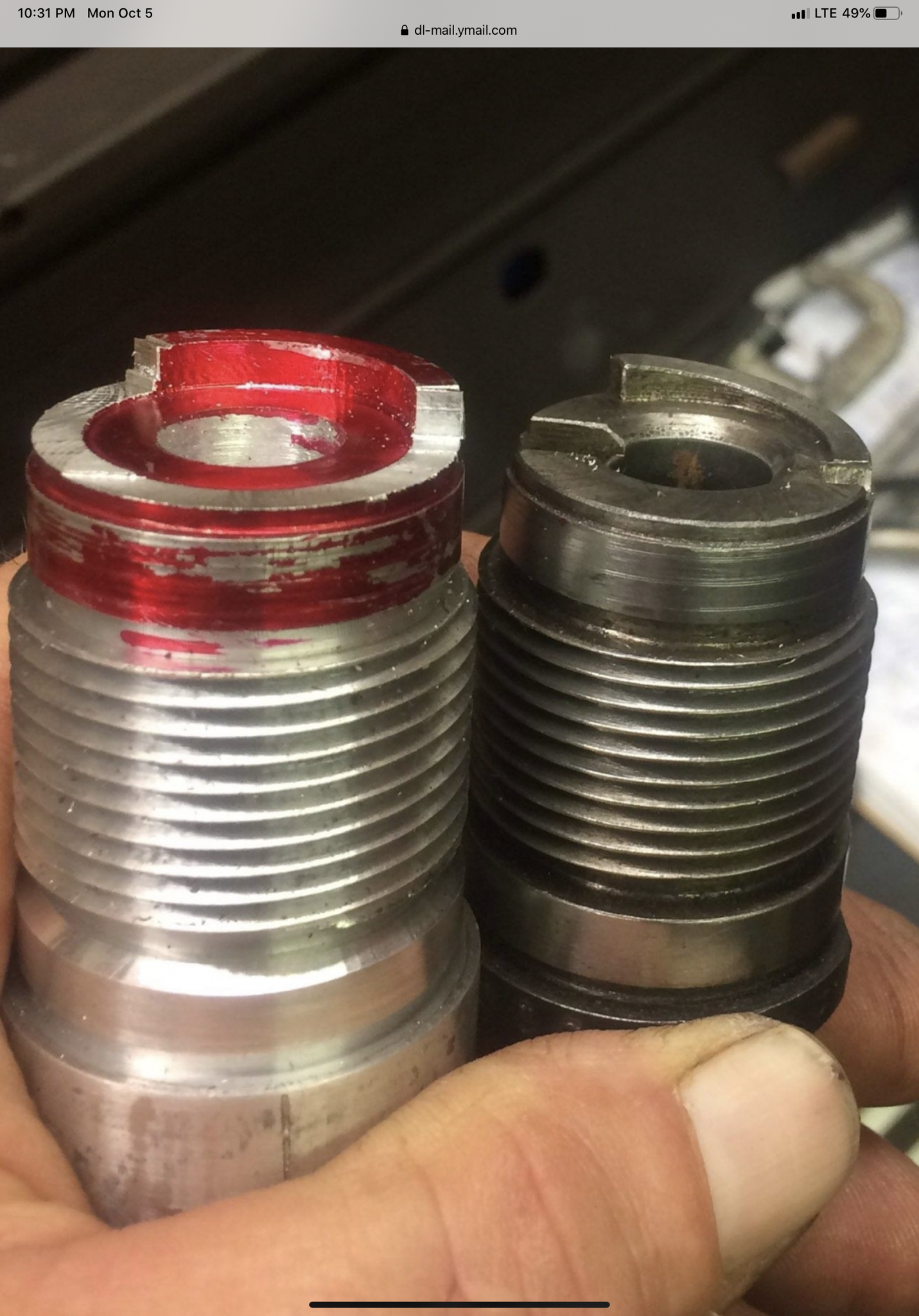

Here is where I am.
The first trial was cut in aluminum and came out perfect.
I have a 30” barrel on order from Krieger. It will be another 4 months!
I want to do a Bench Rest/F-Class type of stock. Having trouble finding someone.
Thanks for those drawings. They will be extremely helpful.

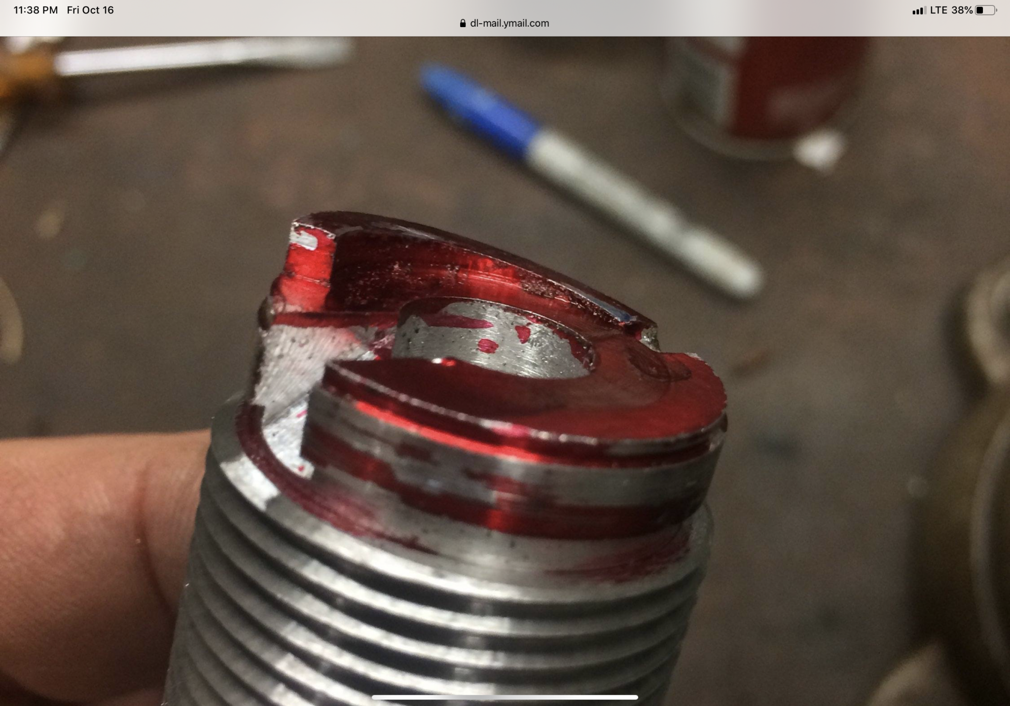

Here is where I am.
Thanks for those drawings. They will be extremely helpful.View attachment 7483940View attachment 7483941View attachment 7483942View attachment 7483943
Curious about how you did it. 90% of machining is problem solving and I’m always interested in how others think and attack the work.
