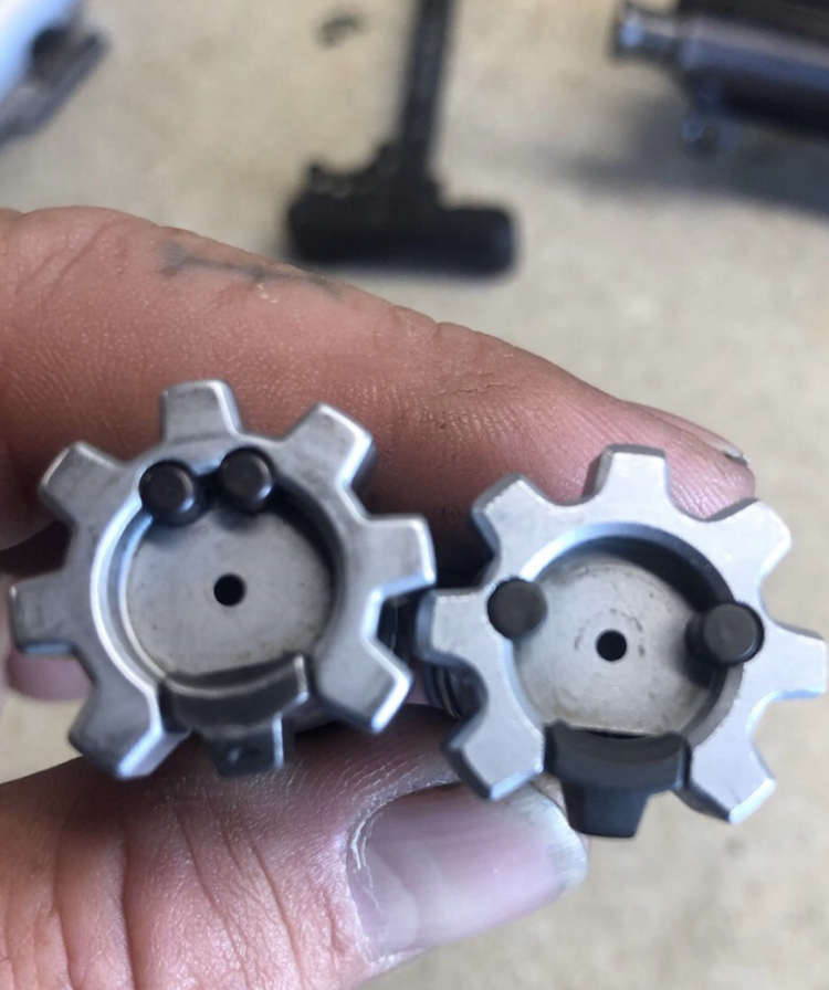

    Picked up a BCG for my LMT MWS. Turns out it’s a KAC e2 bolt in an LMT Carrier. Ran it in 2 different uppers and 2 barrels (dry no rounds) and when the bolt is sent home too hard, it jams up to the point I gotta whack the charging handle to get it to move release. Not binding up in the gas tube / key. Now it’s got me wondering if the KAC bolt in an LMT carrier in an LMT upper / barrel extension is compatible.
    mom assuming this habeen tried before. Anyone have any experience with this?
    thanks in advance
    thanks in advance
    The headspace may be tight.
    Reactions: HogsLife
    Carrier/bolt interface should not be an issue. I was not aware KAC bolt would work with LMT BARREL extension?
    KAC bolts and barrel extensions are proprietary.
    You may very well be right. KAC bolt in LMT carrier so long as it’s in a KAC barrel and Vice versa? May very well be the case. That KAC bolt doesn’t seem to like the LMT barrel
    I'd find a buyer for the KAC bolt and then buy a LMT bolt. You'd probably generate some cash by doing this, the LMT 308 bolt is great, no reason to run a KAC bolt over a LMT bolt for your MWS.
    Reactions: HogsLife
    Well got the LMT bolt in the mail today and it’s obvious now with them next to each other. KAC E2 on left and LMT on right. You can see the difference in the lug design on the LMT.
