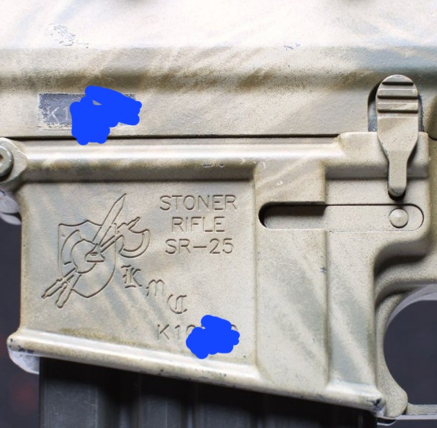

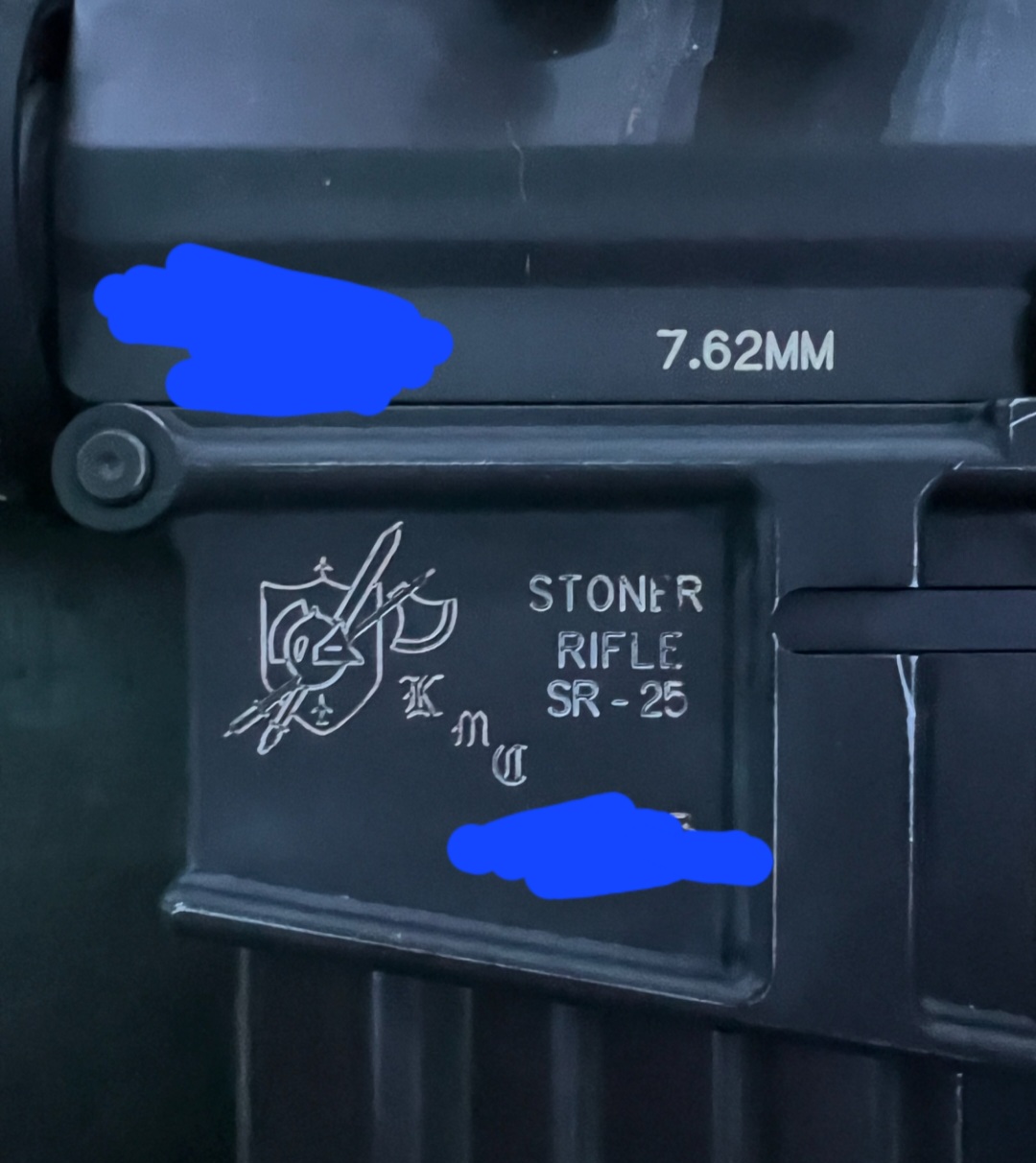

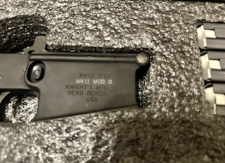

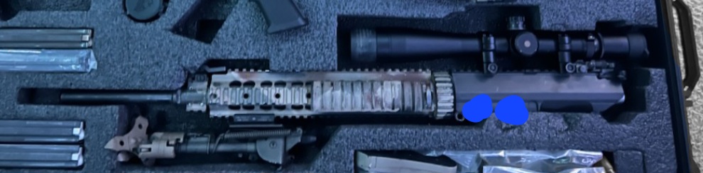

Hi Kevin, I have seen a few Sr25 Vero issued as mk11 mod 0 from 93. No prefix on SN.
Then I notice K was prefixed.
Then in 2000s, mk11 mod 0 was placed on the receiver.
Is this correct?
Thamk you.
