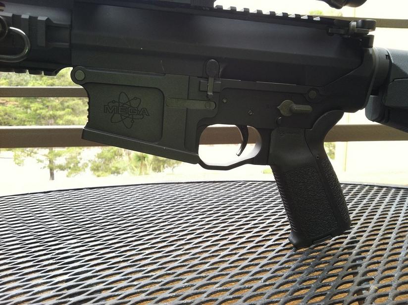

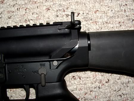

Well I should say its some what true.. Its sorta like the AR-10 upper on the DPMS lower , but not as bad. You would have to drill out the holes on the MAten upper and maybe machine the bottom of the receiver a bit. The AR-10 is a perfect fit in terms of rear cut. The LMT / KAC have a bigger diameter pin of .284 vs 271 for the DPMS and .278 for the Armalite. I can tell you that my MATEN upper would prob function, but that gap at the buffer tube would drive me nuts. I know that SR-25 upper fits sorta ok on the mega lower, but its a bit loose since the pin holes are bigger and the pivot points are a bit narrower.
Thank you, this is great info! I had been toying with the idea of getting a MATEN upper for my Larue lower because I really want to build something in a different caliber, maybe 260 of 6.5CM, without needing to buy an entire rifle. Thanks for the pictures, that really helps clear it up for me. Nice rifles, btw, sounds like you have quite a stable!
Thanks, the rifles in the pictures are not mine :/(otherwise I wouldn't be looking for the SR-25 upper). I am working at building up my stable. Since the LaRue is cut the same as Knights and LMT. I would say it would be easier to get the AR-10A upper .
