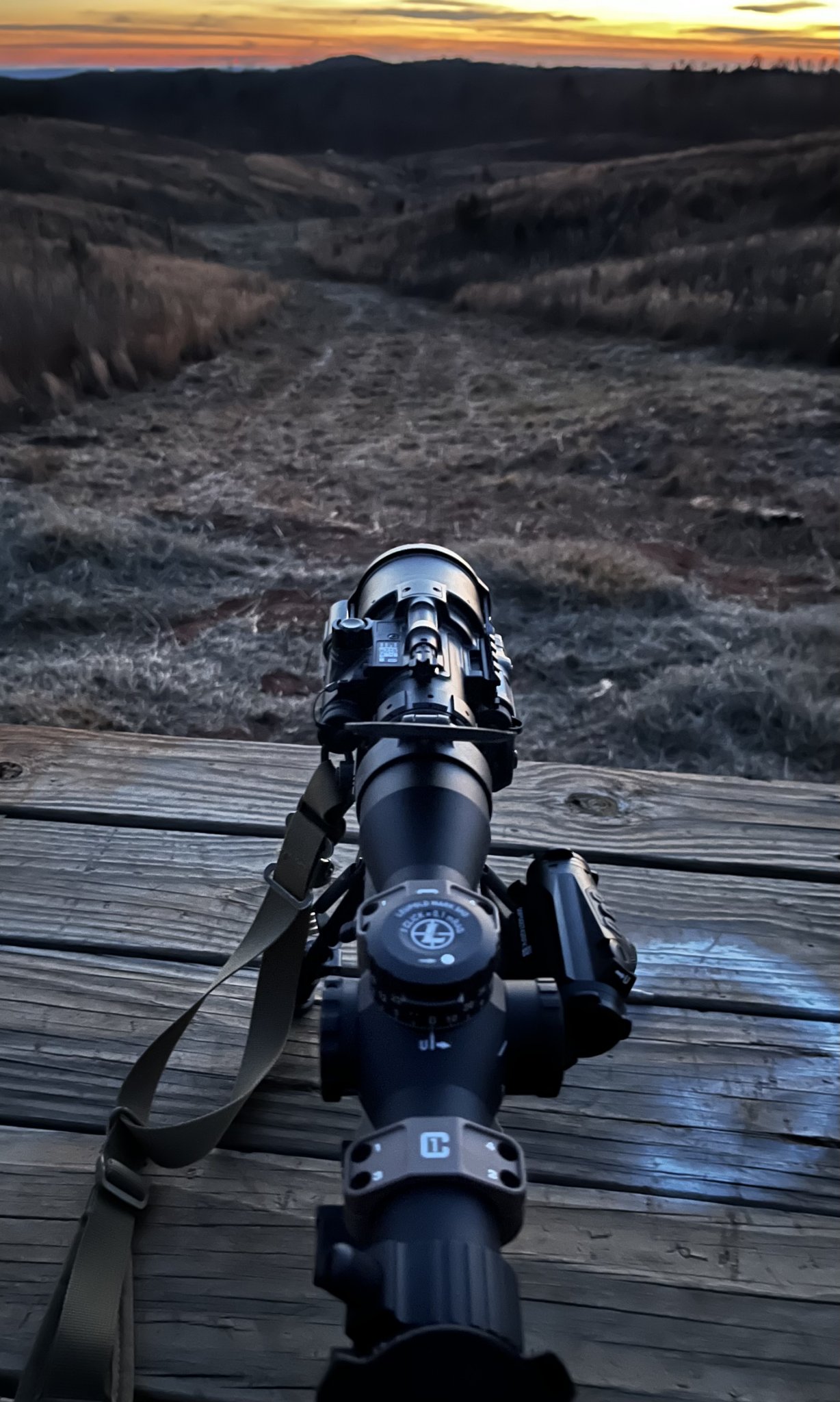

Couple responses to above post:
CLIP NV is an Elbit tube, comes with full spec sheet.
CLIP NV is .5lbs heavier than UNS A3.
Lens on the CLIP NV is larger. Reminds me of an updated PVS22.
Spent more time behind the CLIP NV tonight at the 800M range and 1 Mile range. To my surprise on the 1 Mile range, I could resolve medium to large size steel targets at 1,025M and 1 mile both with and without the PEQ15 illuminator on high. Image was much better with the Illuminator on. Lots of performance in a tight package. Really nice fit on an SPR.
Sunset Picture on 800M Range
