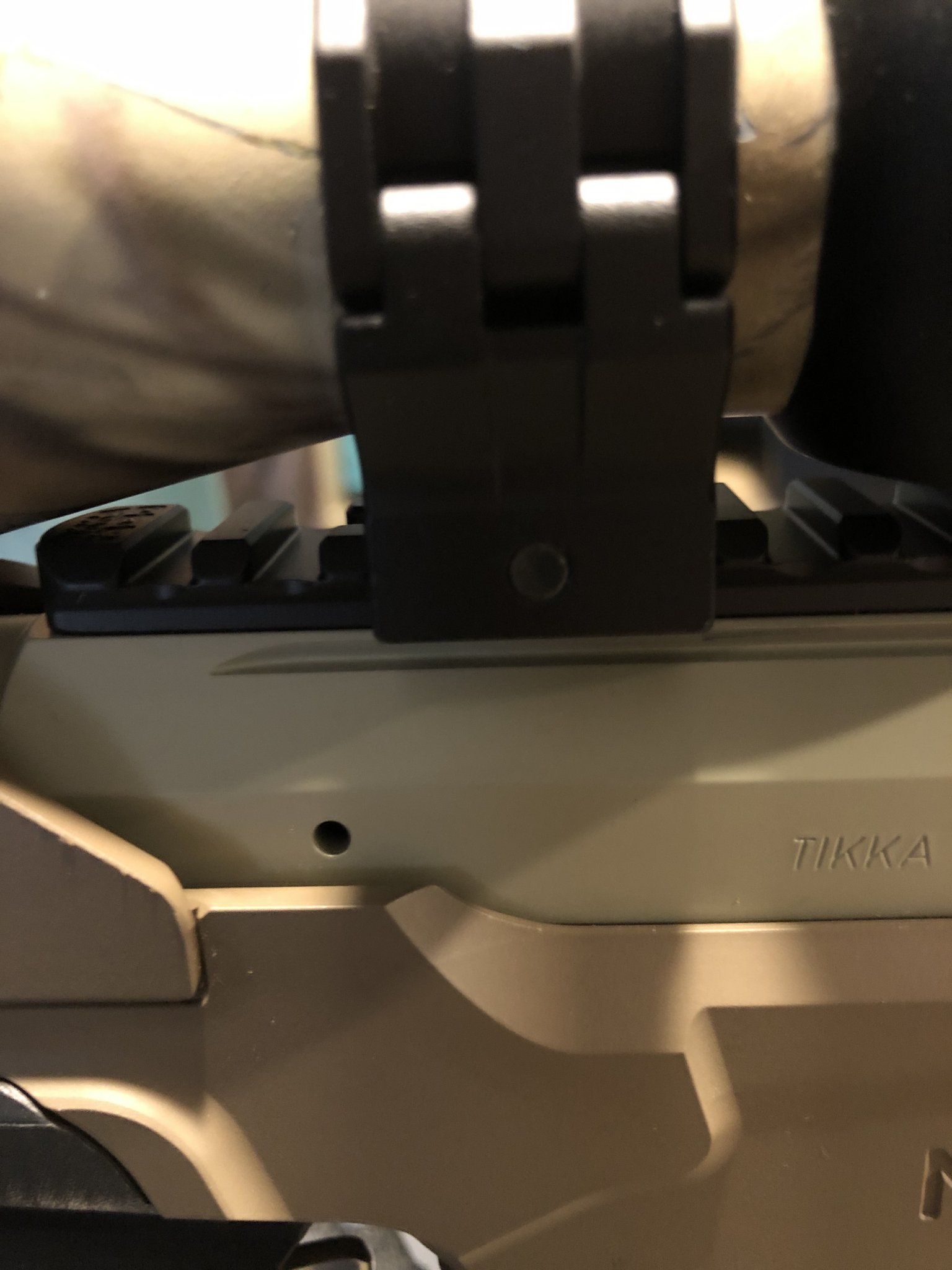

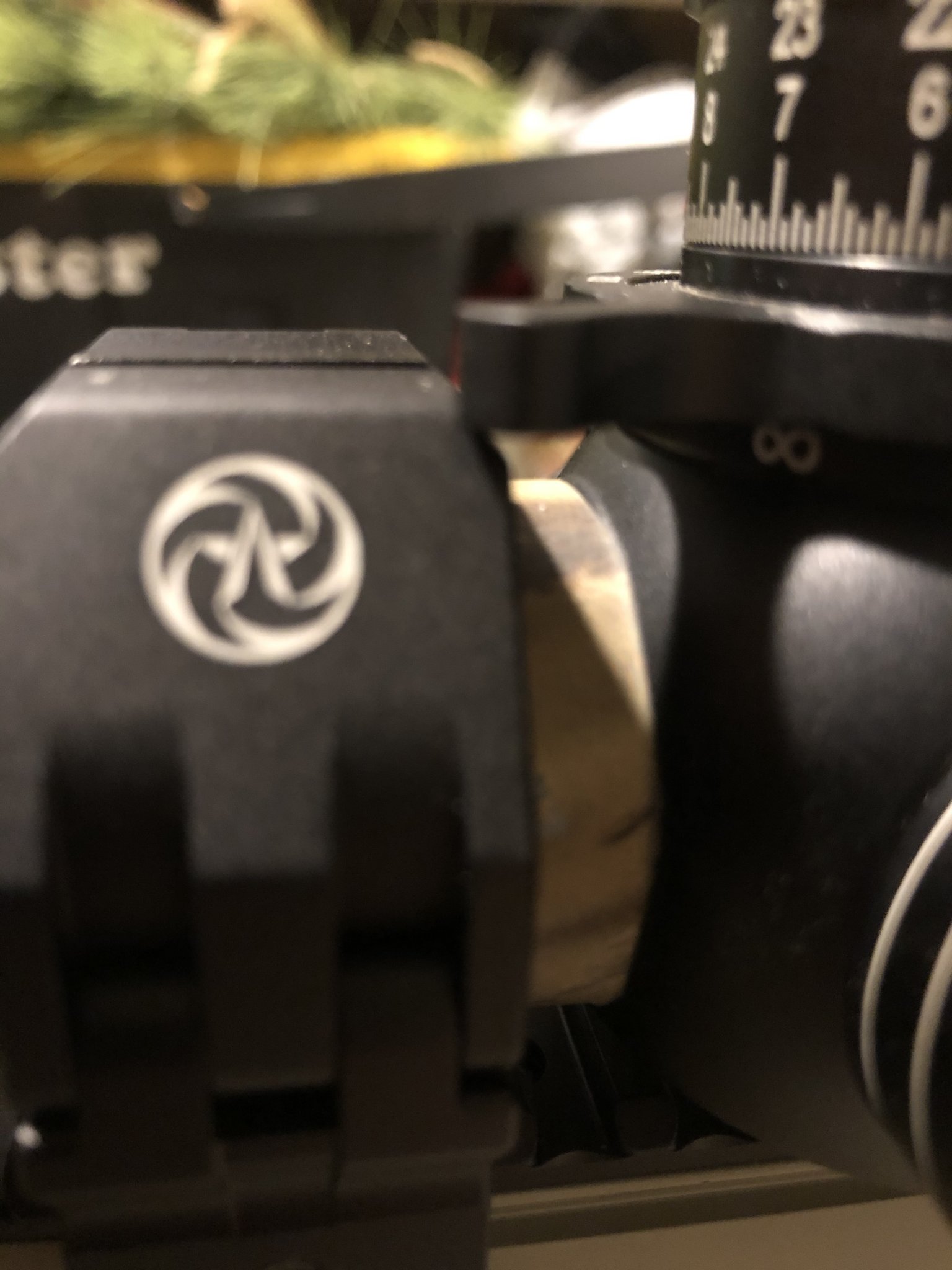

Went to mount my K318 tonight and run into a problem. The parallax adjustment wheel hits the top of the front ring. Anyone else run into this and have a good fix .
That looks like a throw lever on the adjustment wheel, is that correct? I take it you are unable to shift the ring or scope position. Arc rings are higher on top due to their single bolt design, if removing the throw lever or moving ring/scope are not an option I think you’ll need to look at different rings. I had my Kahles K318i in a set of ERATAC QD rings, not mount but actual rings and they are lower on the top. Spuhr should work as well.
Ah yeah....you need a throw lever on a parallax wheel? Take it off and chuck it...no?
As far as I can tell, while the parallax wheel is crenelated but doesn't have a fixed in place throw lever from the factory. Did you buy this used or....???
Throw lever comes on it new. I did buy it used. I took it of to make it work. I got use to adjusting it with the lever on it and really like it was hoping to keep it.
I thought about heating it up and bending it but decided not to.
Like was mentioned... You can either grind that one off, remove the horizontal ring on the turret, or get you a different set of rings that aren't so fat and take up so much real estate on the tube.
Maybe screw the rear ring to 110in-lb's so you don't need the front ring?
On a serious side you might take a file or belt sander to clearance the corner of the ring. Other then that you need different rings.
