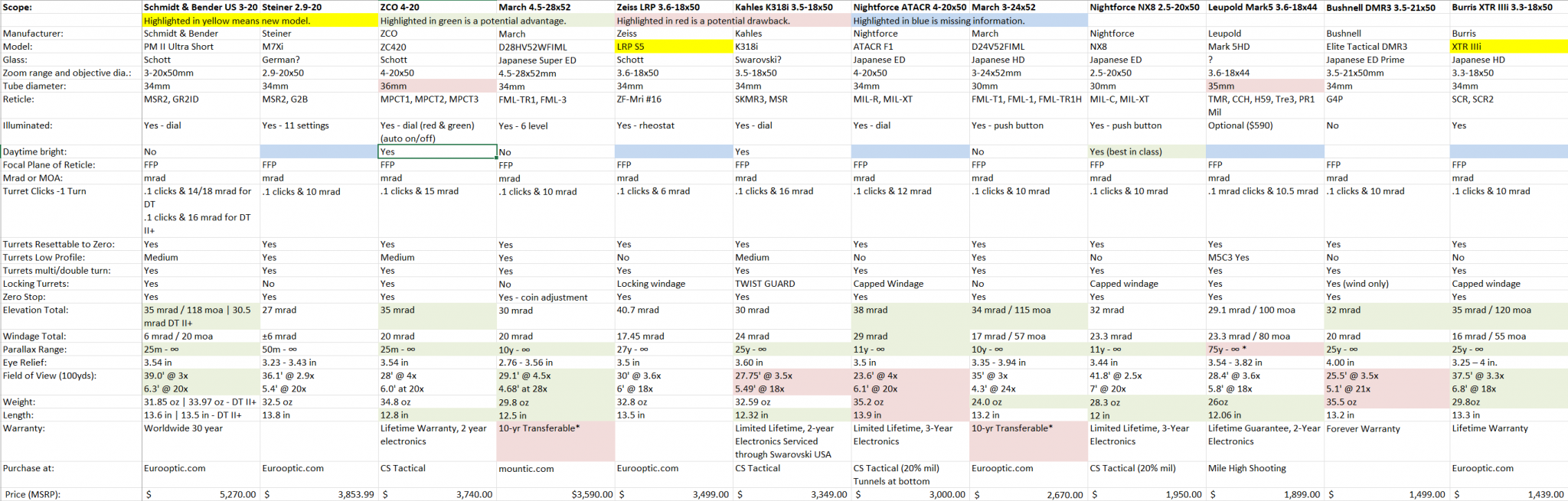

    For those who might be interested, here is my latest spreadsheet for Ultra Shorts in the 3-18/4-20 range (March 4.5-28 is in here because it has better FOV than most 4-20 scopes), ordered from left to right by MSRP

    Excellent table. Does anyone have experience with the March 3-24? Curious how it does against the others in the list.
    I do, they are really good 3-20 scopes, IQ falls off above 20x, with the new FML-TR1H reticle they are compelling at 3x. I have a review coming comparing to NF NX8 2.5-20 and SB 3-27. I would not put the March in the same class as Kahles and ZCO IQ wise, but they are light weight and fairly short which gives them appeal.
