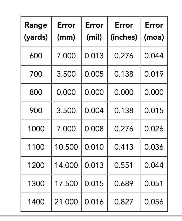

Yeh the error between 600 and 1400 is pretty darn minimal - This is with the parallax set at 800.
But for rimfire, it's pretty insane the amount of error you get if you're not changing parallax from shooting something at 30y vs 100y.
