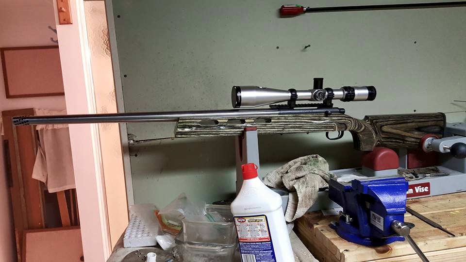

Remington 700 30-06 bedded in a boyds stock. My very first time shooting over a chronograph. I'd read horror stories of people shooting the chrony and I was nervous. The chrony belonged to my shooting buddy who told me he'd take care of it. He set it up using a laser bore sighter to make sure it was perfectly aligned. I thought he took the bore sighter out. He thought I took it out. A 178gr Hornady Amax took it out...
I figured go big or go home. Sent the action to my smith to be blueprinted and have a new shilen barrel put on, this time in 308. New stock, Jewell BR trigger, new base, new scope... Makes a pretty decent prairie dog rifle at 600 yds when the wind is strong.
