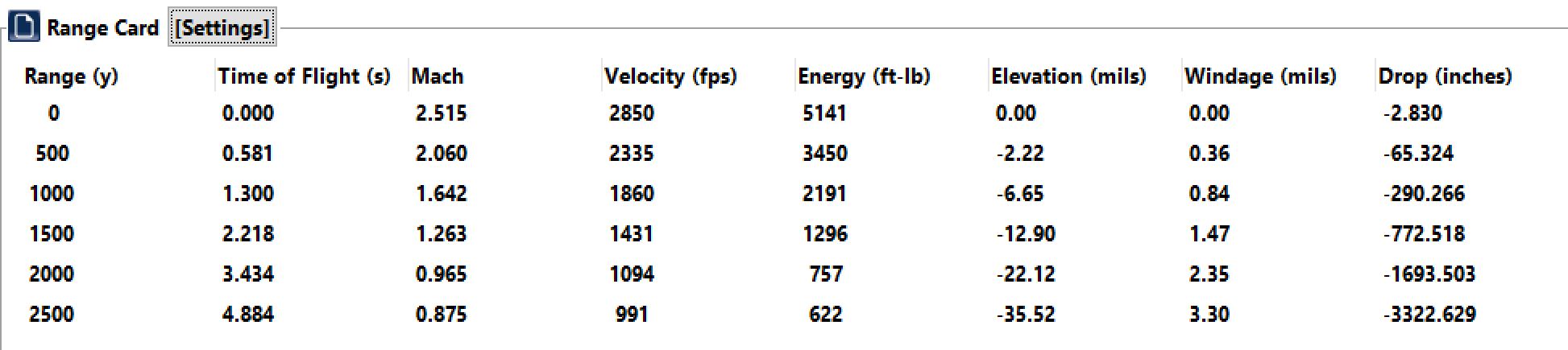

    Below are a comparison of three solving engines I have access to and their recommended elevation adjustments at 500 yrd intervals out to 2500 yards. The Kestral AB (non elite) seems to track right along pretty well with Trasol up to 2000 yards. Id like to determine for this bullet how much the Kestrel Elite version might close or open the gap with TRASOL out at 2500 yards. Trying to determine what the upgrade to the elite model will net just from the performance of the solver.
    Could someone with a Kestel Elite please reply with that solvers elevation adjustment at 2500 yards with the Hornady ELD-M 285 data out of the bullet library? That one number is all I need. Please also list the Gun and Environment variables you used for the solution if you don't use mine listed below. Also I've got the wind zero'd out and firing azimuth at 0 degrees.

    500 yd 1000 1500 2000 2500​
    Elevation in mil
    Hornady 4DOF -----> +2.1 +6.44 +12.5 +21.37 +34.4
    Kestrl AB (not elite)-> +2.17 +6.64 +12.91 +22.05 +35.4
    Trasol -------------------> 2.17 +6.68 +13.09 +22.51 +36.41

    Here you go, this is using the Custom Drag Model.
    Thanks Doc, that is pretty close too but I imagine looking at this from a single set of input variables doesn't paint the entire picture, plus all the other added features, so I am going to go ahead and perform the upgrade. Its great that an upgrade path is available.
