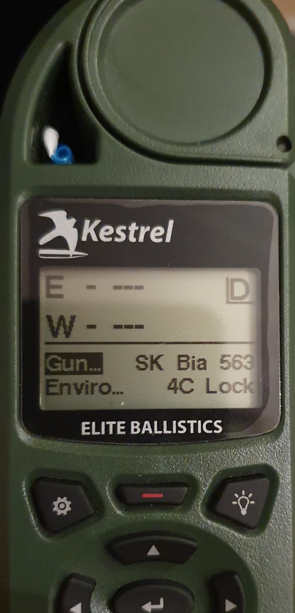

    I updated my 5700AB to 1.35 almost immediately when it came.
    Today I was setting up my profiles when suddenly Kestrel frozen and stopped showing dials. Before freezing I changed the zero height from -3.2mil to 3.2mil.

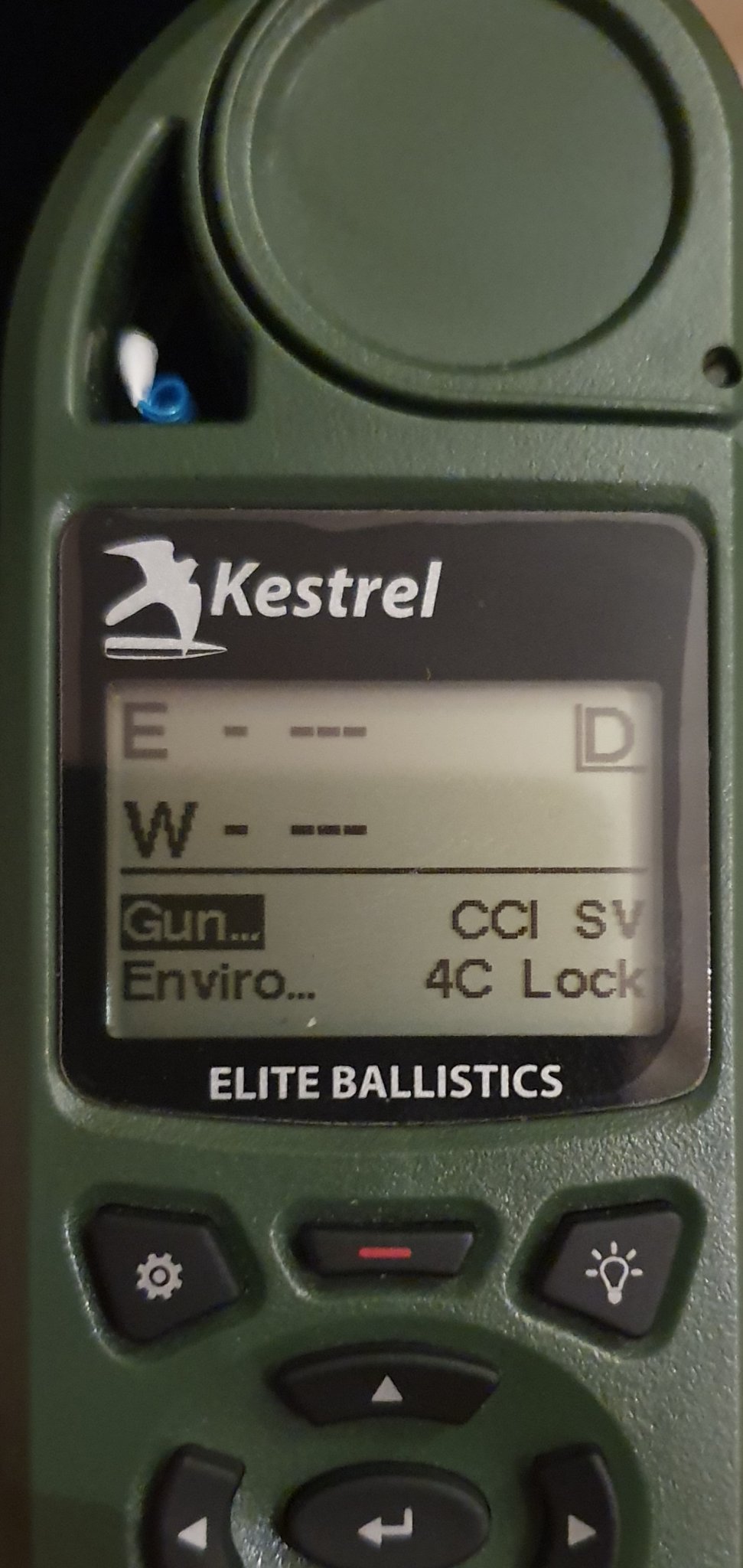

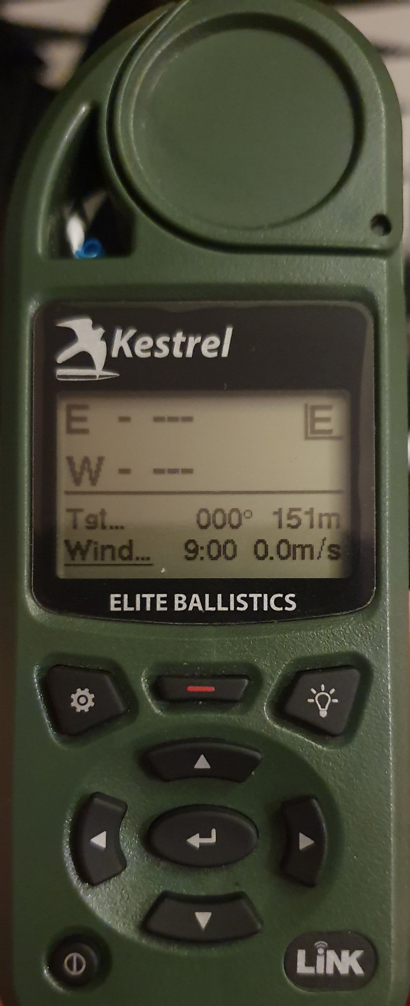

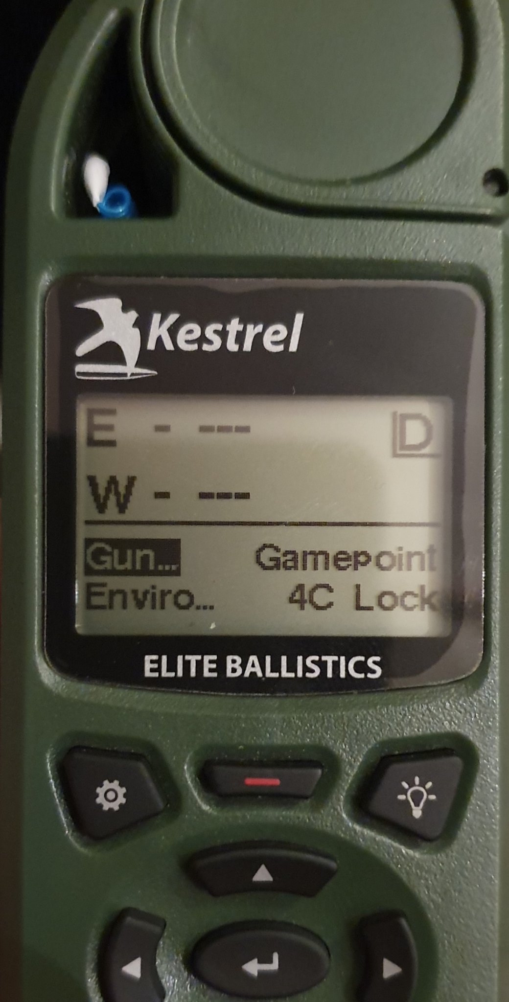

    I went through all of my profiles, and none of them showed anything.

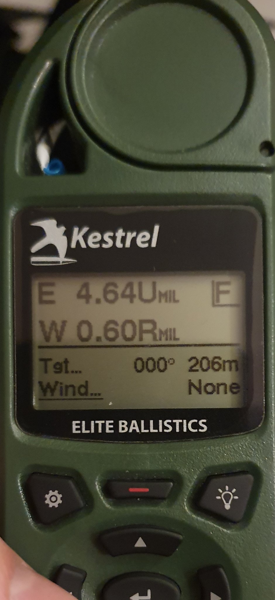

    After browsing through them with different targets, it finally showed the dial for 206m.
    But still nothing else.
    After that, I powered it off and back on again. It worked from there on.
    Has anyone else seen this kind of behaviour?
