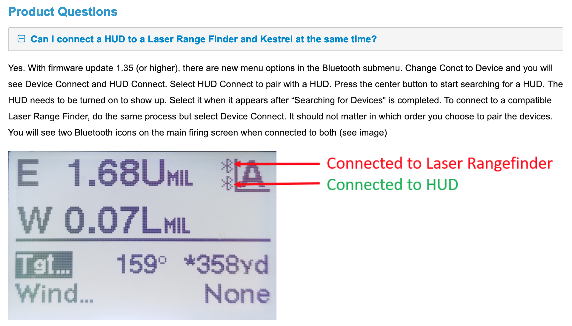

I currently own the Kestrel 5700 Elite and the Terrapin X. I'm very happy with the setup and find it to be incredibly useful. The Kestrel HUD looks interesting and I'm trying to get more information about the device.
I'd like to range on the Terrapin X and have the ballistics automatically update on the Kestrel HUD. One big question though, the Terrapin X is linked to the Kestrel 5700 and then does it link to the HUD?
I'm having trouble researching this on the web and hope someone either has the answer to this question, or possibly has this exact setup already.
Thanks
The HUD mirrors what the kestrel receives. So in theory, when you range with the Terrapin and it sends that to the Kestrel, it should display on the HUD simultaneously. But don’t take that as gospel, confirm with Kestrel themselves, they are a great company.

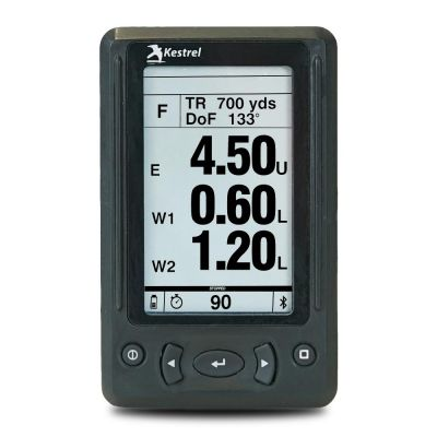

Is there an option to have base wind speed displayed in the HUD via real-time update from the Kestrel 5700? Looking for an option where I can see/know wind speed without having to lift my face off the gun.
If I am understanding your question correctly, you would like real-time wind DISPLAYED on the HUD. This is not an option yet that I know of. If anyone else knows anything different, please enlighten us.
Reactions: Mr Flannel
Yes, place the 5700 in the wind vane and leave wind acquisition on and the Kestrel will update the HUD, there is some communication time so it may not be instant, but close.

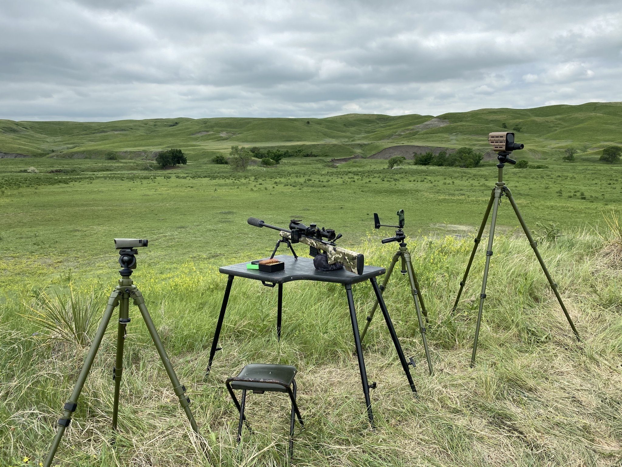

I'm back from SD and can report that the Kestrel 5700 mounted in a wind vane + HUD + Terrapin worked flawlessly for my one buddy. The update time for the HUD after lasing a target with the Terrapin was less than 10 sec. In addition to providing target distance the Terrapin also includes direction of target/fire which is quite critical when dealing with steady 10-15mph winds.
As for the Kestrel 5700 it worked flawlessly mounted up in the wind vane providing real time data. Battery life was better than I was expecting, clocking in around at 15-16 hours while connected to a LRF, HUD, while feeding continuous wind data and plotting hundreds of firing solutions on PDogs.
I would like to thank whomever at Kestrel had the foresight to enable user editable range values via the buttons! It was a life saver for me when my LRF would routinely not communicate well with the Kestrel. I'm 100% certain it's a LRF issue NOT a Kestrel issue. Overall, my buddy's experience with the Terrapin was much better than mine using the Bushnell Nitro 1800 which always had to be "woken up", then reestablish the Kestrel connection, then update the HUD with firing solution.
Overall we were both extremely pleased with the 5700's performance in the wind vane and HUD integration!!
Picture of his setup below:
What spotting scope is that?
It's a Leupold Mark 4 Inverted H-32 model mounted in a Kinetic development group Optics Hub that is mounted upside down to the tripod via a Magpul M-Lok tripod adapter. Due to the inverted reticle and the stud hole being in the normal spot, we had to get creative for a mounting solution!!
