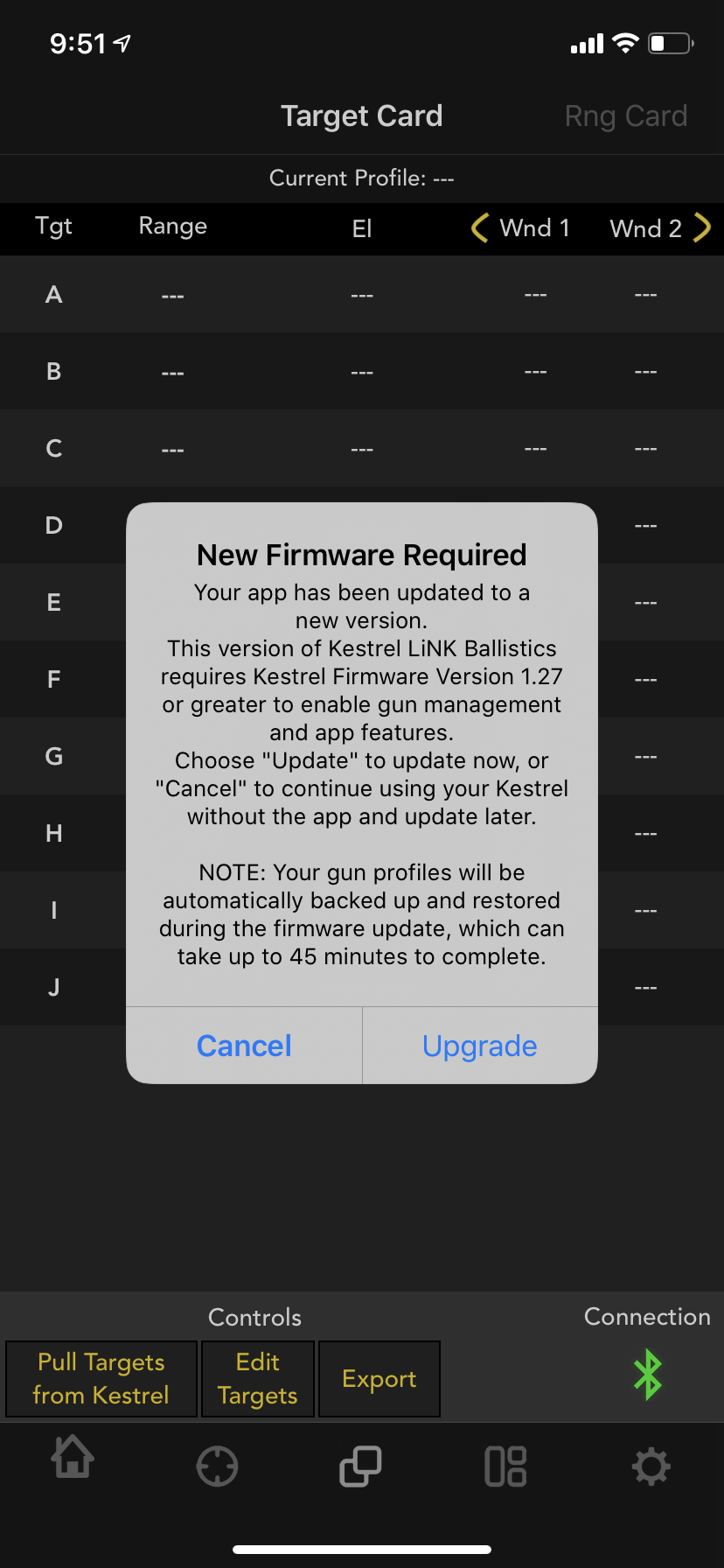

Hello all,

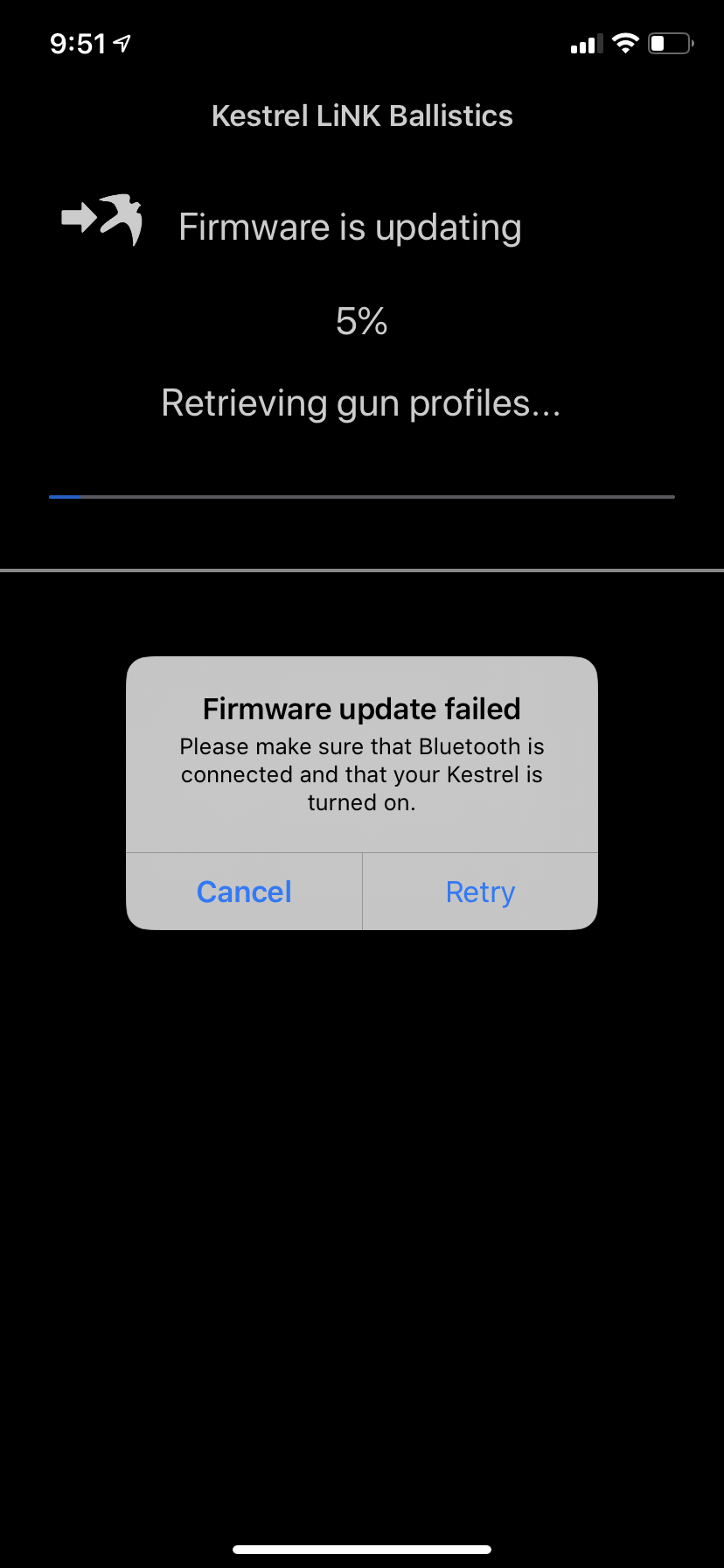

I have had my kestrel for 2 years and haven’t done an update in a while. It’s a 5700 kestrel with Link running firmware rev 1.15. I am trying to update from an iPhone 11 through the “Kestrel LiNK Ballistics”. The app wants to update to rev 1.27 which is a big jump. I am hoping I’m not too far out of date to get this done. Below are two screen shots of the messages I receive. The first is to acknowledge the update need, and the second is the error I get. When I watch the kestrel I see the Bluetooth sign or watch on setting and see it has a connected status. Until about 5% and retrieving gun profiles, it loses connection.
I haven’t seen any discussions around this. Please send help!

i tried what you said and had no luck. I tried wifi only, cell data only, both, restarted phone and restarted kestre. It’s not going any further. Thanks for your quick reply.
Few things I always do is close out all other apps, put my phone in airplane mode then manually turn on wifi and bluetooth only, make sure the phone is plugged into a charger. If you have a secondary or backup ios device like another phone or ipad you could try dumping your saved rifle profiles on one of them then delete the profiles on the Kestrel also after that you could try doing a factory reset on the Kestrel then try updating the firmware. I have noticed that when I don't have any saved rifle profiles on the Kestrel the updates seem to go a lot quicker........Good Luck!
Factory reset was the trick! It only took 25 minutes following the rest of your suggestions as well. Has anyone had it prohibit updates because the kestrel didn’t have enough battery?
