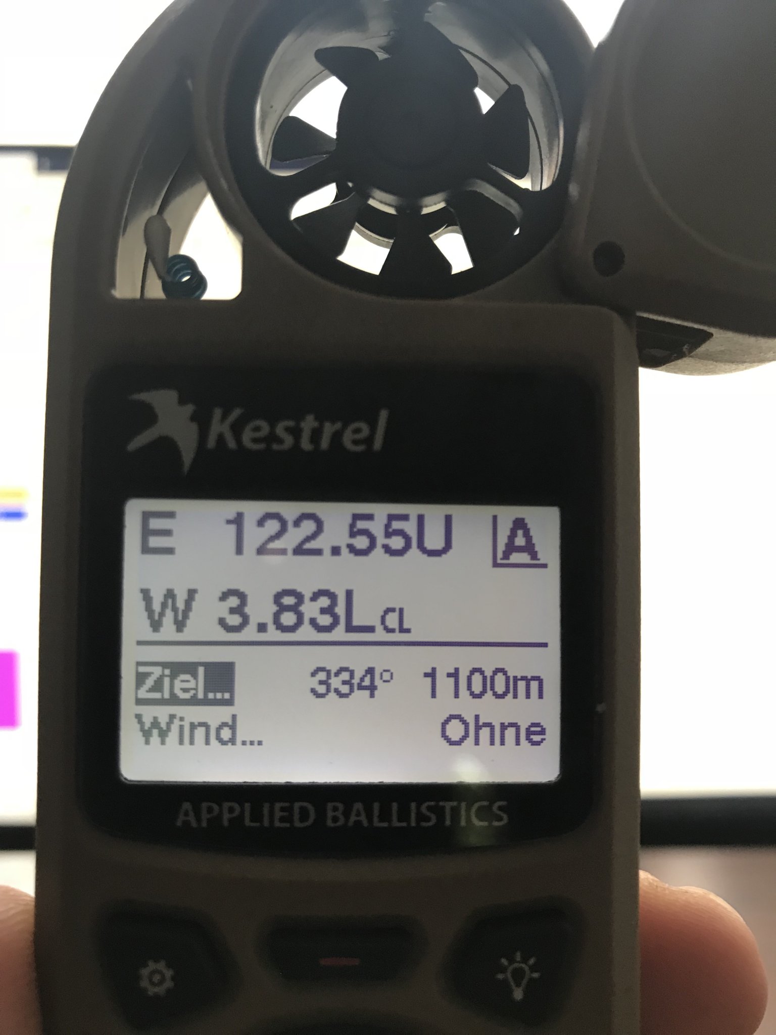

Hello guys,
can´t find it at Kestrel nor here.
On the main display, there sometimes (often) stands CL after the elevation or windage numbers.
What does that mean?
Sir, yes sir!

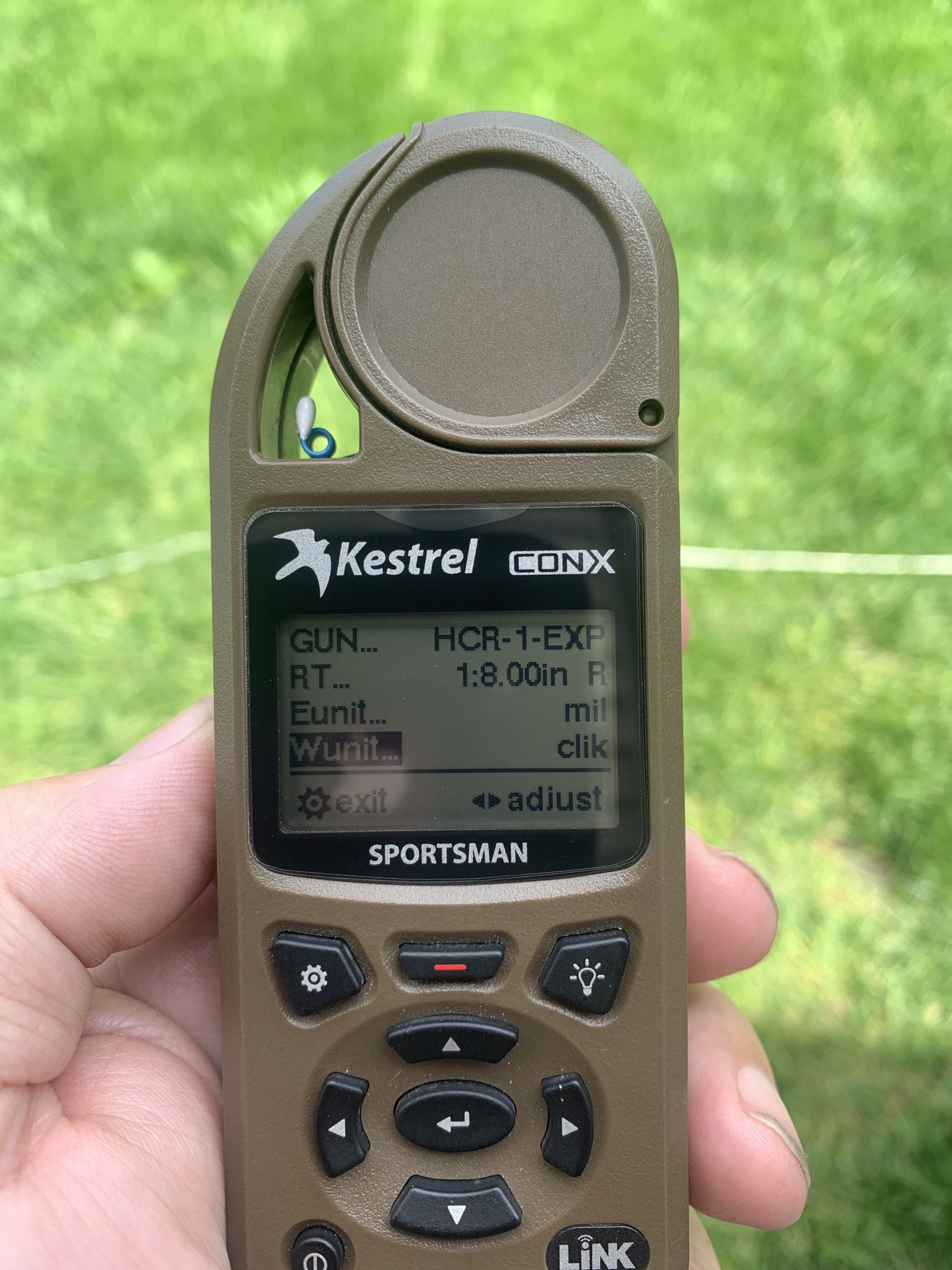

It’s because you are displaying your wind hold as “clicks”. You also don’t have your “Wind 1” zeroed out. Edit: just looked at your model I am not sure if that one has wind 1 and wind 2.
Reactions: Tokay444
Aaaaaaaaaah!
And one click is 0.1MIL.
But why is it sometimes behind the elevation and sometimes behind the windage?
Does your display show your unit too?
