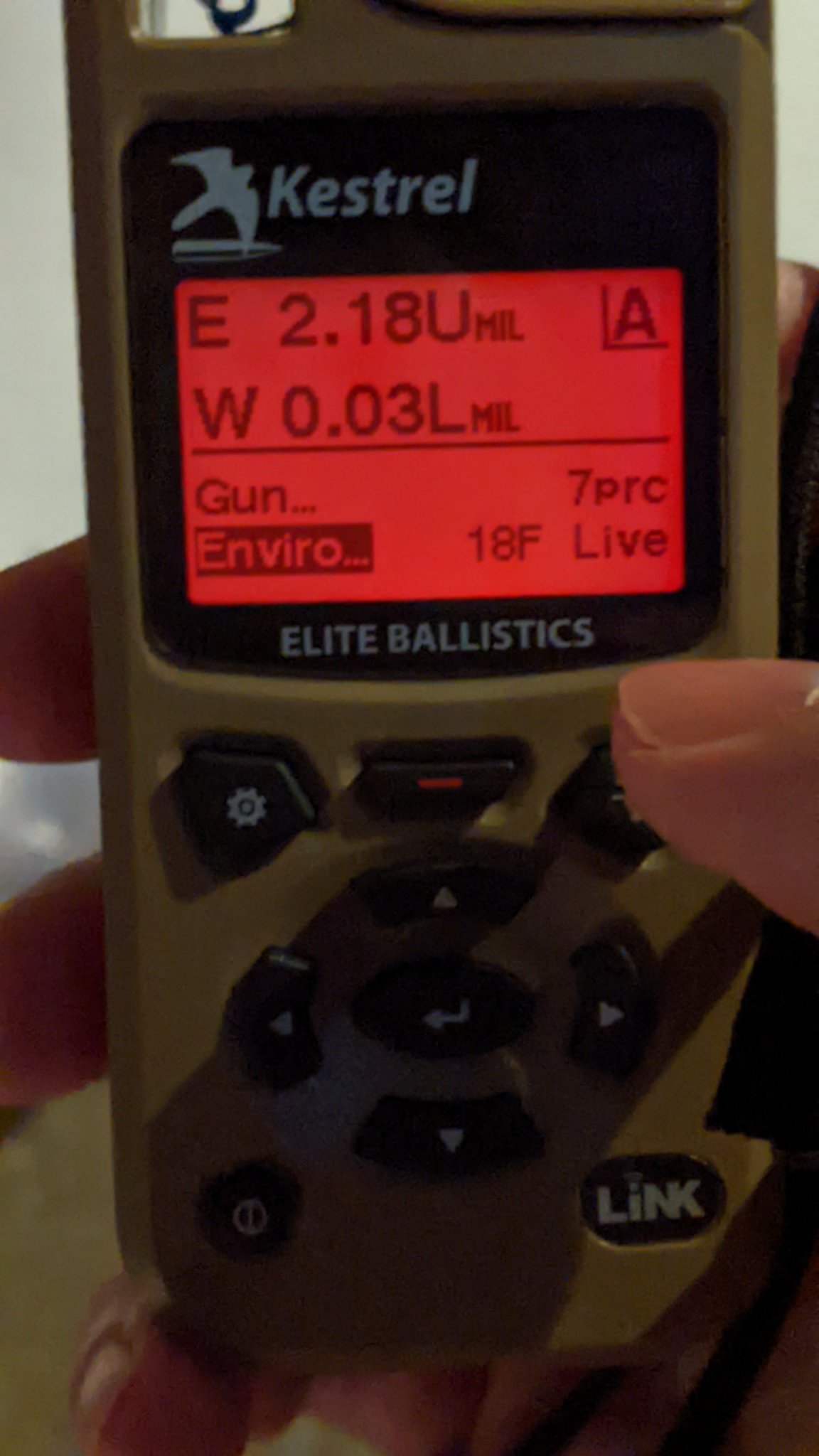

I just stepped outside with my kestrel and took a reading and it only showed 23° and wouldn’t go any lower. Local weather station says it is negative 2. Is there some kind of limit range on these kestrel elite ballistic models?

Didn't take more than 30 seconds to go from 68F down to 17-18F. If you're gonna leave it on the weather vane mount, it needs to be out of direct sunlight.
