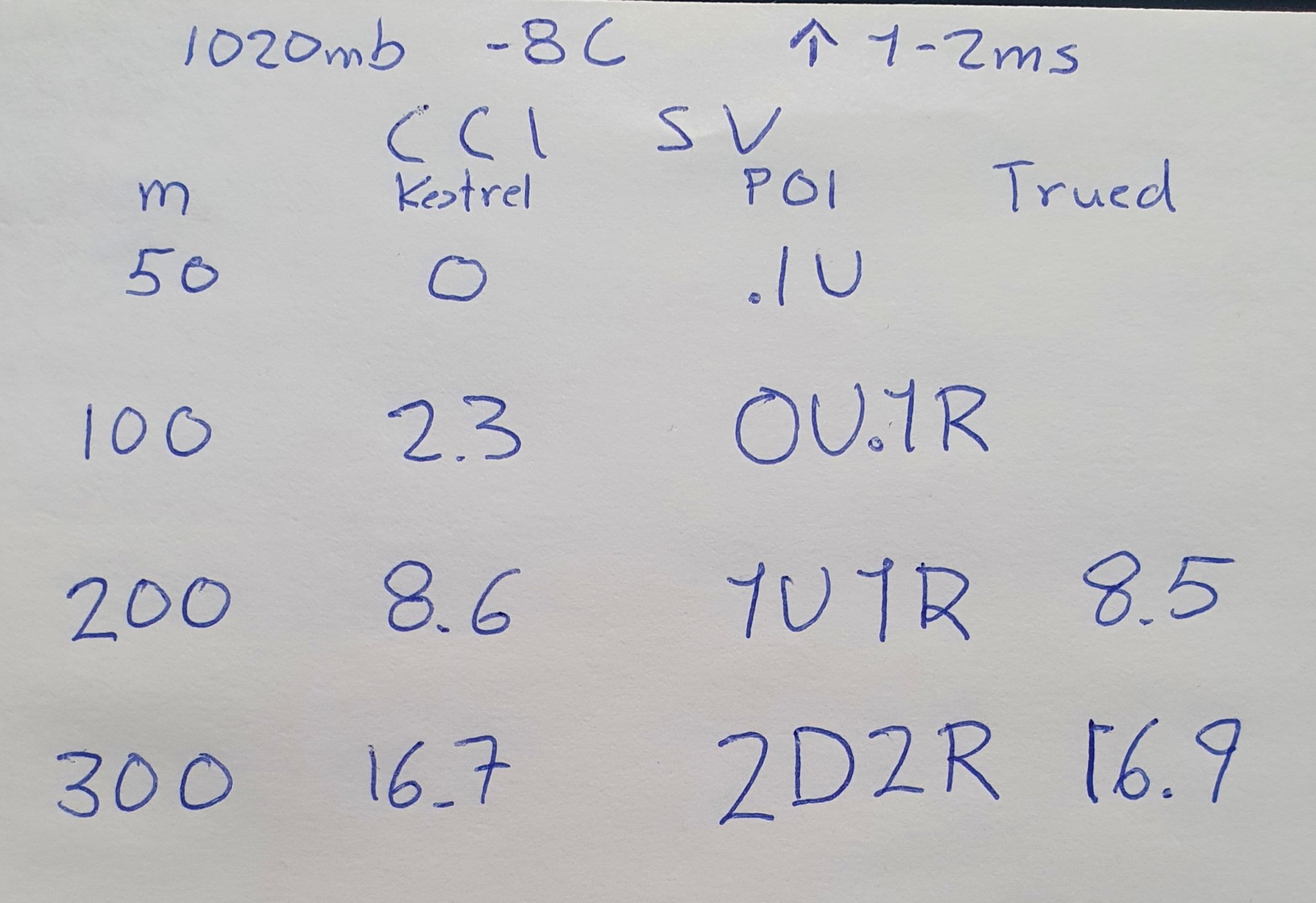

I build a temp table for each cartridge I shoot.
In my testing 0.64m/s per C° is very close for all around work. But for cartridges I really want to work well, I take accurate notes.
The key to working dope is shooting many different distances in each session and taking good notes.
I just confirmed dope for my 223 from 100 to 500m and the 300m was 2 clicks up, probably because the snow made some serious mirage. I tested 3 cartridges, all had same issue.
100m, 200m and 500m were spot on.
Doing dope with just kestrel is hard because it is designed to give output. Take a notebook and record every distance with the dialed elevation and then the spotted POI or groups measured distance to POA. Once you have done a single range day with say, 15 shots per target from 50 to 300, you can use that data to solve which BC and MV combination give the same dope (not counting anomalies, luckily bullets are known to travel in an arc after all).
Then from that data you can start working other temperatures. Know that ammo temp needs to reflect ambient temp and sometimes it can take some time for this.
I use this kind of note-keeping:
