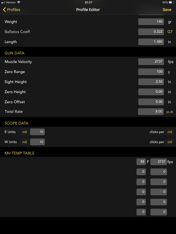

i've done a MV calibration and the dope is usually spot on, but i usually shoot at a nice 70 degrees. if i go up hunting in 25 or 30 degrees, will the calculator realize the MV will probably be less? i guess this is a tough question to phrase, would i have to redo a mv calibration at 25 degrees, would i then have to store it in the table or does it do it automatically? i am running a copper creek 6.5 saum 140 gr berger hybrid, use h1000. not sure how temp insensitive it is. i found something for h4350 saying about 2 fps for every 10 degrees. found a manual on line but it didn't go into the MV table https://kestrelmeters.com/pages/kest...s-basic-manual

Well here is the thing, it’s much easier to do it via the app. Not only that, the firmware updates through the app.
Right here on this his screen is how you do it
right, i've used that. it's easier to put in a new profile and i just did firmware upgrade a few weeks ago. so i guess i would have to put in a temp=velocity of around 30 degrees in order for it to include it in a firing solution. i was wondering if it automatically did it somehow. i think i will just put in 30 degrees=10 fps less
There is no way for it to calculate a change in MV based on 1 input. That stuff isn’t linear. The more data points you have the more accurate it will be. There is also an option where you can put in the change in MV per degree.

It averages the entries by calculating a change in FPS per degree, hence why he says use a min of 3 inputs. The reason DA isn’t the best to use is you can get a given DA, say 2300ft from a variety of atmospheric combos. But pressure and temp play roles on ballistics in different ways. Just making up numbers, these are not real, a da that is 2300ft with a pressure of say 27.92 and 65 degrees will have different trajectories than say 26.87 at 93 degrees. Even though both combos equal the same DA. Using DA is perfect for field ref cards, but if you have a calculator, you should use the core components that make DA and input them individually (pressure, temp RH).
