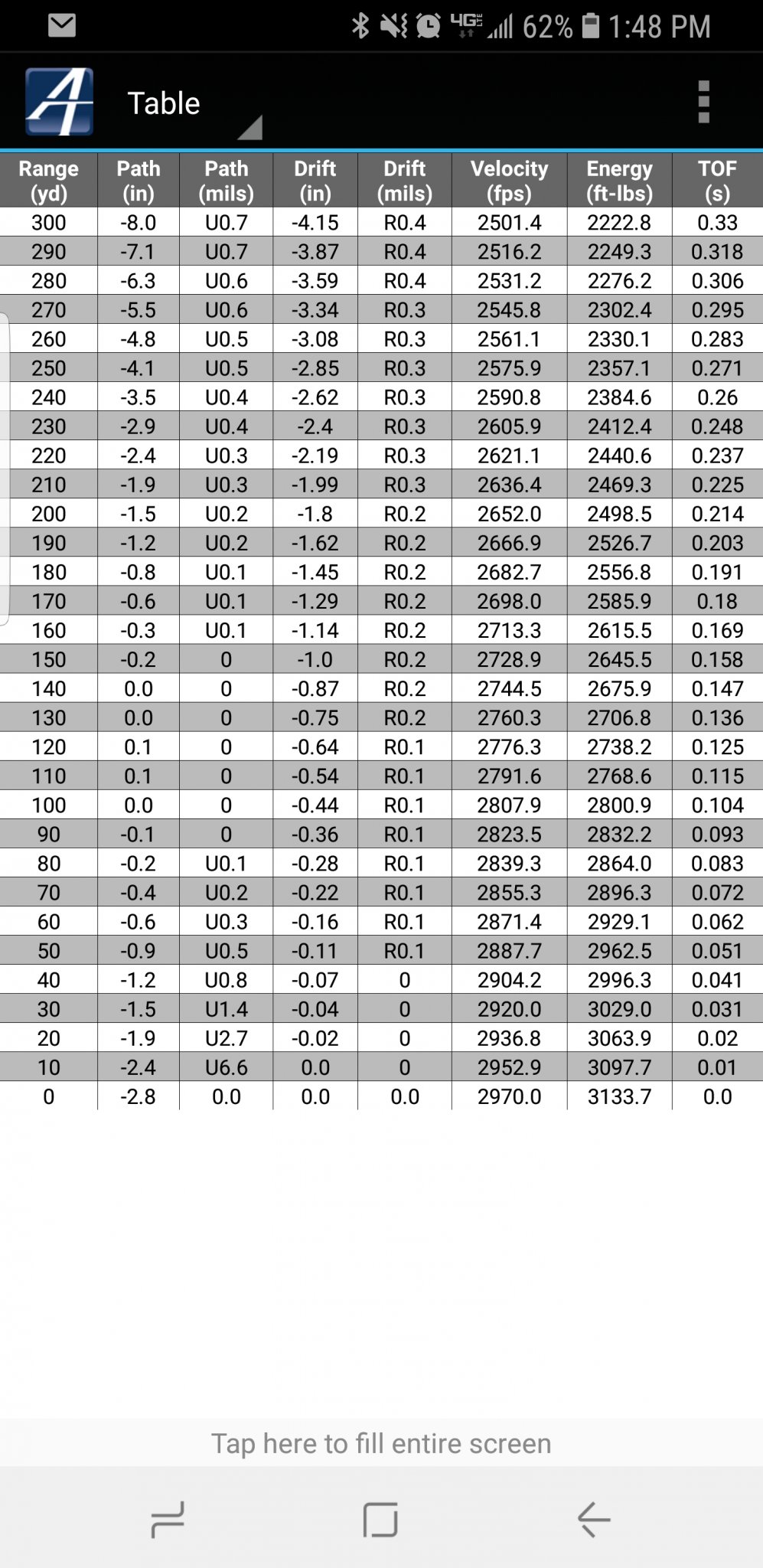

This is what I came up with.

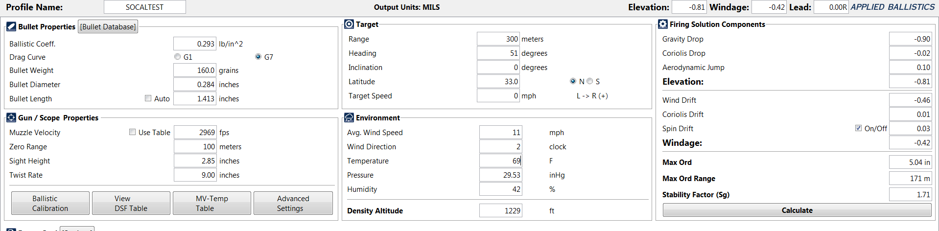

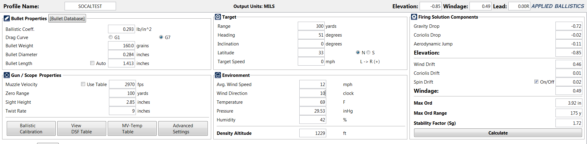

Here is the AB Analytics output with component breakdown (I had to guess what your station pressure was).

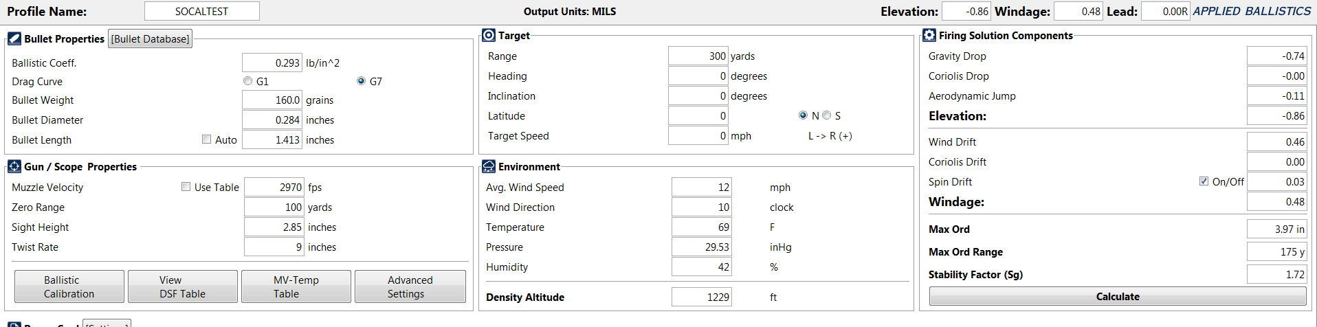

notice how AJ decreases your drop because we are dealing with a 3/4 value wind from the right which cause the bullet to hit high. here it is with the same wind from 10 oclock:

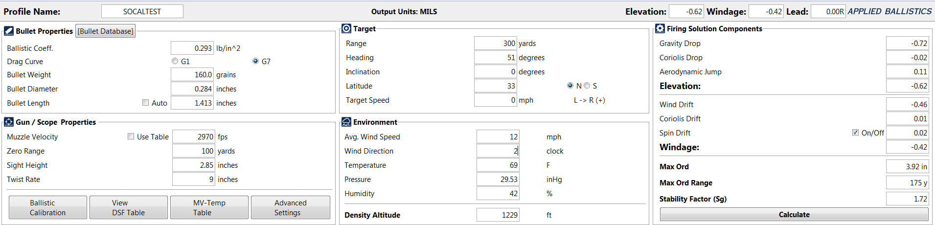

Now if we take out coriolis here is what you get:
ive said it a million times, you dont need spin drift or coriolis when using AB until you are dealing with transonic ranges. my recommendation.....turn it off. One of the key things you see is how AJ is added or subtracted to your elevation. i feel like JBM adds it no matter what, which would be incorrect.
