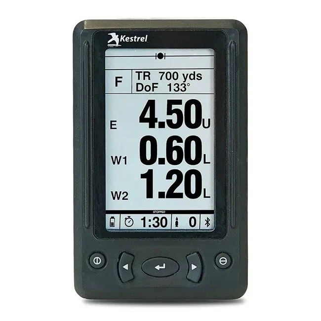

Just arrived in the building! KESTREL HUD

I played with mine a good bit in my back yard last night using my 5700 and Nitro 1800 LRF. So far, I really like it. Only issue I have had is connecting to the phone app, but I have had similar issues with my Kestrel and LRF, so I can only assume it's something with my phone not wanting to play nicely with others.
ya my phone does that every time there’s an update ...I just need to stop updating things...
Yeah, I haven't tried doing any of it since my phone got updated to Android 10, so I am sure it's either a bug or some new quirk in the exact chain of events needed to get stuff to connect that I haven't found yet. It's frustrating, but not anything I can blame Kestrel/NK for.

Whats the bullet symbol next to the timer? Does it have a microphone to count shots?
Last I heard, the shot counter didn't make it to the production release, but it's planned for a future FW update. I think it's working off an accelerometer, not a mic.

One thing I found was that if you wanted to say put on 4 different targets at the same screen at the same time that it will show up those and then a list of others. Say 5-10. I dont think you can cut the ones you dont use off.
I understand the rest are from the kestrel. But you can turn them off in the kestrel and they still show up on the hud. Called kestrel and they said there was nothing to do about it.
If you use the "Clear All Tgts" command at the bottom of the Target Card sub menu to clear out your target card, then only the targets you edit info for after that will appear in the HUD. There will still be a space for all 10 targets but you wont see solutions for targets from your previous stages.
I only recently discovered there's a LOT more functionality to the target card than I thought, including this. Hitting the center button when looking at the target card will open the menu, for those that didn't know. You can set target distances for each target from one screen, and set different wind directions and directions of fire from there. It's WAY less annoying than doing it all from the main screen, and definitely helps setting up the multi-target display on the HUD.
I was trying to check for updates for the HUD, I followed the instructions. But Kestrel Link app (android) doesn't see the HUD. I've tried with & without the 5700 on & off, paired with HUD & Phone. Any idea what I'm doing wrong?
HUD can't be paired to the Kestrel, and make sure you've got GPS on on your phone, and the HUD isn't set to locked on the Bluetooth screen.
Thanks Hollywood, I checked all that & still no luck. Probably just my phone, it's a POS that was picked up last year on a road trip when my other died.
Everything seems to be working well but just wanted to check for updates as mine was an early model from the pre-order group.

I doubt the either of the kestrel will support multiple simultaneous BT connections, and pretty sure the leica wont either. I believe those are BT3.0 features.
Maybe I'm misunderstanding you but my 5700 connects simultaneously to my Terrapin and HUD
The 5700 absolutely can connect two two devices at the same time. I've had my HUD and Nitro LRF both connected to my 5700 at the same time, and could laze the target and have the range and dope show up on the single target screen of the HUD.
That's awesome, glad to be wrong on this one.
Kestrel Link or Kestrel Ballistics app? Link is for weather, and has no awareness of the HUD, but the ballistics app does (if it is current). Bluetooth is bluetooth - if you can see your Kestrel, it's working, and phone age can't matter. *App* age, however, is critical!
No, by design. The 5700 has definite separate settings for binding a rangefinder and a HUD - it's designed specifically to do that. Using a 1 mile CONx and HUD here . . .
That's awesome, I wonder if the hud is just snooping on the outbound data to lrf.
Guys, if it's BTLE (which the 5700 is), it's basically BT 4.0, which handles multiple device connections. Now whether the software was encoded to take advantage of that is another matter entirely...
These 5700 elites have been around for a while, didn't think they could have BTLE, that would be great. There is far more capability than currently being demonstrated. If possible Leica will mess it up, haha, their control FW is shit.
