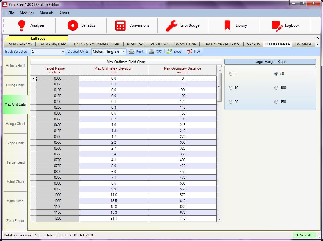

Kestrel max Ord distance???
AR15-SBR
Jun 10, 2014
143
94
I was playing around with my Kestrel 5700 Balistic and I found the max ord. But does there someplace that tells me at what distance the max ord occurs? Dummy me can’t seem to find it.
Patagonia is the only package I'm aware of that features a fully fledged Max Ord chart
LastShot300, I would be nice if Kestrel would put the s
distance next to the height. Something like 3.7(mils)@653(yards) would be fine for me.
pretty limited real estate on the kestrel. Plenty of calculators will give you that information. If you need it for some kind of analysis the kestrel is the wrong tool.
Reactions: LastShot300
For sure the max ord distance would be nice to have on the device.
There are for sure instances for this.
I have aimed through power lines and had to look it up. I assumed the max ord is at around 2/3 of the distance to target. Same problems come from tree tops and branches.
Reactions: AR15-SBR and 6.5SH
