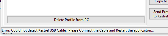

Have you used it with the BT dongle? AP website says must use USB cable with 5 series Kestrel
I have not but I’ll try it for you here in a bit and report back.
They sell a specific Bluetooth dongle just for the K5 and Link. I don’t see why it wouldn’t work.
Yes I know, and its less than half the price of the USB Cable which is why I asked. But just reading what Kestrel website says with using AP Profiler and K5 series Kestrels. Says only USB Cable. IDK
Reactions: TACC
I may be incorrect here but I think the Profile Loader possibly predates the Kestrel Ballistics App?
It is indeed odd that the 4500 is BT compatible but the 5700 series is not.
I went with the cable thinking direct connect better assures a non-corrupt communication and I can load from older equipment.
Didnt realize the cable comms was going to be optical but its a solid link and loaded info fast.
