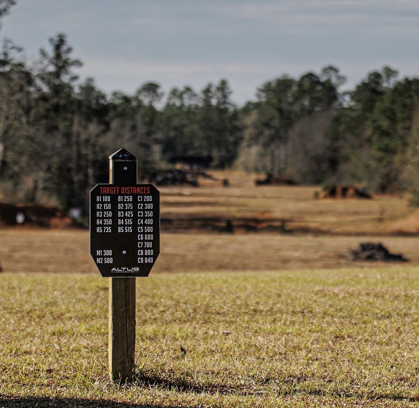

The c8 at Altus is pretty close to 806. c9 is more like 838.

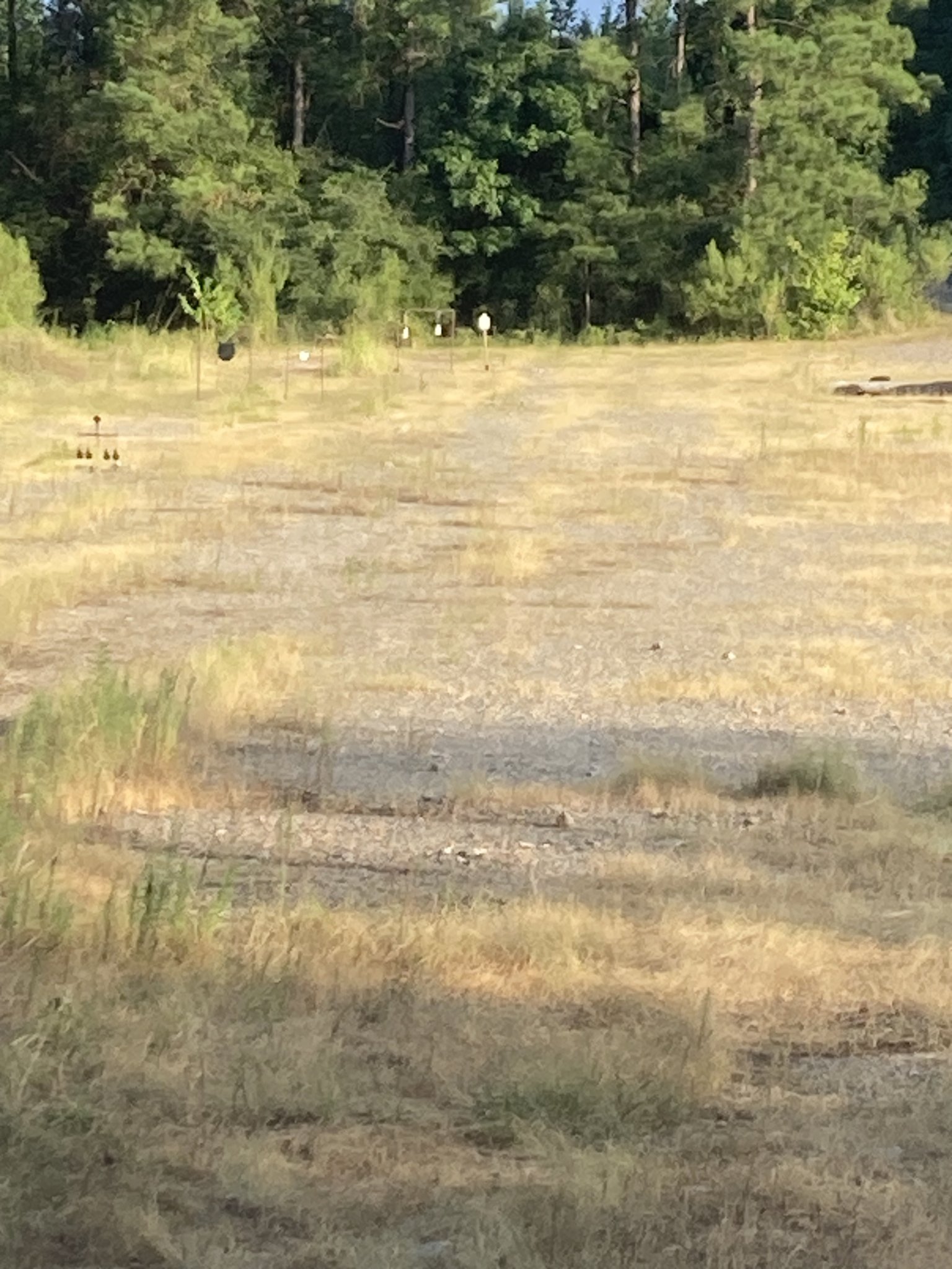

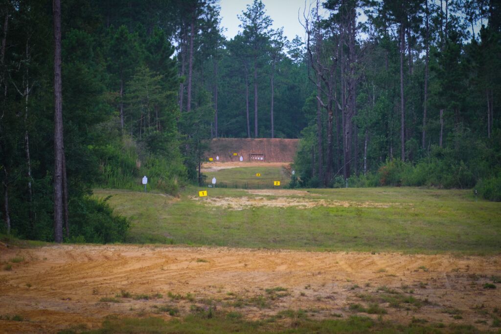

3. I moved to the ABC range at Altus. The C range has targets from 200 yards out to 840 yards and all are backed by plain dirt backdrops and thus it is easy to spot missies.
I decided to use the old fashioned way of sighting it in out to 800 yards. I used the Kestrel data for the Tiger Rifle and adjusted accordingly. Be it scope difference (both MK5HD’s in 5x25 with PR2 MIL reticles) or sight in differences (sighting in a Top Shot at Hodge does some very funny things to rifles) or barrel differences, the data does not agree, thus requiring the creation of a second gun in the Kestrel. The chamber throat on the Gray rifle is markedly different from the Tiger Rifle having a much tighter throat.
So, it took very little time. There was a strong crosswind component which was the most difficult issue of the day. But reading wind, is my specialty.

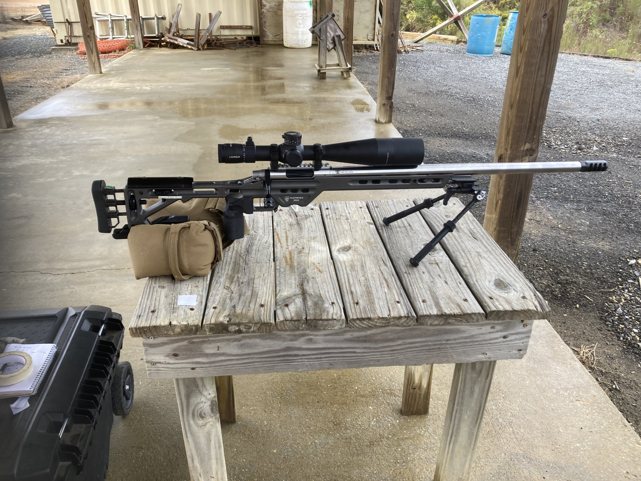

Rifle had been regulated to practice status. Tiger Rifle has demonstrated better grouping. However, the Tiger’s barrel is getting a bit long in the tooth.
Old style MPA BA chassis. Trigger Tech Special trigger, MPA/Curtis action, Leupold MK5HD, in Leupold rings. Atlas bipod, and using a Game Changer waxed bag, reduced fill. Rifle weight 18.0 pounds.
Main difference, the Tiger has an ESR chassis, a Trigger Tech Diamond trigger and using an Area 419 ARCA mount for the Atlas Bipod.
Final note, the picture is using a different bag, the picture was taken last summer on the day that barrel was first shot

FWIW, I'm going with the target was really at 775. JBM using your real velocity and BC matches up with what you saw.

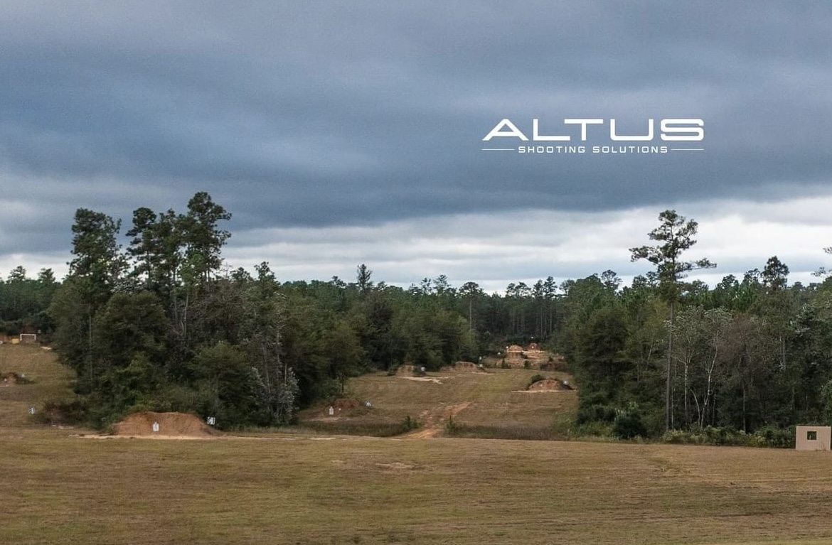

Assumption, but he said he went to the “abc” range and of those the c range is the only one with 100 berms going out to 800. 👍🏼
You have assumed correctly. The “C” range has markings for every target, AND by each shooting area on the ABC range, there is a sign giving the ranges to each target with the corresponding signs by each target.
I could not find a good picture of C range but each target is marked and on the range by each target berm is a large sign listing the target which corresponds to the sign.
C1 - 200
C2 - 300
C4 - 400
C5 - 500
C7 - 700
C8 - 800
C9 - 900
AND I was shooting at the “C” range. (But often for fun take on A and B ranges. C is pretty much a long range dope check range.
Below is my fun range. Shooting off a fence post, it also goes to 800. Closest target in the picture is 300.
This is an older picture. It is no longer marked, making it an unknown distance range,, but I got it memorized. Heck, I could eat this with a spoon :D
