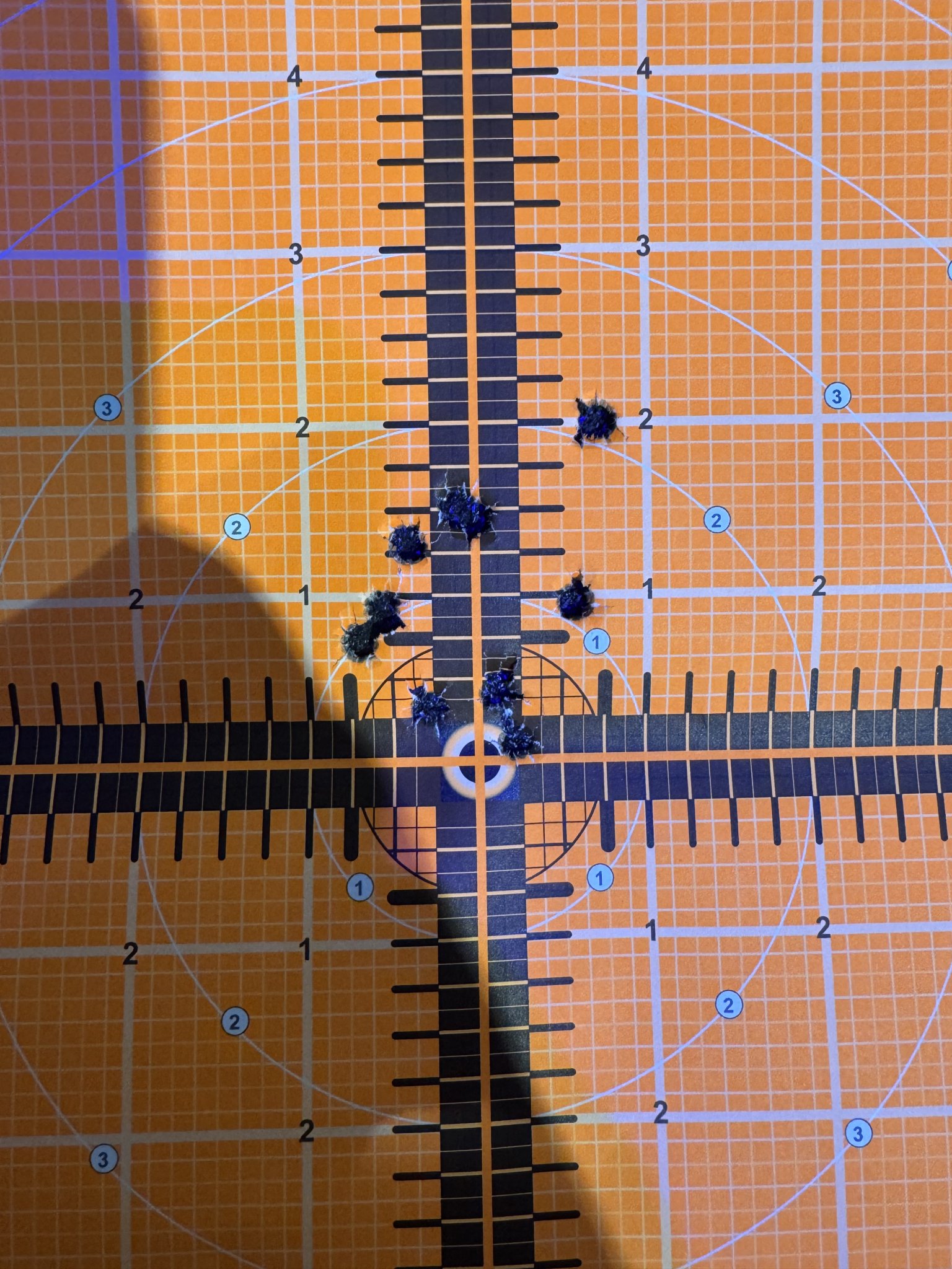

I got my Ruger American 6mm creed cut to 16.5 and it’s now keyholing at 50 yards and all over the damn place at 100 yards if it his paper. With the suppressor, no suppressor, hornady black and precision hunter all had issues. It’s in a mdt chassis. Could the chassis cause it, maybe I didn’t tighten down the bolts enough? bad cut and thread job? I believe the Americans are 1 7:5 twist

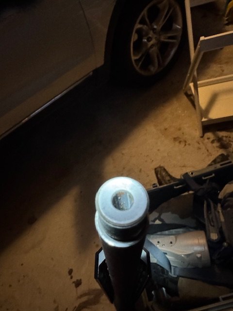

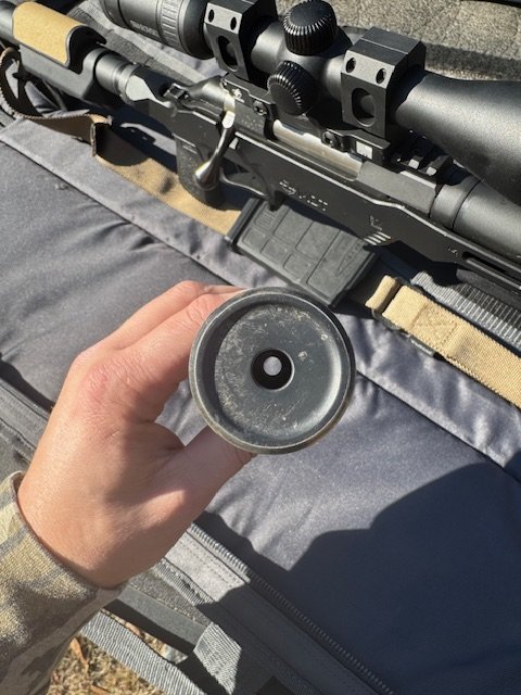

Are those pics of just the supressor or the actual crown?

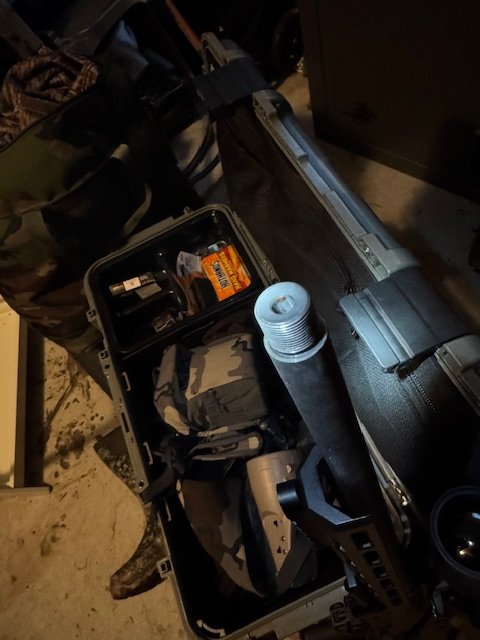

OP what's is the ending barrel ø vs the threading spec? If you are 5/8-24 do you have min 18mm/0.72 inches of barrel?
There's tons of ways to mess this up, eg bad crown, not enough meat on the barrel for the threaded mount/ shoulder, simply removing too much mass as % of the total, etc which by itself may open up some bores if they aren't cut rifled.
ETA google says .60 barrel diameter? Guessing this is probably slightly thicker at 16.5 in mark, but unlikely to be 0.72.

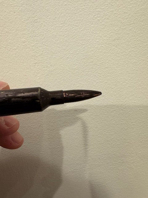

Tbac ultra 7. I shot it suppressed first and saw it key holing then took it off and it still was doing it. Anyways I’m gonna talk the the smith and when I get home.
Built this gun for fun but may just part it out and build a for real custom for my son.

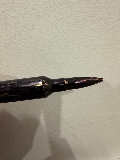

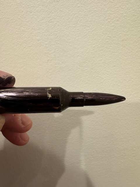

Likely found the culprit? Some build up of copper or maybe rust? For less than 3-4 boxes seems like a bunch of gunk down there.
Dang! What did you do with that rifle since the last session?
It looks like you did an infil with SEALS and didn't rinse the seawater out of the bore!
Can't zoom too much detail in your pics but whatever corrosion or bloom you have inside the bore looks like it grew there since the last shooting session. The bumps/nodules wouldn't be there after a fresh shot went down the bore. It might grow back if something caustic is pitted into the bore surface but even one round will take that out.
New challenge for you.... Take your rifle out one more time. Shoot just 1 or 2 rounds and take another pic of that portion of bore again. I'm betting it looks totally different. Then clean it with something that will neutralize any salts and corrosives.
Yes, your bore looks like hell and shouldn't. You probably have some surface damage to the bore. BUT, I'm still thinking that isn't causing your keyhole symptom. Lots of old mil rifles and poorly kept hunting rifles with incredibly pitted bores and shot out throats still do not key hole. They may foul and shoot like shit but will not keyhole due to that type of bore damage.
This may be like Hootsey Owl and how many licks for a Tootsie-Pop. Even if you resolve it, the world may never know.

It was that bit off rust or copper or whatever at the end of the barrel.
Walked it down to those last 3 with hornady black. Probably could get it tighter with a better rest like my original shots but it’s close enough for deer and hogs.
