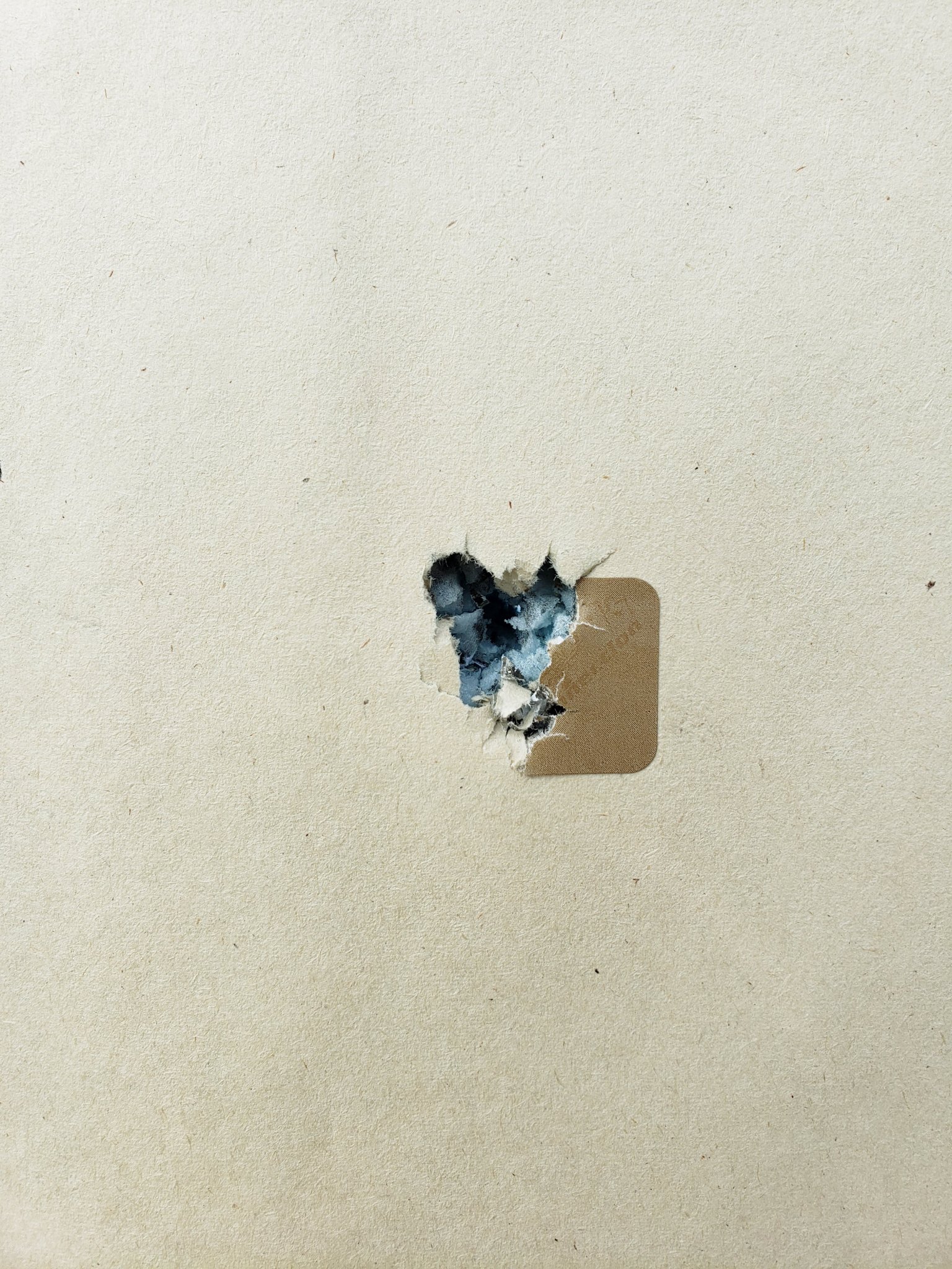

I run keymo on all my accuracy International barrels..... No poi or group issues
